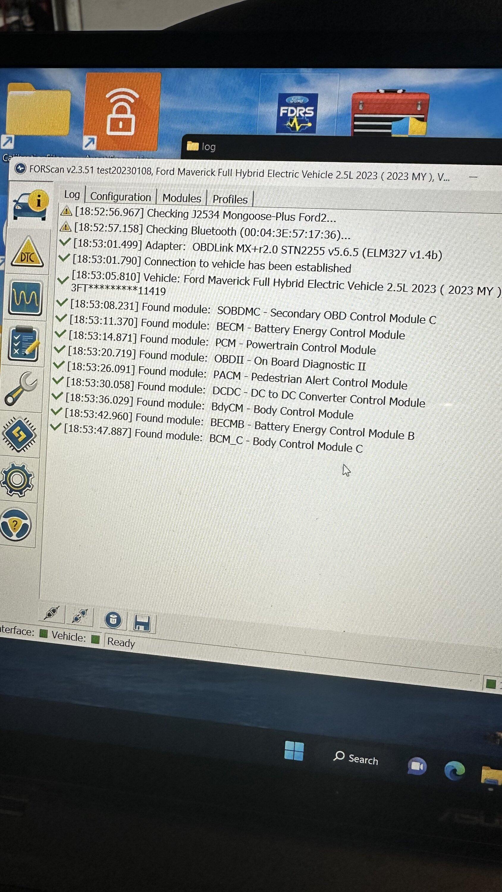

There is one from the 8th. Change the end of the link to 108.exe Worth a try.
Thank you guys forscan team response below:
Thanks for the debug information. There is a problem in FORScan database. We will fix and send you the new build as soon as we can.

I installed this and it recognizes the vehicle now, but I'm not able to edit any of the modules or save backups. Not showing up in the tabs...
Contact forscan and send them your vin and logs. They are super helpful!
What happens when you hit the "Play" button at the bottom?

Didn't try so as not to mess anything up
That's how you edit. Did you select one of the other modules to try and backup?
Oh haha I thought once it was highlighted the tab showed up at the top...thought the play button wrote to the ecu.
