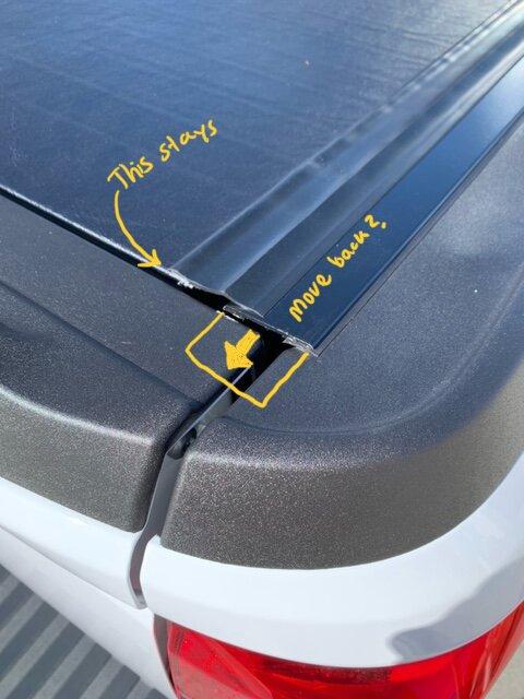

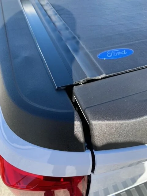

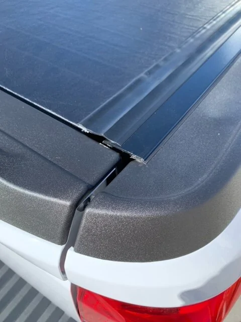

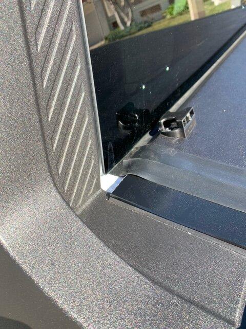

Mine is leaking a lot. The rear seal does not touch the tailgate at all. Can you check the corners by the bed and see if yours are like my photo. I have seen others where no body color is shown.
The dealer installed my cover instead of risking the factory delaying or canceling my order. I posted on the forum pictures of what I think is an incorrect job. I’m 30 miles one way from the dealer so not economical to drive there for them to correct it. I’m sure it leak’s all covers leak.

Those of you guys with leaking on the factory roll-up cover (which is the same as the BAK X4/X4S model), you should check this video out to see if you can do this simple adjustment to make sure the tailgate gap is mitigated.

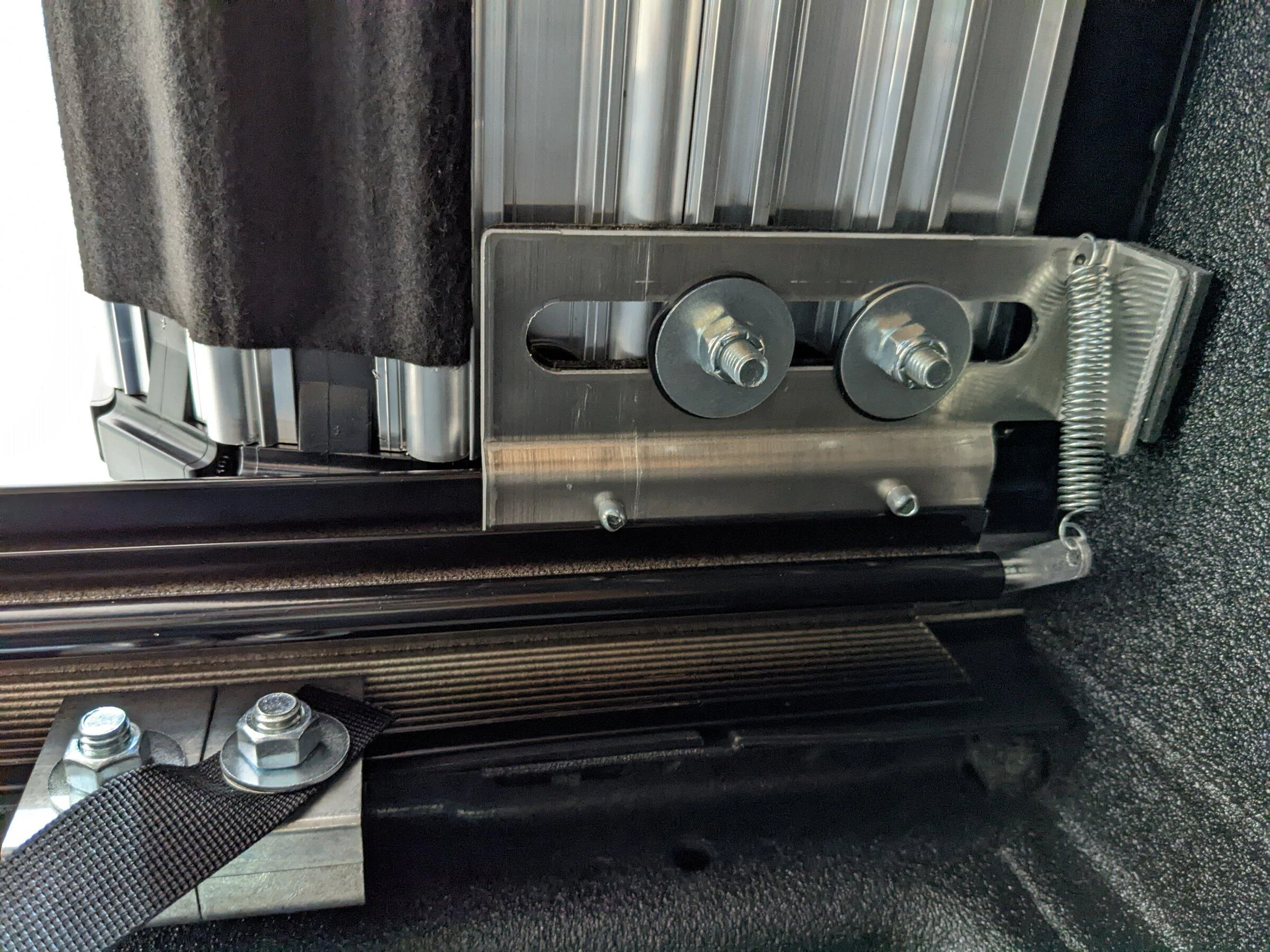

I have the same bed cover. It is not completely water tight. It isn't bad... But you will get some water. In hind sight I don't think I want it sealed so tight that heat can't escape... Especially in Texas. At the front of the bed near the cab are a pair of bolts on each side. You can loosen the nuts and adjust the cover back and forth. I adjusted mine as tight to the tailgate as it would let me. I still get water from a hard rain or carwash.
EXCELLENT. I've been too lazy to see how it was adjusted/installed. Mine looks like it was installed by the same person...slightly cockeyed and leaves a slight gap at the tailgate that invites water on the drive-thru carwash. My wife was NOT happy that I insisted her suitcase would be just fine...🤐
