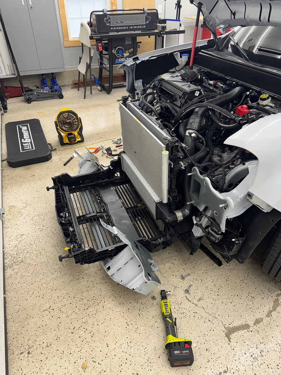

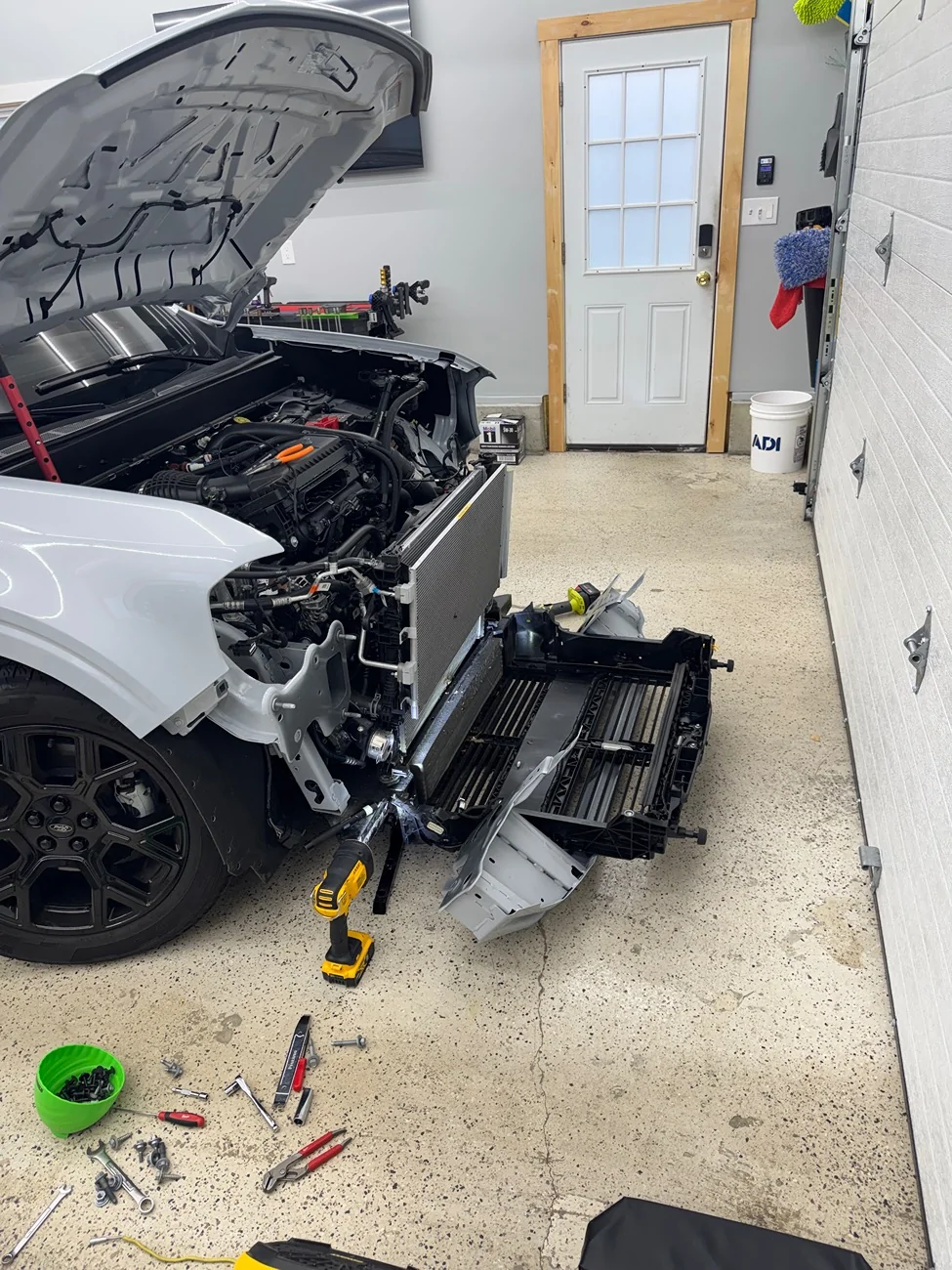

So I just finished installing. Did not have to remove radiator and condensor. I basically tilted the bumper support and shroud together to the floor, after unlatching the 2 radiator clips. I did the job alone, highly recommend another set of hands, it was a bit$h to get it all back together and lined up. Hardest part was getting the radiator rubber bushings back into the bottom of the shroud housing. Doing it alone took me about 2.5hrs. Thanks for all the input.
