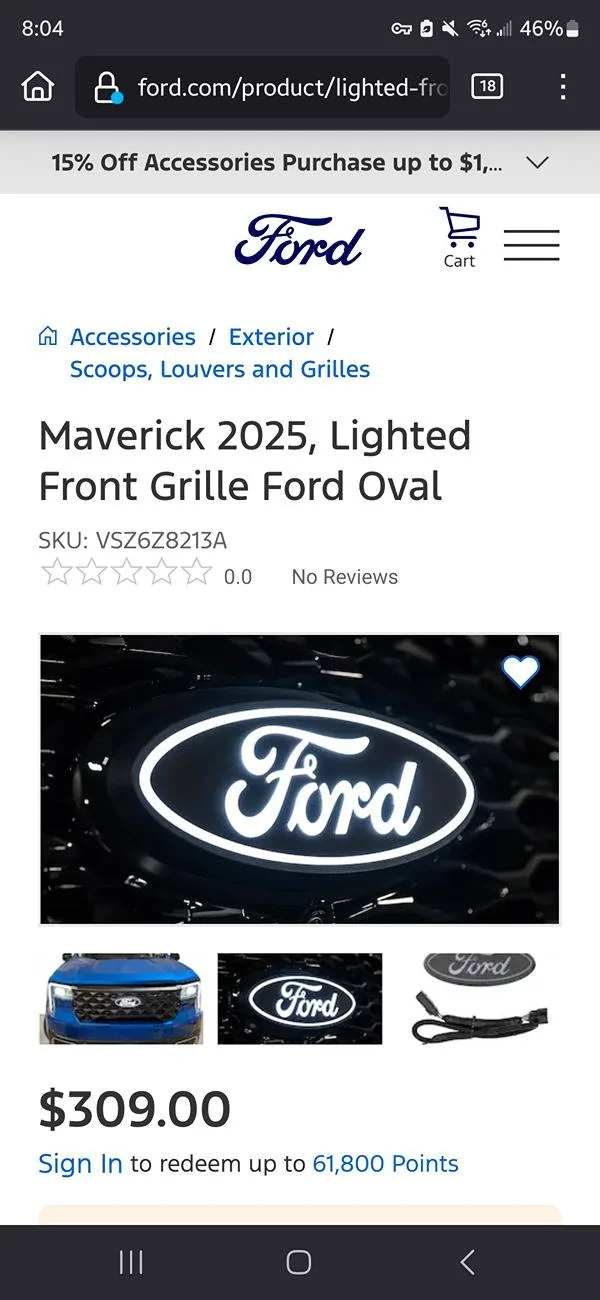

I don’t but I was thinking of getting one myself for my 2025 tremor

Not impressive at all imo and at $309 would sure be a hard no

The price is a big no, but it would be a cool touch to add to a Mav.

Beginning to think I’m going to order one. Was just wondering about installation. Seems expensive to install when it says plug-in play. Wondering if I could do it myself or if there is some trick to remove the old emblem. I need to investigate at further.

You'll need to remove the grill bar with the attached emblem, not hard to do takes just under 15 minutes with some different size sockets.
Then you'll have to drill some holes to run the wiring through the grill bar and the grill and then decide whether you're going to run it off the battery with a switch for power and powering on, or tap into something like the running lights are parking lights for power and run a add a fuse for safety.
I don't have one but I removed the grill bar and emblem for painting.
