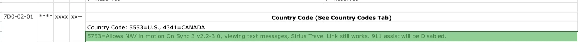

Are you sure changing nav in motion to enable using these instructions below will not work? You said you tried this correct?
7D0-02-01
5753-xxxx-xxxx
Stock it should be 5553.
Also it looks like if you use voice commands or steering wheel buttons, the lock out will not happen on the USB drive
7D0-02-01
5753-xxxx-xxxx
yes 5753 I seem to remeber 7D0-03 something but I would have to go look to be sure.
voice command seem very limited. I'm not sure about using the wheel buttons. I'll try messing with that.
