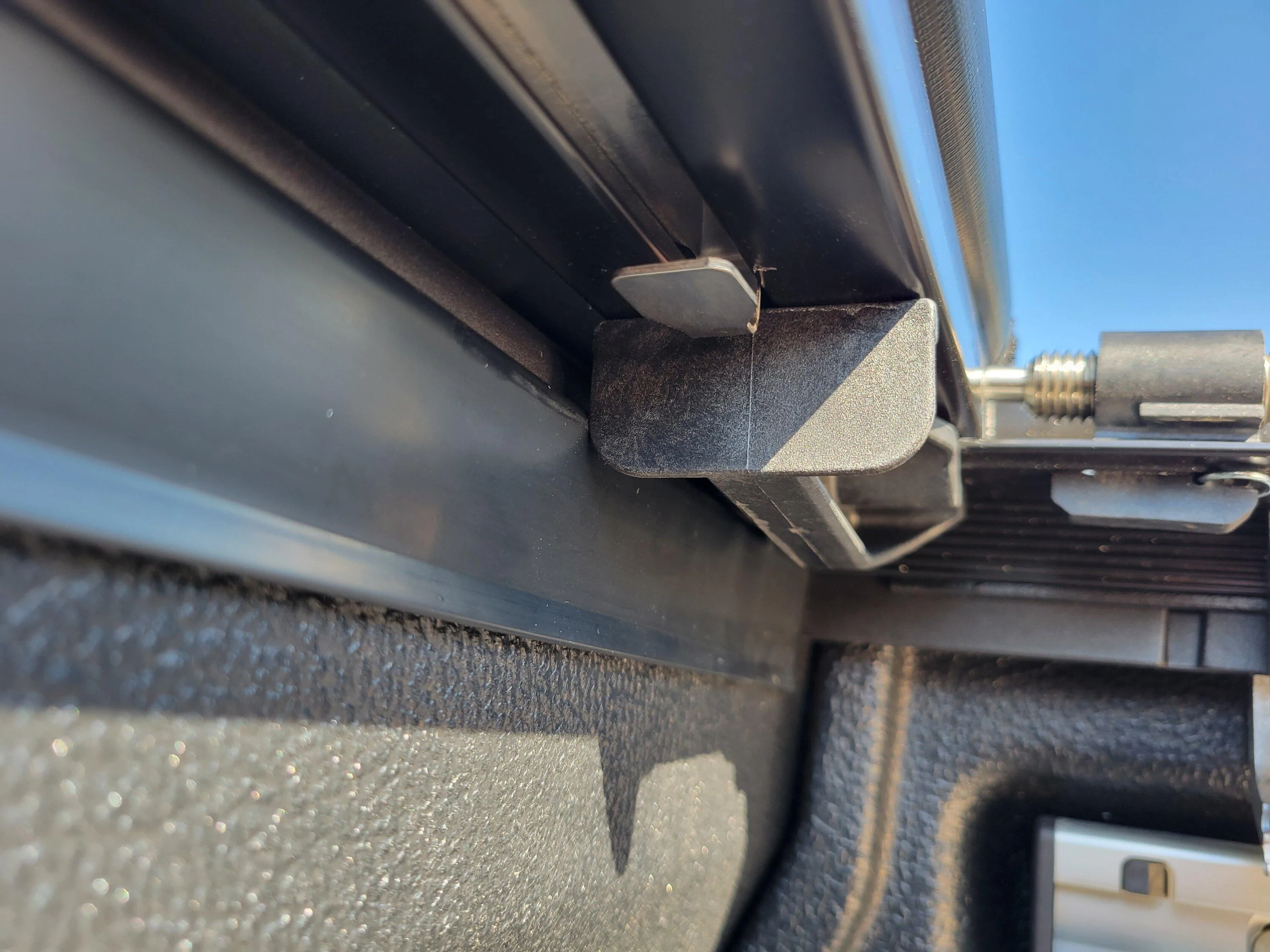

The troubleshooting guide says this is due normally to a cover that's too loose. I believe there is some weird interference between the front of the DIBL edge trim and where the cover attaches to the side rails along the bulkhead. The tensioning plungers push this cross member against the plastic edge trim of the DIBL. Not sure if this isn't allowing to to reach full tension or not. Anyone else have a similar issue?

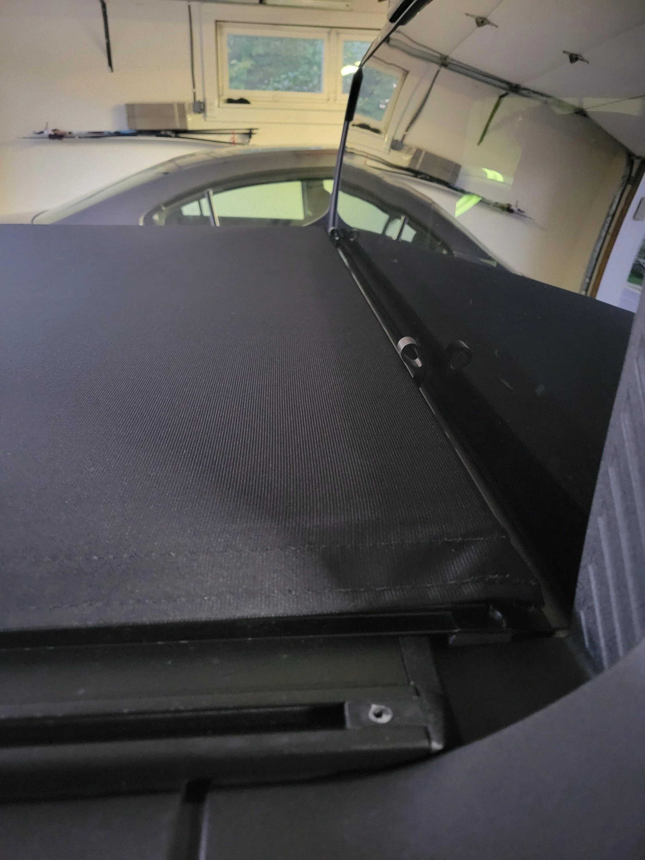

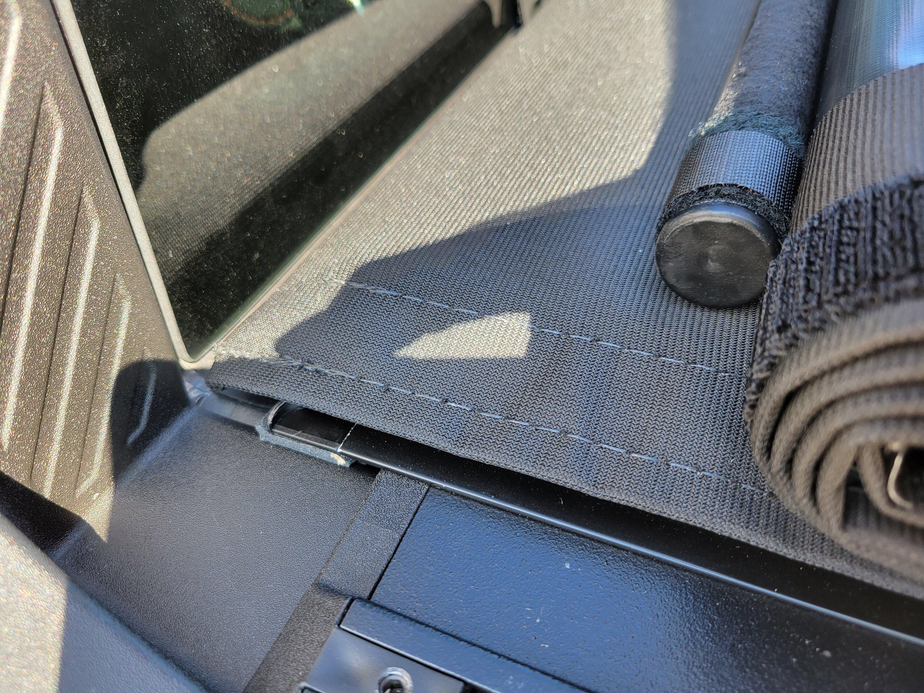

The latch seems to be pressing up against the DIBL's edge trim. I can't tell if this is preventing it from becoming fully tensioned. I am also using the elevate rails.

I learned that the piece of edge trim that the front cross-bar clip interferes with is glued onto the DIBL and can't be removed. The alternative would be modifying the plastic clip with a die grinder to generate clearance (something I'm willing to try).

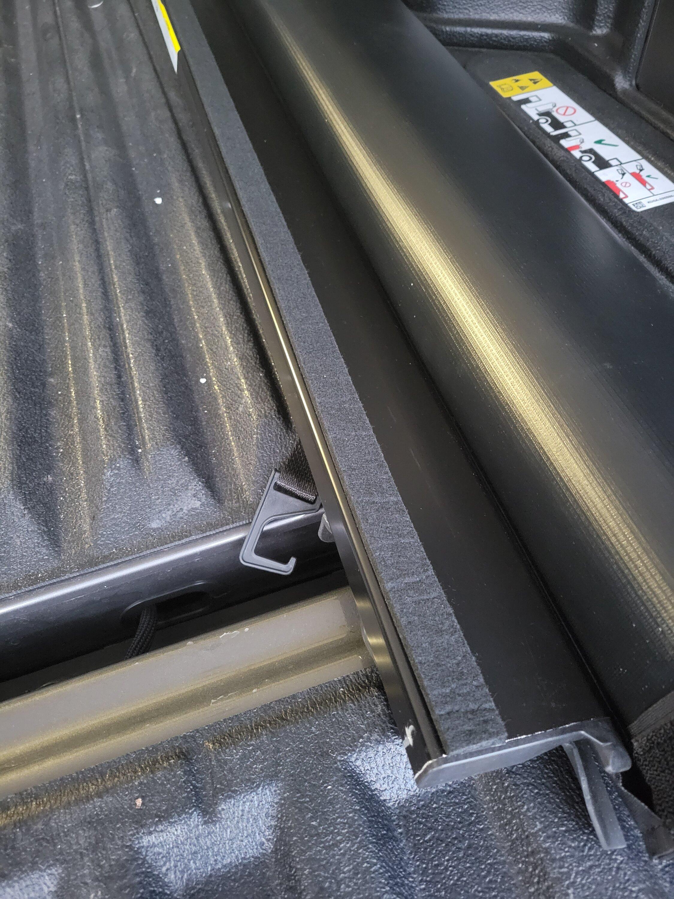

I did add some felt last night. 1" wide and the full length of the front cross-bar. Fairly thick. The intent is for the felt to keep the cover front touching the crossbar flush and flapping against it. I think this front bar is what generates the most noise. I didn't have a chance to go 70mph this morning on my way to work, but so far at lower speeds, I haven't heard it.

The felt helped substantially. I could still hear the occasional flutter slap, but it wasn't persistent.
