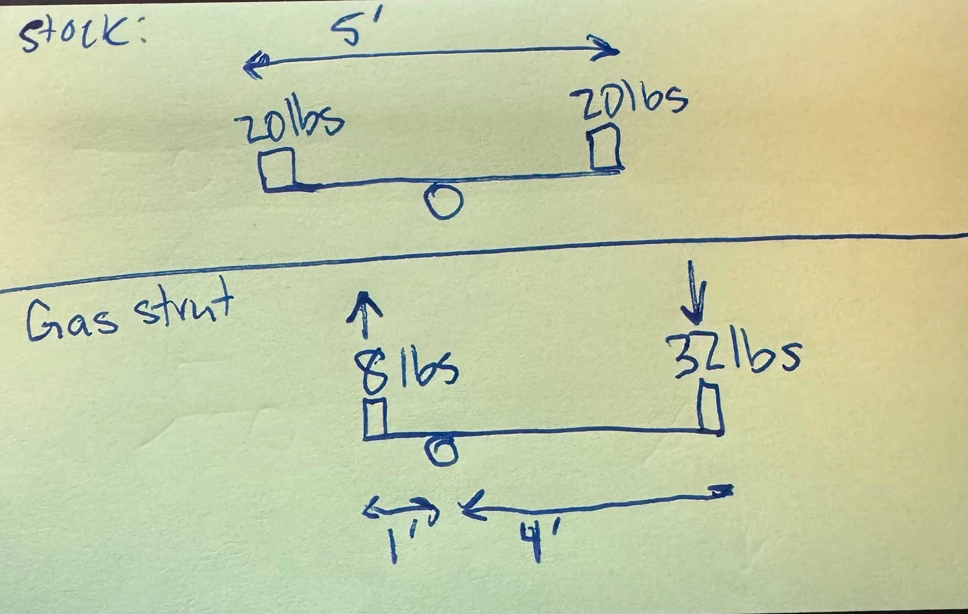

Does your gas strut mount to the front of the hood where the stock prop rod mounts? If so there should be no problem with the stock hinges.
If it mounts to the back, say a foot from the hinge, it is likely going to damage the hinges and/or the hood. Here’s why: Think of your 5’ x 5’ hood being a 40 lb teeter totter, or a lever arm, that is balanced in the center, the fulcrum, 2.5 feet from the ends. 20 lbs goes on the prop rod, 15 lbs goes on one hinge and 5 lbs goes on the other hinge. Why are the hinges loaded asymmetrically? Because the prop rod attaches at the side, not at the center. It would need to be mounted on the centerline in order for the hinges to have equal loading. If you have 2 gas struts, the loads will be equal.
Now if you have a gas strut that mounts one foot from the hinge, it is like having a teeter-totter with the teeter part measuring 1 foot long and the totter part measuring 4 feet long.
So the totter is going to be able to lift 4x as much because of the mechanical advantage. Since the fulcrum has been moved to 1 ft from the end of the hood and the hood weighs 8 lbs per foot (8x5=40), the teeter part is now 8 lbs and the totter part is 32 lbs, the totter part will be able to lift 128 lbs because of the lever arm mechanical advantage and the net force will be 120 pounds of lifting force applied to the teeter, which is the hinge. And also because of the mechanical advantage, the load on the mounting point at the lifting end of the gas strut, the fulcrum in the lever arm example, is going to be 128 lbs. (Yes the hood still only weighs 40 lbs total, but it is a torque load. 32 lbs applied to a 4 foot lever arm is 128 lb/ft or torque.)
These loads are significantly higher than what the stock hinges and sheet metal are designed to handle, which will significantly increase the probability of failure.
All of these many kits have the pivot point right at point that the hood is bolted to the hinges, so yes the full weight of the hood is unsupported and hanging out there.
When I have time I will take and post a video of the issue.
