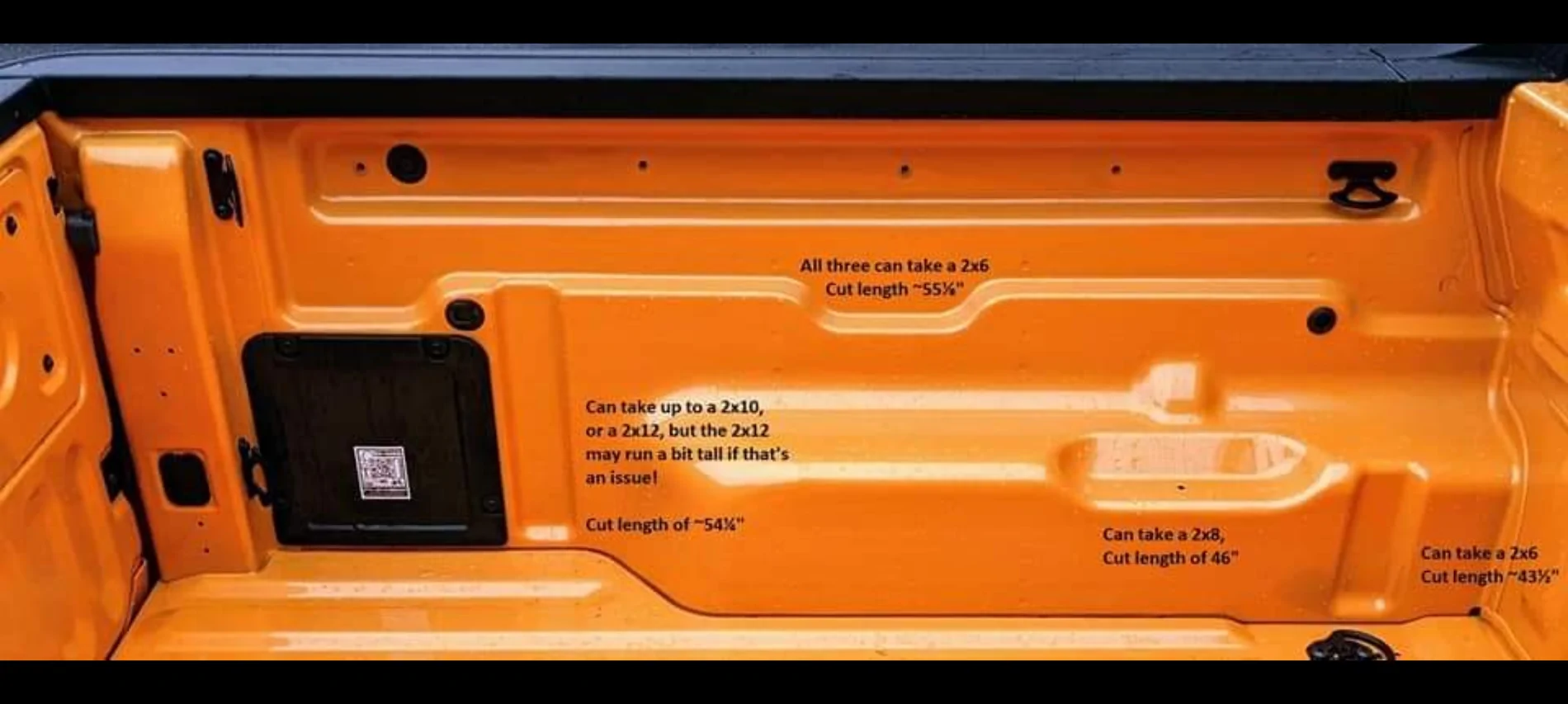

I'm curious what is the distance from the inside of the closed tail gate to the trailing edge of the 2X6 slot in the back. As is how large of a box/object will fit between the tailgate and the 2x6 board.
Looks like about 14" but I would love to know an exact measurement.
Trying to satisfy curiosity before mine (hopefully) shows up.
You've got fifteen inches there. Plenty of room for plastic milk crate, propane tank toolboxes

Hello, does anyone know the exact measurments of the wood pieces needed to create divisions in the truck's bed?
I'd like to buy in advance of receiving my truck something more durable than wood like the following, also recommended in another thread:
https://www.markstaar.com/2-x-4-x-8-Recycled-Plastic-Lumber-2496.html
That is much heavier than pine 2x4. Weight adds up plus it will be harder to put in and take out of truck. Stop by big box store and check it out.
