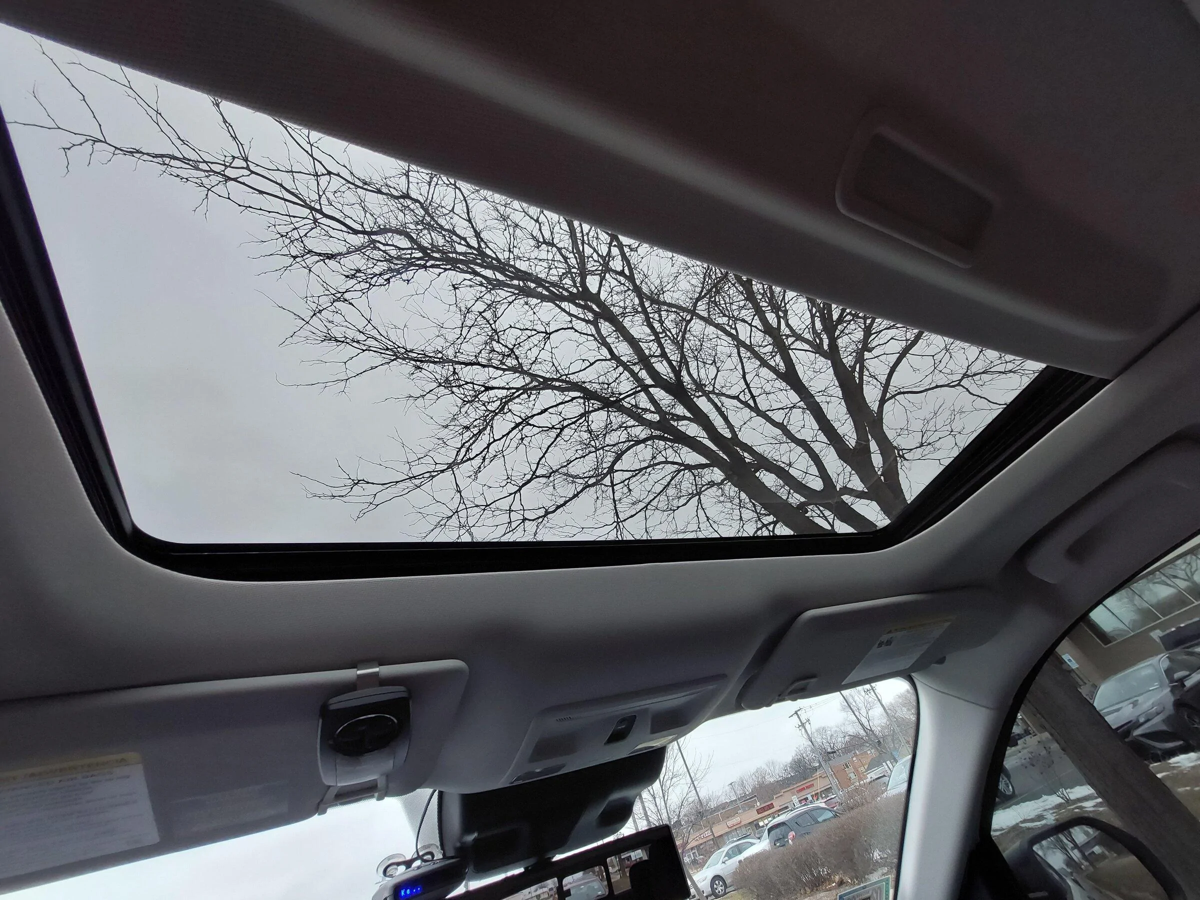

I have a 23 Lariat with Luxury package and I have no overhead sunglass holder. Can you clarify what year and model you own, please?
Azmig88
Ted
Feb 25, 2023
605
527
2022 Ford Maverick 2.0 Lariat
You probably have a sunroof.
Sunroof—No glasses holder
Okcorrell
Aaron
Oct 19, 2022
Ahhh, yes, you are right! Thanks!
I am missing the sunglass holder, but not enough to give up the sunroof. Thanks again!
