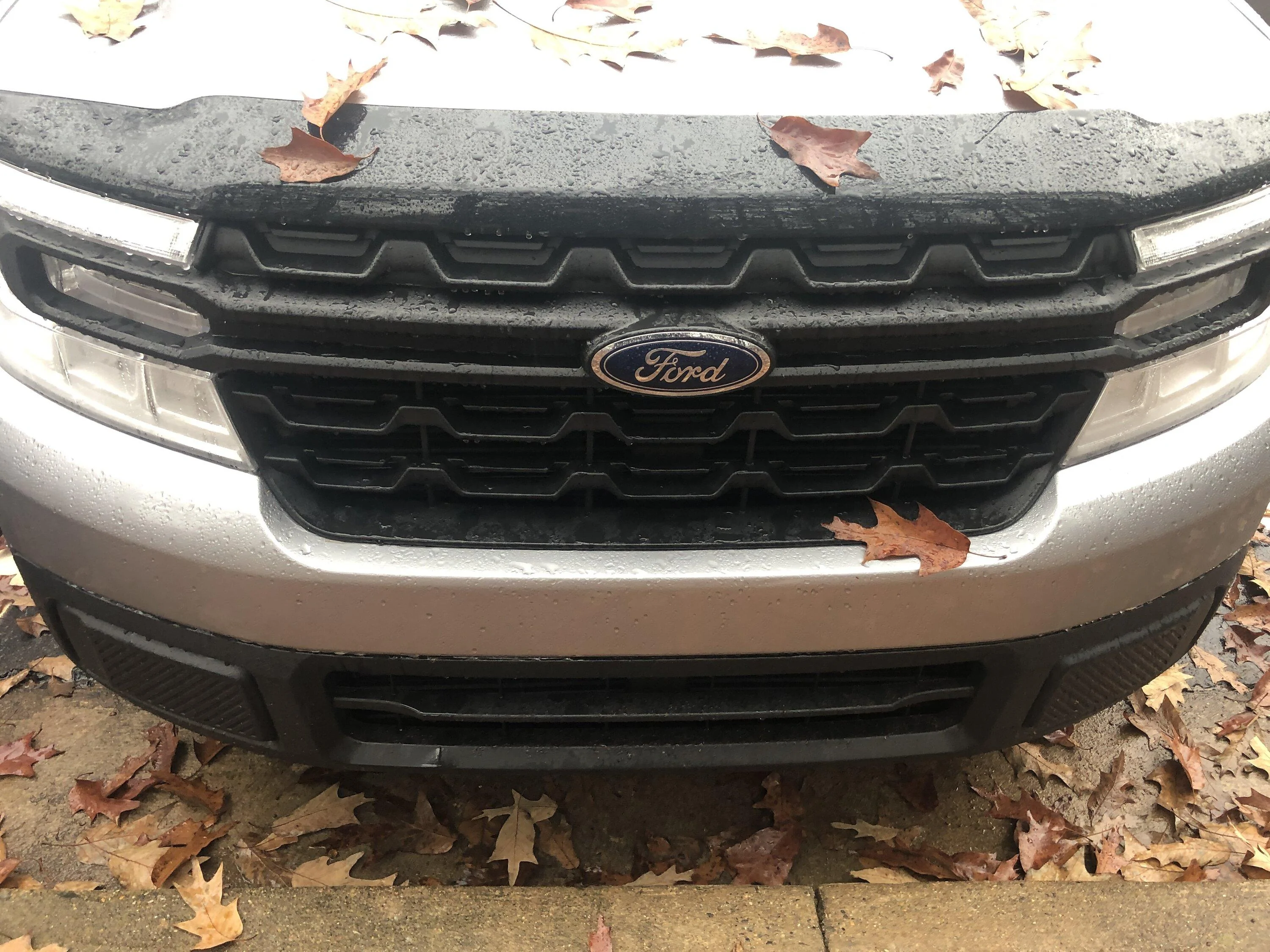

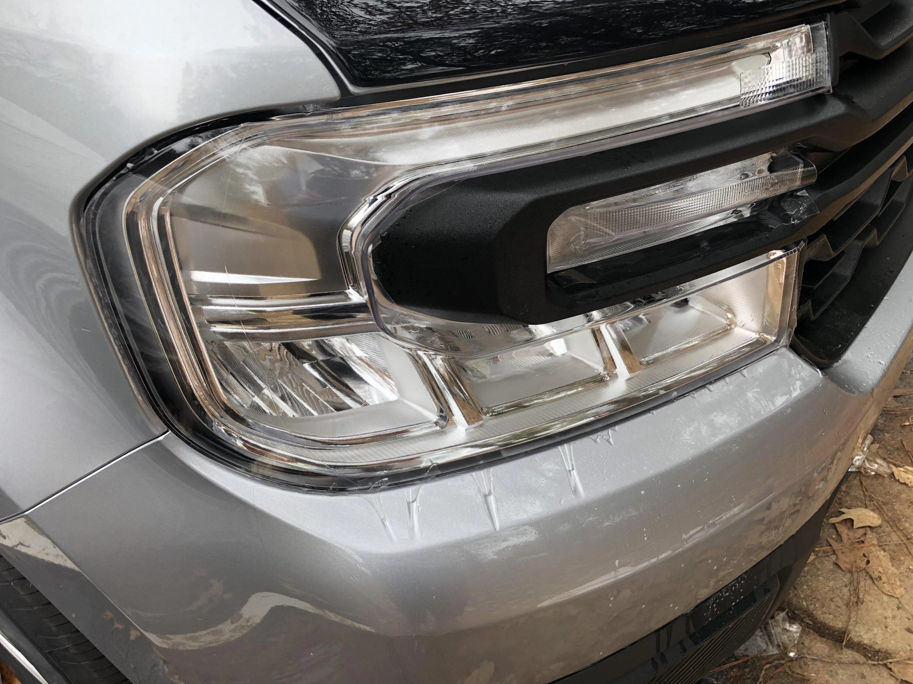

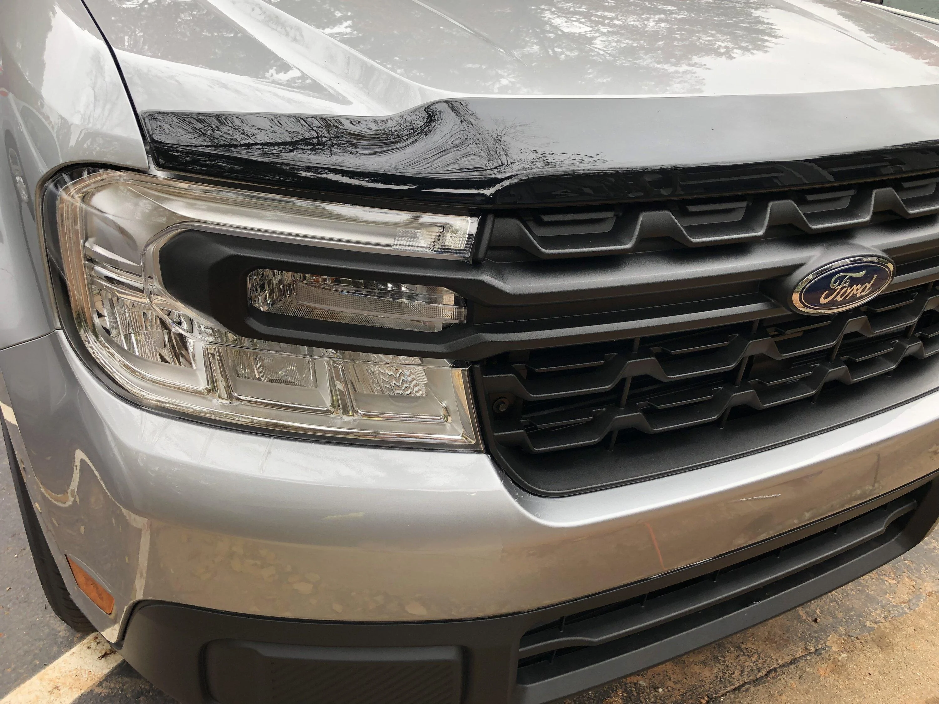

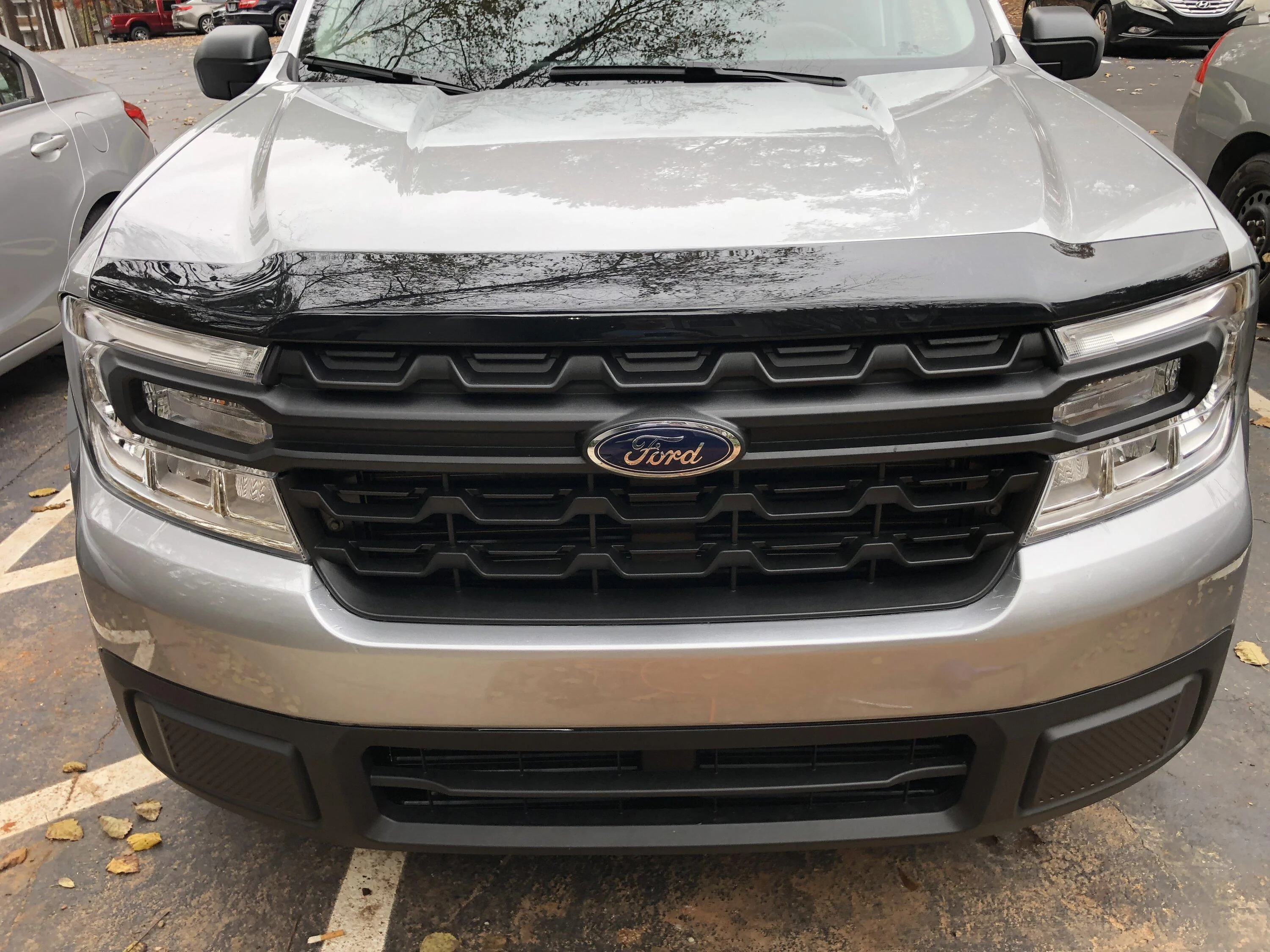

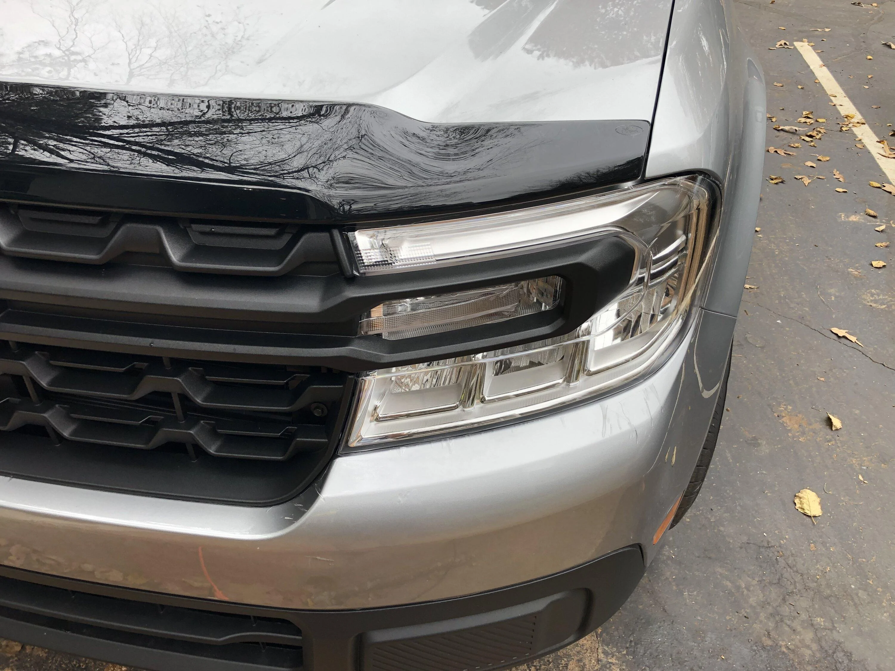

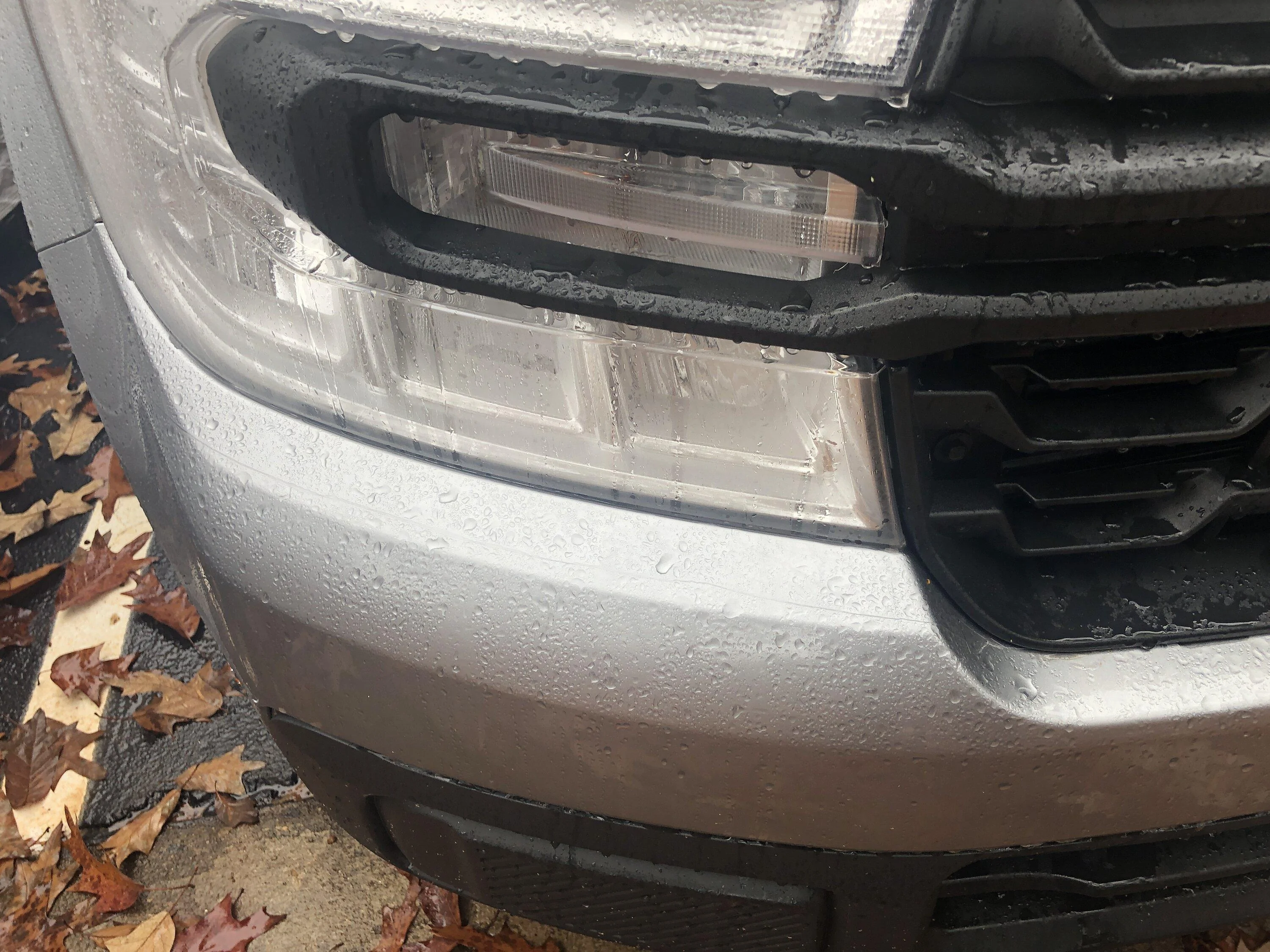

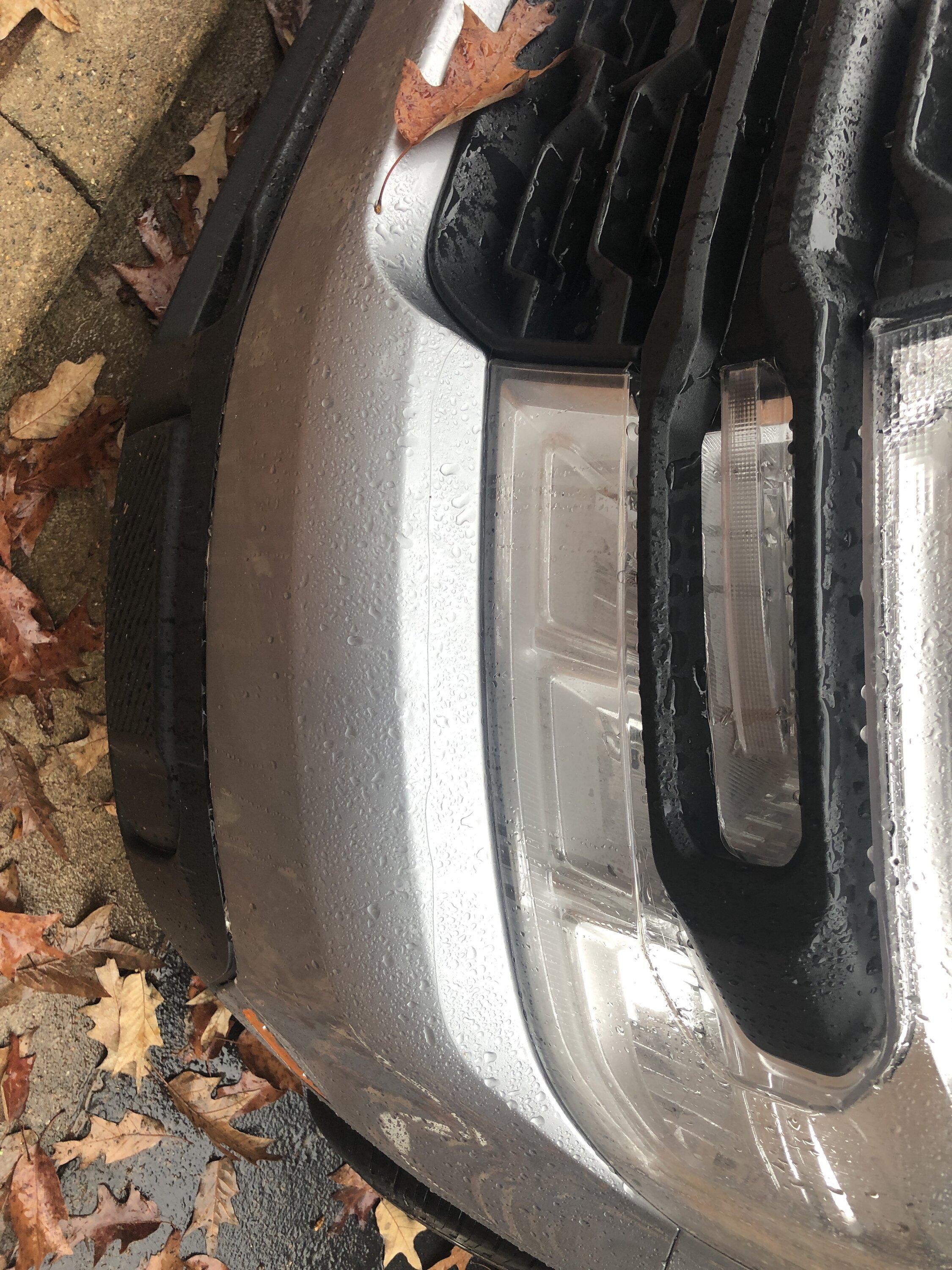

I know its horrible but I need something to protect the front end for the time being. Will do again at some point in the near future. At least I know what to do now.

PPF is really tough to apply to begin with, do it in the cold and it's even worse. Best case scenario is you leave the unapplied PPF out in the sun, start from the exact center point and work your way out to the edges, the ripples you have are because you didn't stretch enough probably because the PPF wasn't soft enough and was tough to stretch.

I mean...that's not too too bad honestly. Now if I had paid somebody to do it and it came out looking like that I would be miffed, but if I did it myself, I might just go over it with a hairdryer and try to smooth the wrinkles, and if it didn't work, just let it ride...

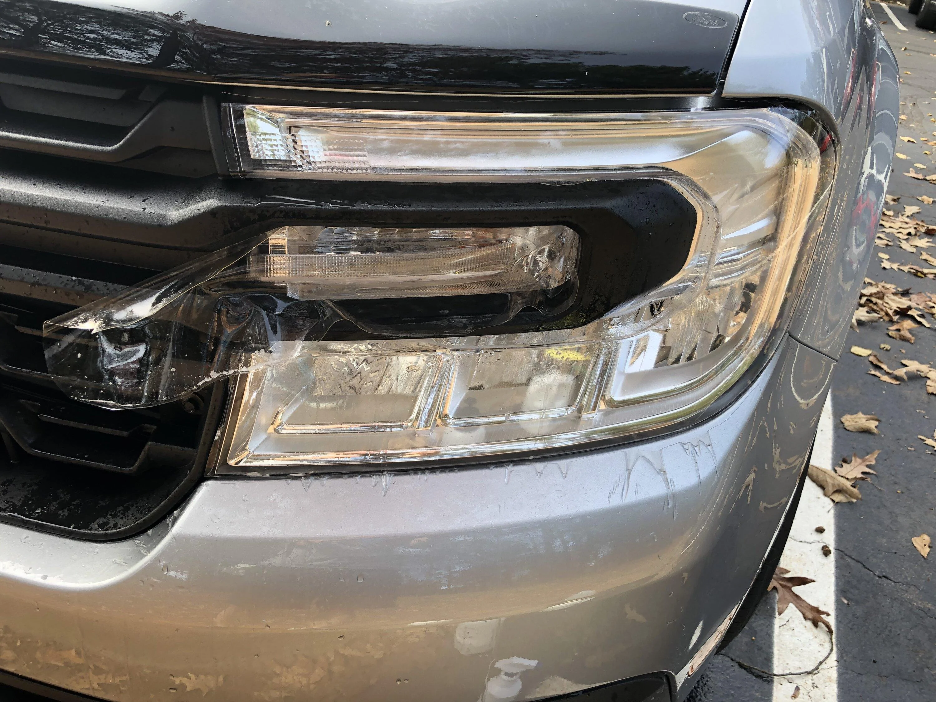

Got a chance to fix the bubbles and fingers from my original install. It came out pretty decent. I should be better at this on my future PPF applications.
