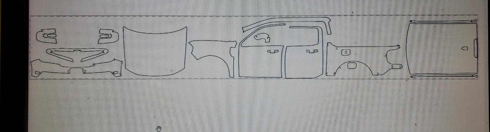

I own a PPF business, but I don't own the patterns. My software lets me cut the individual pieces so when my truck arrives it will get completely covered.
