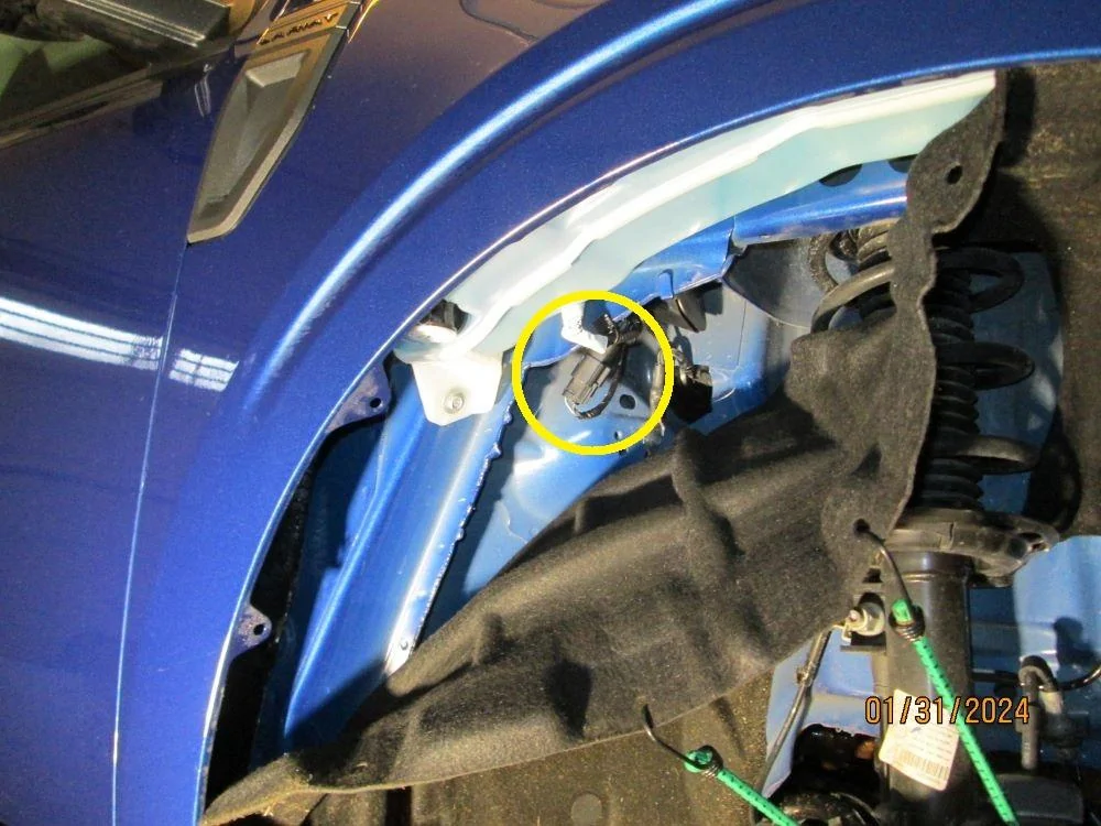

Now I'm a bit annoyed. I looked at the mechanic's work. There are three pins to hold the inner wheel liner in place that he had to pull out to fix the connector. Two pins (top and bottom) are one style of push pin; the middle one is different...at least that is how the unmolested driver's side liner is set up.
I found the liner NOT tucked back in, in the middle, as it should have been; the middle connector hole had the bottom connector stuck in it, and the bottom hole then also had the wrong connector...that wasn't able to be pushed in all the way BECAUSE IT IS THE WRONG ONE!
So....hopefully, they can manage better in the future, but I'll be double-checking their "quality" work.
