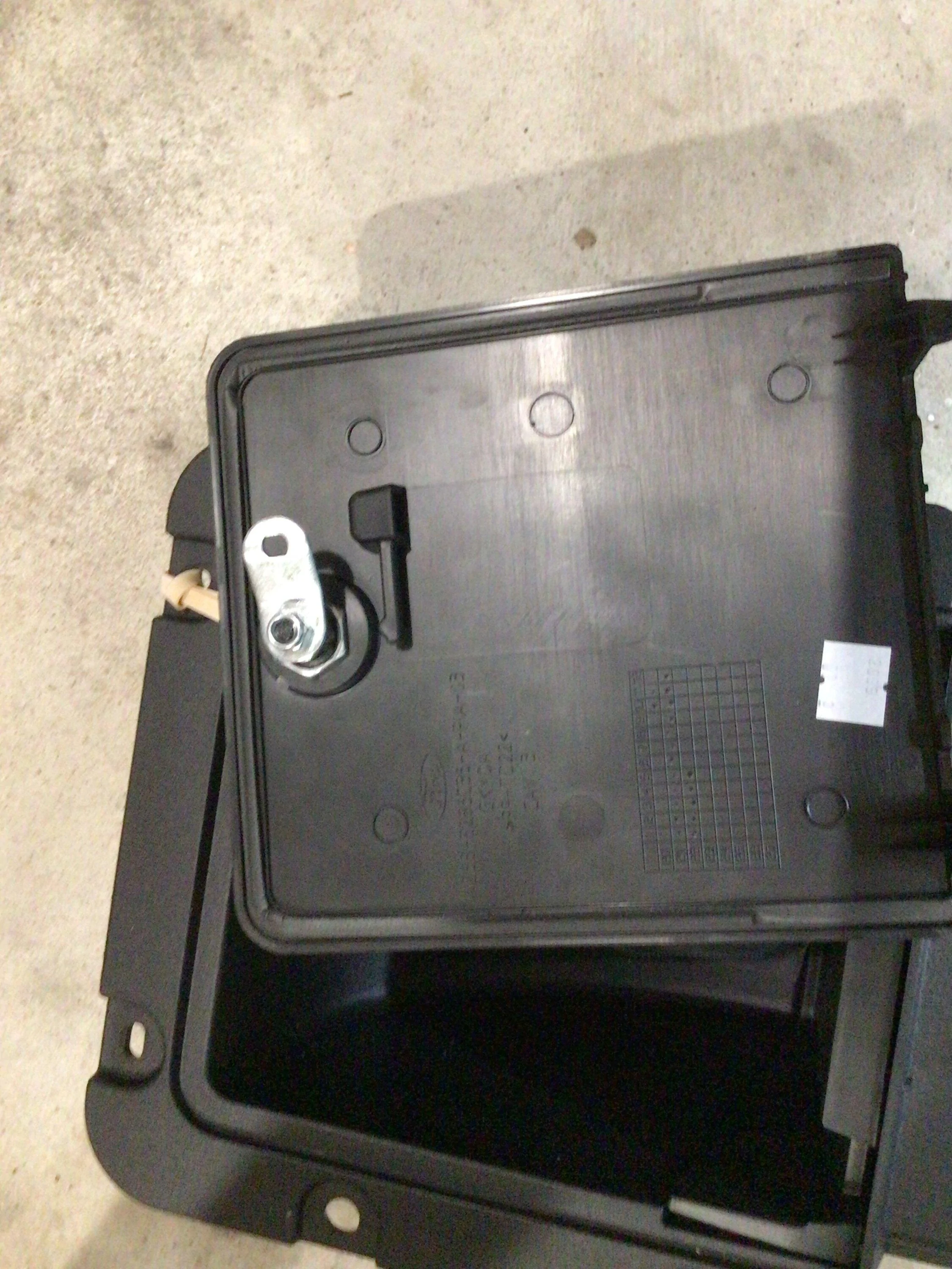

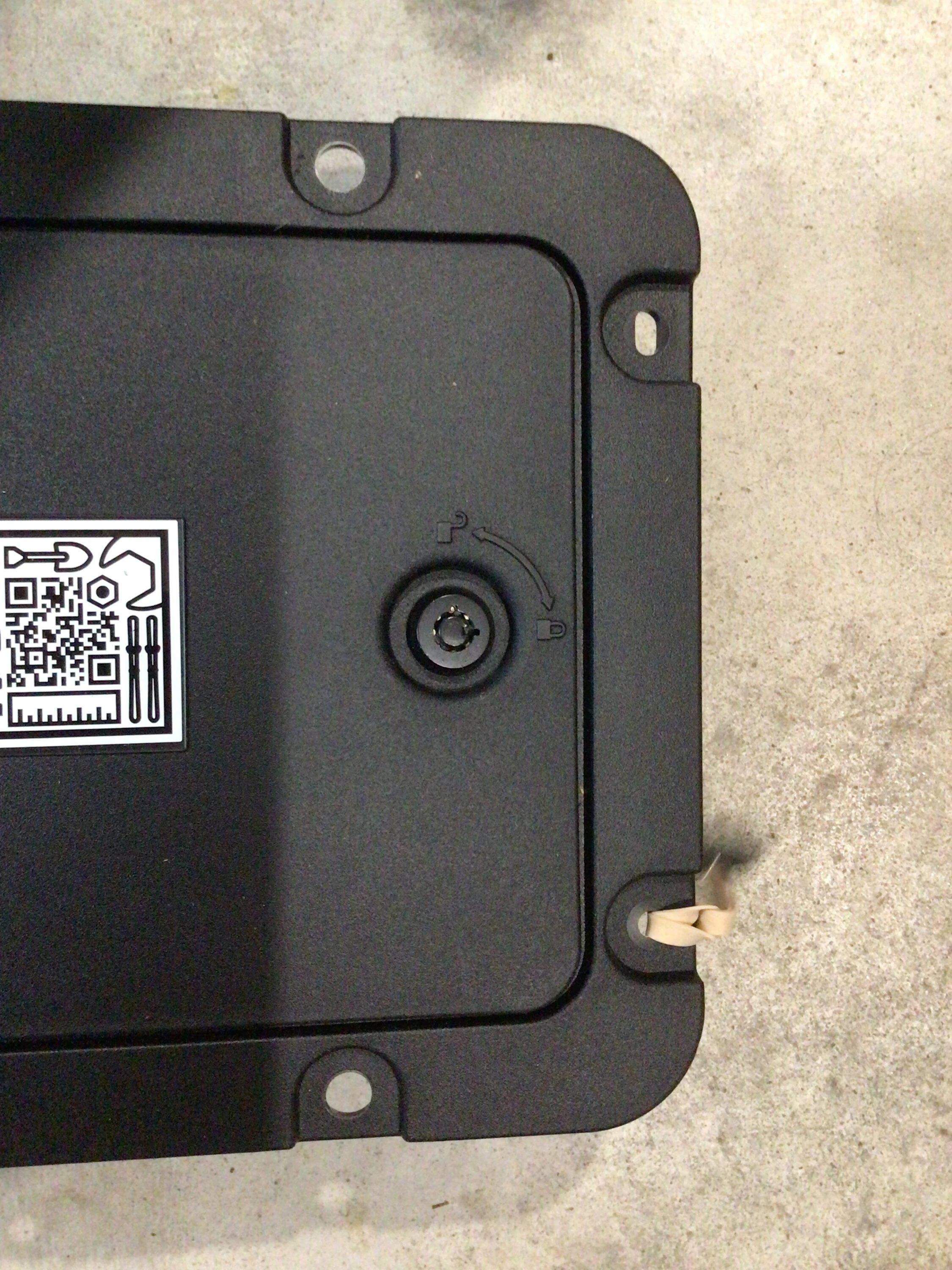

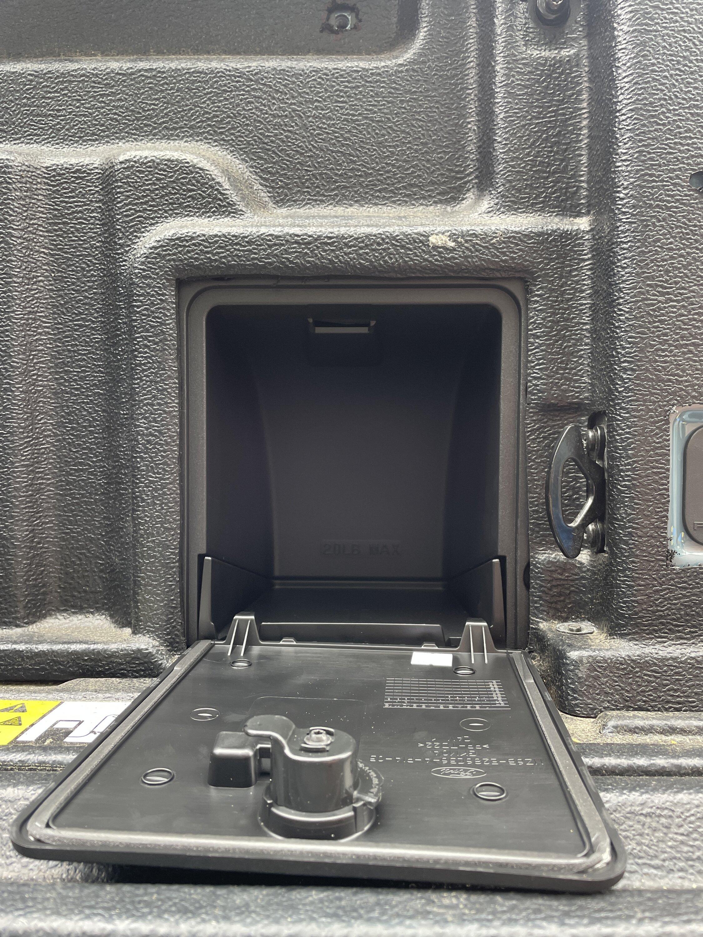

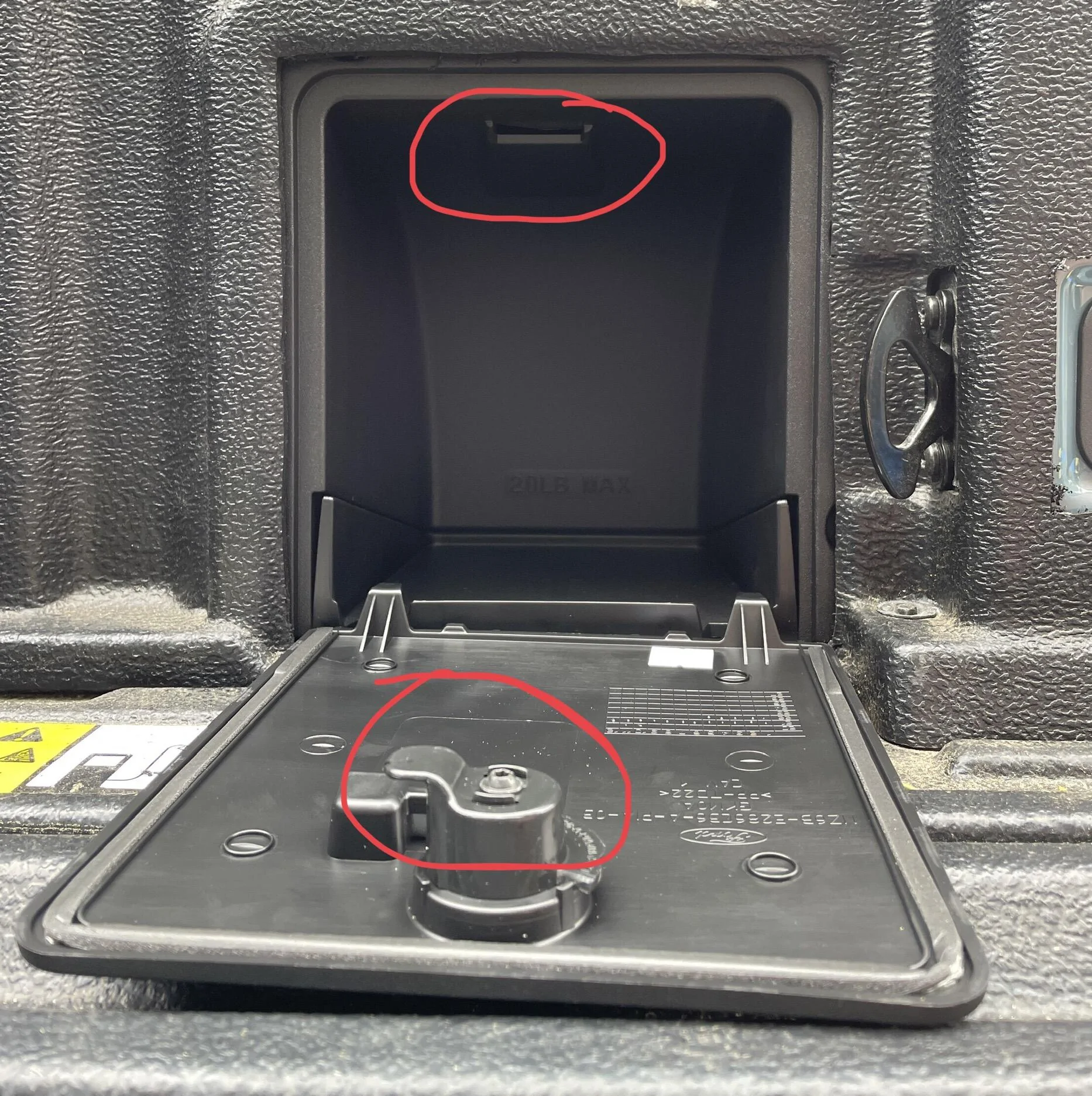

I get the top two picks. What the bottom one?

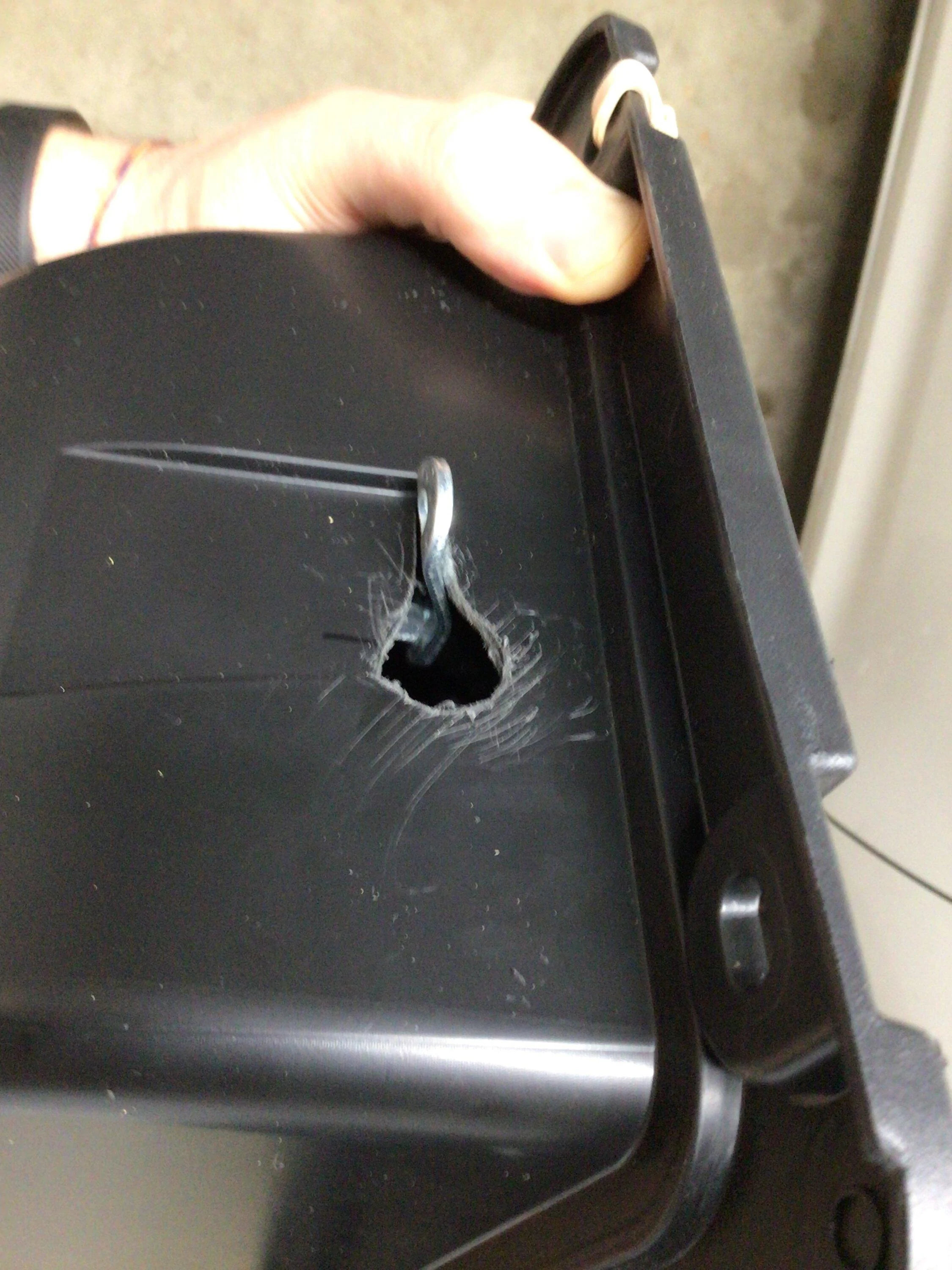

see where the little latch tab from the lock fits into the top of the cubby…..that last pick of mine is looking at the top of the cubby (from what would be looking down inside the bed) where the locking iron latch “tab” fits into the cubby to hold the door closed.
I dint take my time shaping the metal latch on the cylinder lock to fit the existing hole on the cubby….I just took a dremel tool to it instead of making it “pretty”.

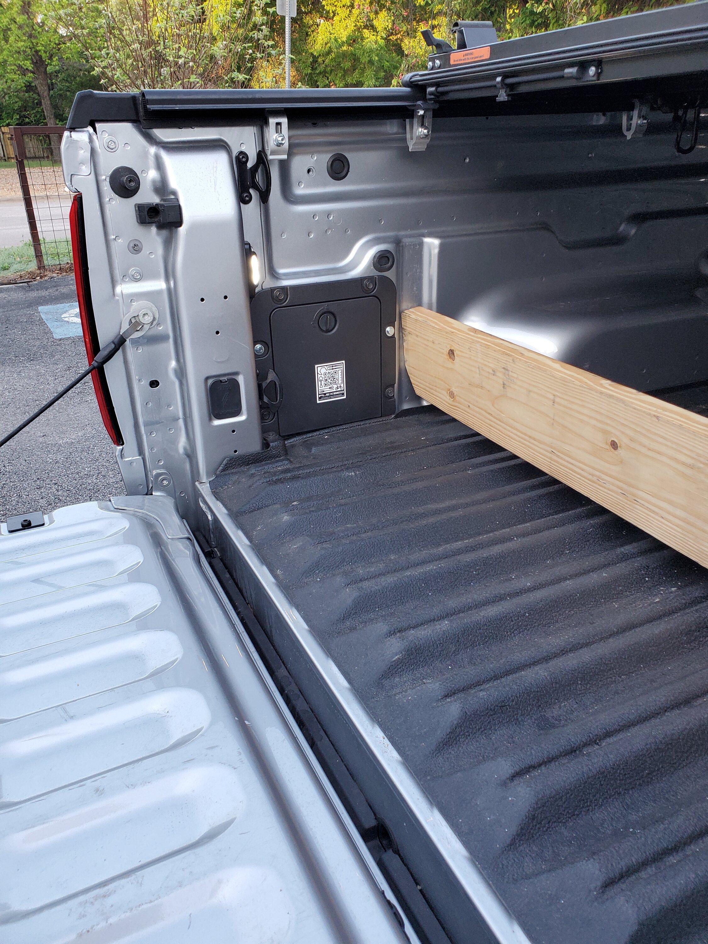

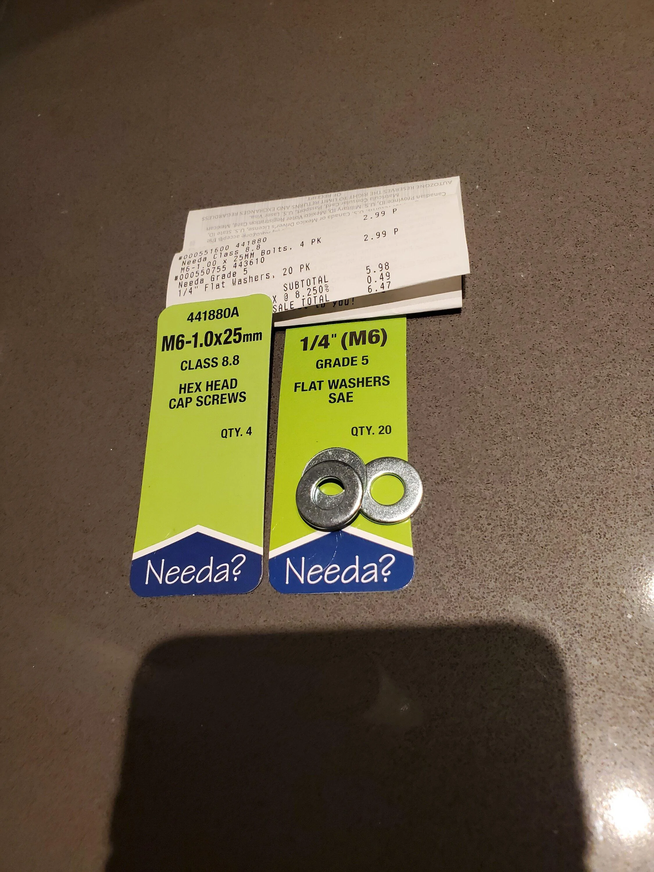

Added my second one to the XL today. I was able to get 4 M6-1.0x25mm hex bolts and some washers, though uncoated, at autozone for $7.
And here's how it works under the tonneau. Should limit moisture/corrosion. But if any arises, I'll just leave them out because 4 bolts are enough for each panel IMO. Also, last year's thread suggests not to over tighten as the plastic can crack.

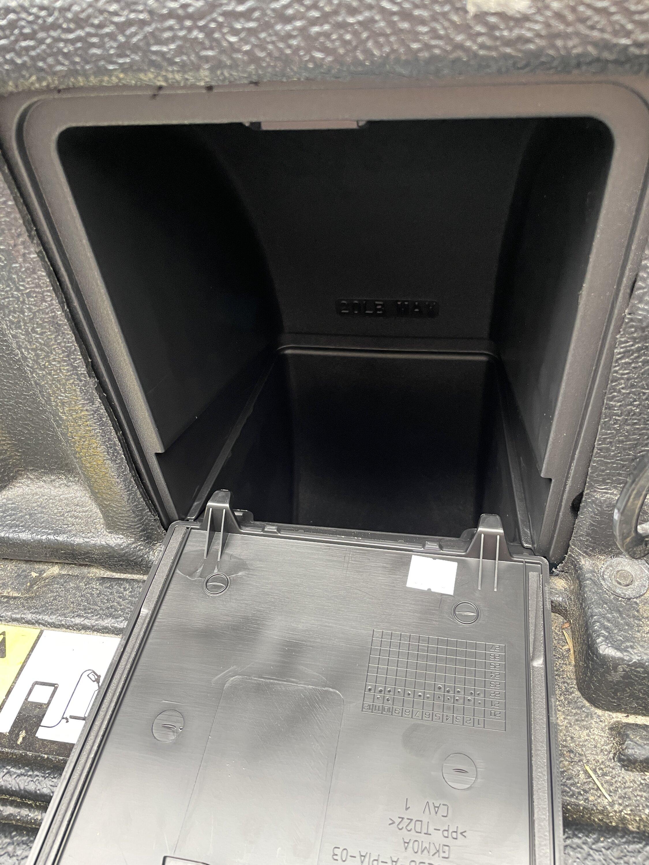

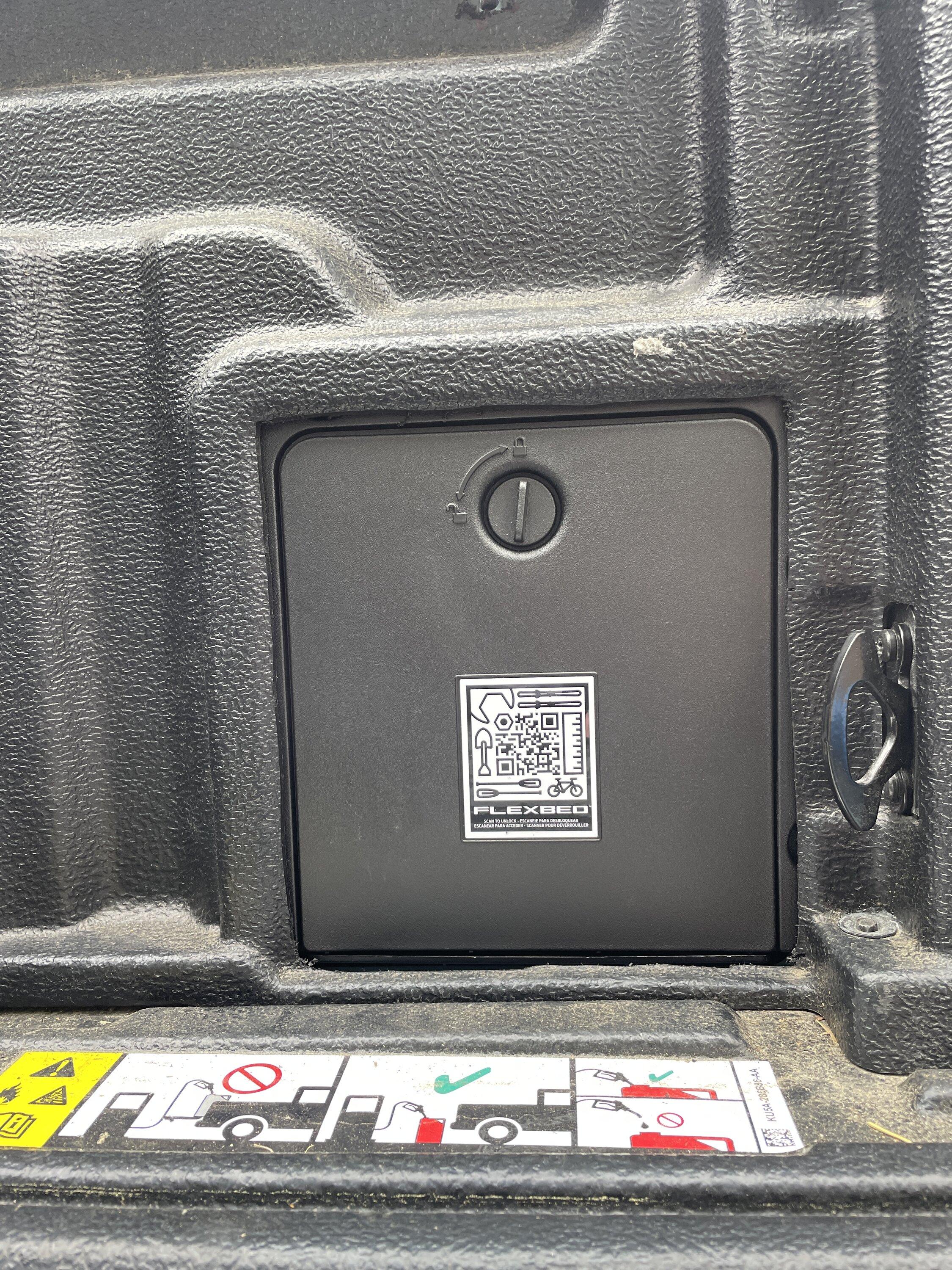

I finally added on the truck bed storage cubby today in my XL. I have the drop in bed liner, so I had to cut the hole out for the cubby.
It worked out well and glad to finally have it back there.
