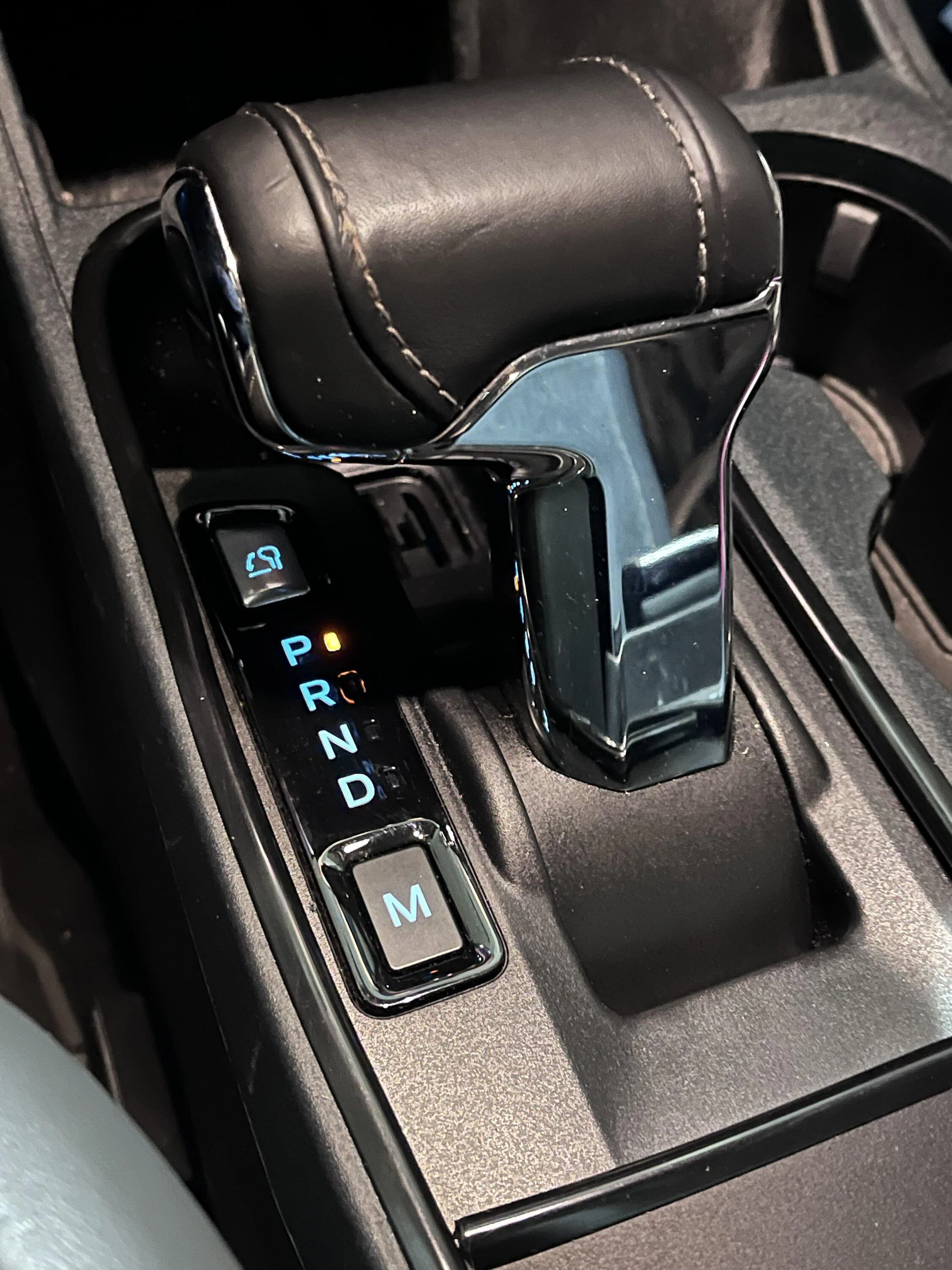

I don't like the dial and picked up a new F150 shifter to give it a go. My Maverick is a 2023 XLT with the 2.0, AWD, and the 4K and FX4 packages. I have an aFe CAI on order and will be installing some other upgrades as well.

The 21-23 F-150 shifter works on our trucks. It requires some trimming of the console but the plug is the same and it drives like normal. Haven’t hooked up the paddle shifters but I assume the shifter buttons will work once wired. This is temporary until I make a better mount but it fits and works. I’m going to make a panel for the brake and drive modes in front of the center console.
First of all, I love the F-150 shifter. But I do have a few questions. 1. Did this throw any can-bus codes? 2. Would this work in a Maverick Hybrid? 3. Can you share a more zoomed out photo of the shifter and console?

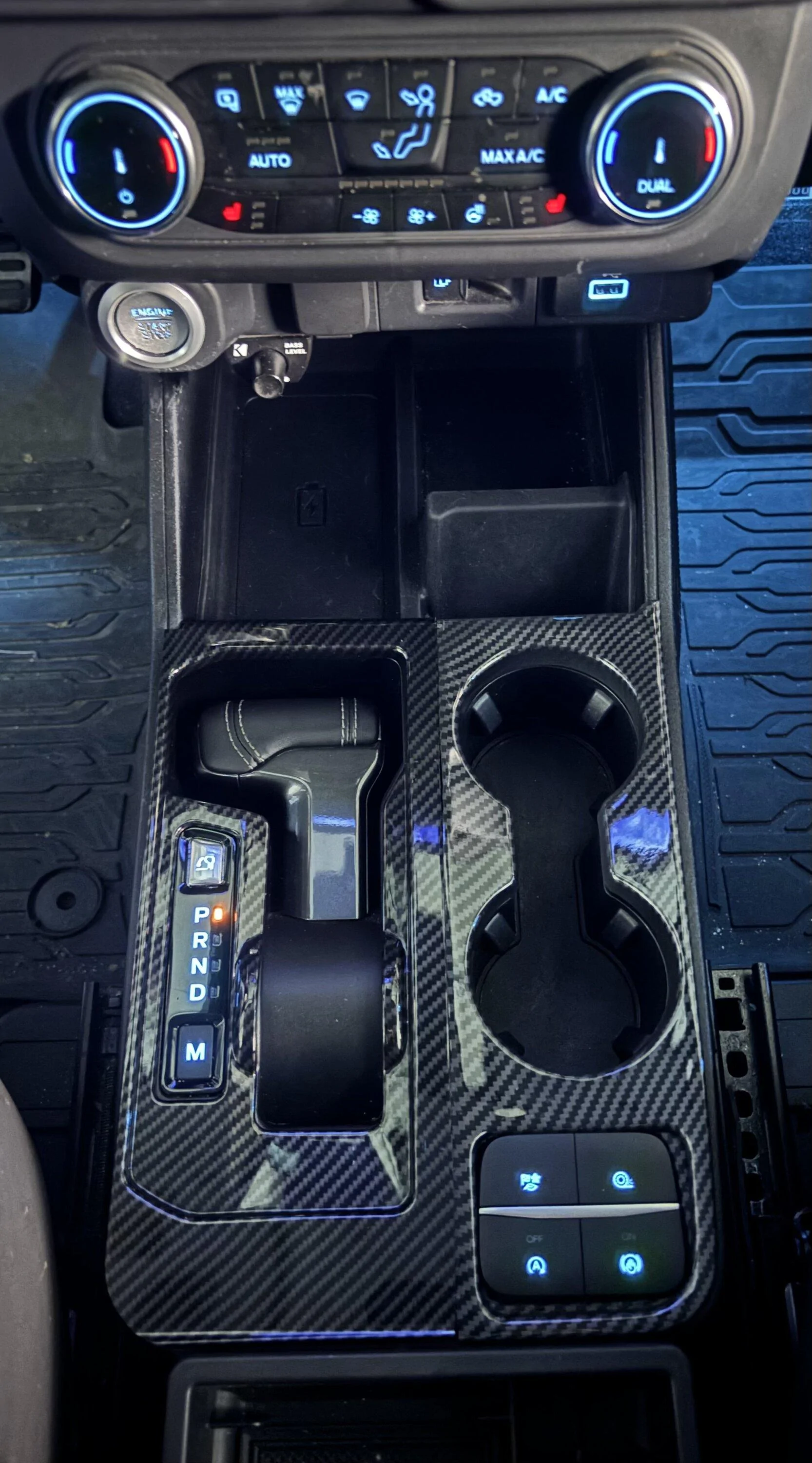

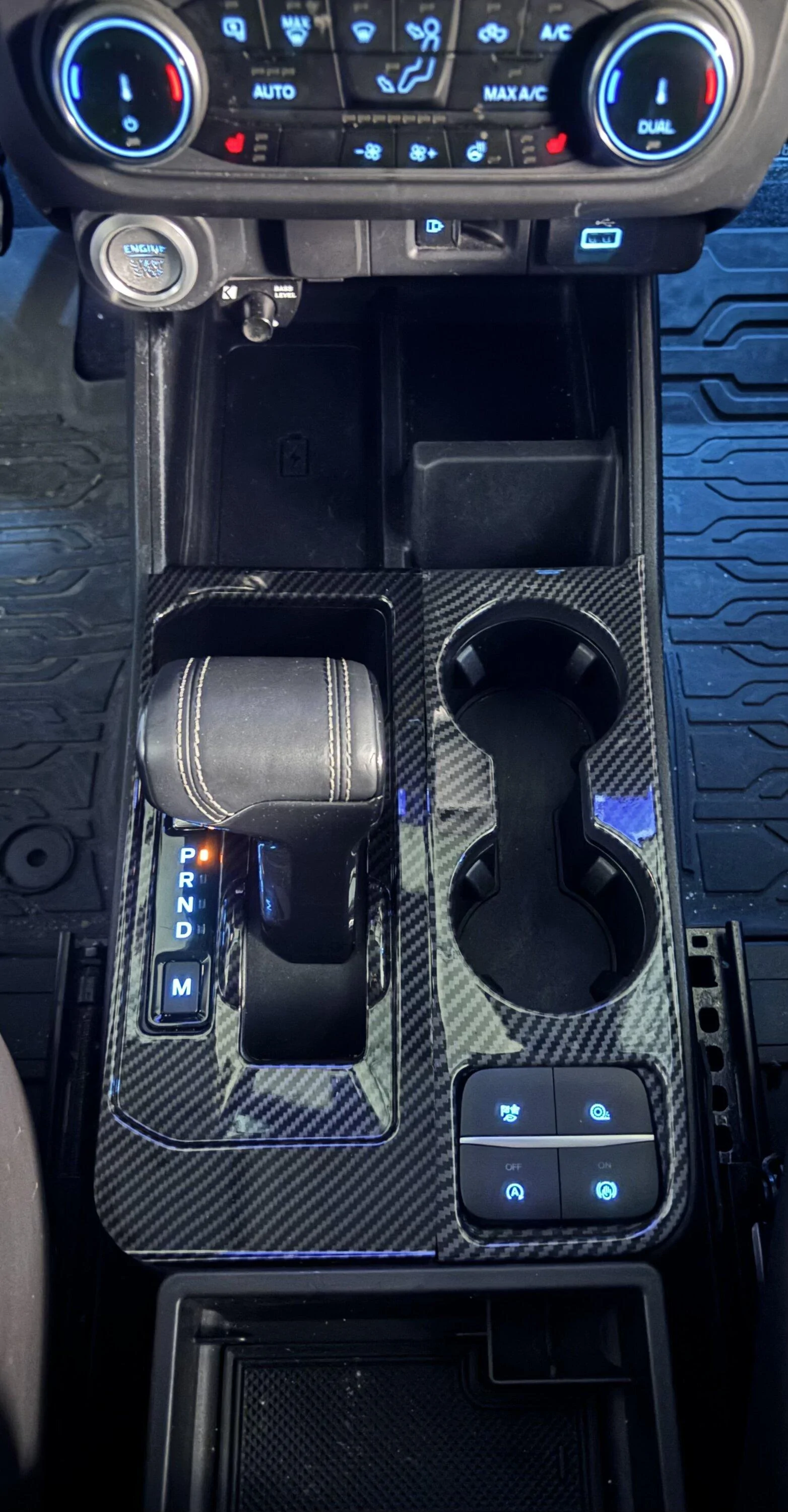

Here’s the finished cover with mode selector mounted. E brake in place of trailer brake (I don’t tow with it) If you need the trailer brake, the bezel is a separate pc so you could buy one and mount it underneath since it’s a perfect fit for the switch. I’m gonna send this off to be made in one pc and get a batch made for those doing the swap.

Looks great! Will these be on your website when they're available? Doing any other looks other than the carbon fiber?
Definitely keep us posted. Would love to pick one up when you've got them ready!
