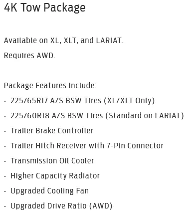

I ordered the 4k not because I'm ever going to tow, but for the extra towing (117F is a common august temperature here).
How did the project cost compare to the factory 4k option?
[ok, I'll have to find something to to just because the hitch assist is so shiny!]
Overall it all cost me around $400ish. That’s for the 7 pin, brake controller, hose, cooler, etc. and approximately 10 hours of time.
If comparing to the factory option and not pricing in the cost of AWD which is at the time I think $2k I think that puts the factory option right around $800 which is a no brainer to go the factory route.
I just happened to buy one of the first Mavericks off a lot back in 2022, at the time I had no clue what this truck was and the dealership seemed like they had no interest from buyers in our area. For a Lariat trim with only the 4K tow and moonroof missing it was $29k out the door so I couldn’t say no. But later getting into boating and getting a small camper I wished I had gotten something with better towing. When looking into it the 3 differences between the 4K and non 4K was the 7 pin connector, the transmission cooler and the slightly lower gear ratio.
Adding the first two makes me fairly confident I can tow around a 3,000 with no issues. Especially since they are all shorter distances (less than 70 miles) once a month or so.
The 4K tow package also included a trailer brake controller, higher capacity radiator and upgraded cooling fan. It was probably the best value of any option available on '22-24 Mavericks.
The supplemental transmission cooler is definitely one of the most important pieces of that package, and you now have that covered.
