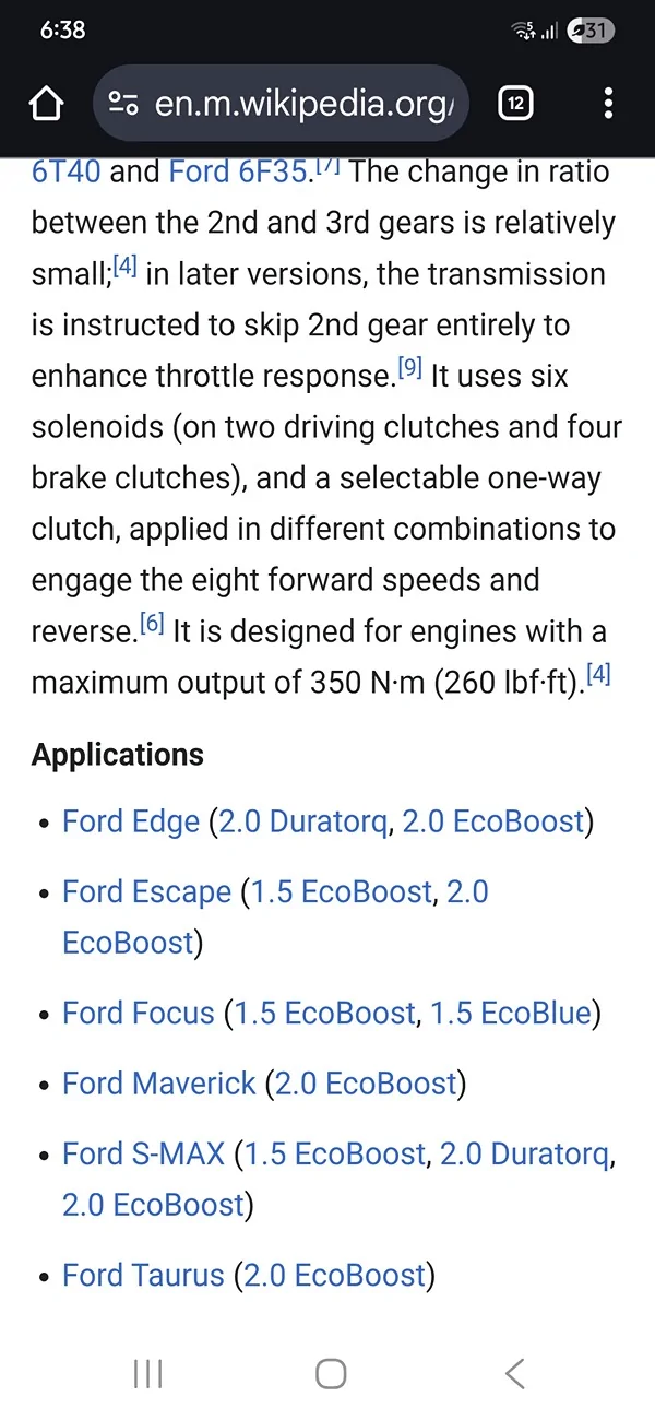

The 8F35 transmission is designed for engines with a maximum output of 350 N⋅m (260 lbf⋅ft)... so why bothered 🤔

FYI
Ford Maverick Engine mods: A Wolf in Sheep's clothing? Screenshot_20250813_183853_Chrom

I wouldn't worry about the transmission TQ capacity. The Lobo 7 speed is the same as the trans in the now discontinued Edge ST which has a twin turbo V6 with 335 HP & 380 lb-ft TQ.
I have a 2020 Edge ST and it hasn't broken the tranny yet.
For reference: 2025 Ford Maverick Transmissions: Everything You Need To Know
And: 2021 Ford Edge ST Gains ‘New’ 7-Speed Automatic Transmission: Exclusive
Seems the Lobo’s transmission is underrated in the TQ department. Based on your Edge, the Lobo could probably handle 400 lb-ft assuming the Edge was not on the hairy edge of blowing up:)

I think Ford Authority is wrong about the Edge ST tranny being the same. I've found other references that the Edge ST uses the 8F57 trans. Part K2GZ-7000-A.
The standard Edge 2.0L models use the 8F35, Part K2GZ-7000-C.
I have the 2025 Ford Maverick FSM. All the references in FSM are to the 8F35, including the 7 speed operation:
"307-01B Automatic Transmission - 8-Speed Automatic Transmission – 8F35 Maverick
Diagnosis and Testing
At times the 8-speed transmission may skip gears when the vehicle starts from a complete stop. This is normal and desired behavior. This transmission may also be described as a 7-speed transmission. For the 7-speed applications, 2nd gear is not utilized.
At part pedal when acceleration is brisk, single step upshifts would result in very frequent shift events (very short time in gear). Double step upshifts results when a longer time is spent in gear.
However, at light pedal or road load, single step upshifts will occur. The small 8-speed gear steps allow the engine speed to drop to lower values than it would in the 6-speed transmission; providing for the best fuel economy. In contrast, when the 8-speed transmission is at heavy or max pedal, the small steps keep the engine closer to the horsepower peak for best performance.
Downshift Gear Sequence
At times the 8-speed transmission may skip gears when the vehicle downshifts to a complete stop. This is normal and desired behavior. This transmission may also be described as a 7-speed transmission. For the 7-speed applications, 2nd gear is not utilized.
The same skip shift strategy that is used for the upshift may be applied during downshift."
So I agree with the above folks about modding for too much power. I expect the PCM would probably limit the requested TQ to stay in safe limits anyway.
See: https://highburyford.com/blog/oem-parts-in-the-revolutionary-ford-8f57-transmission/
