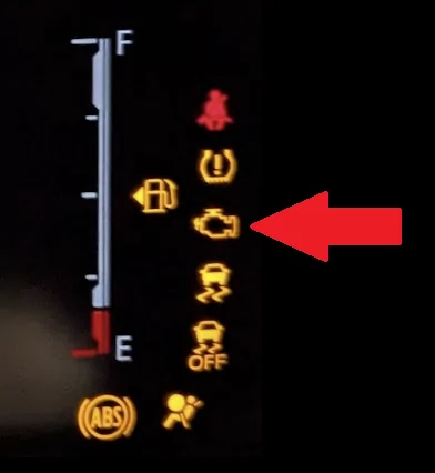

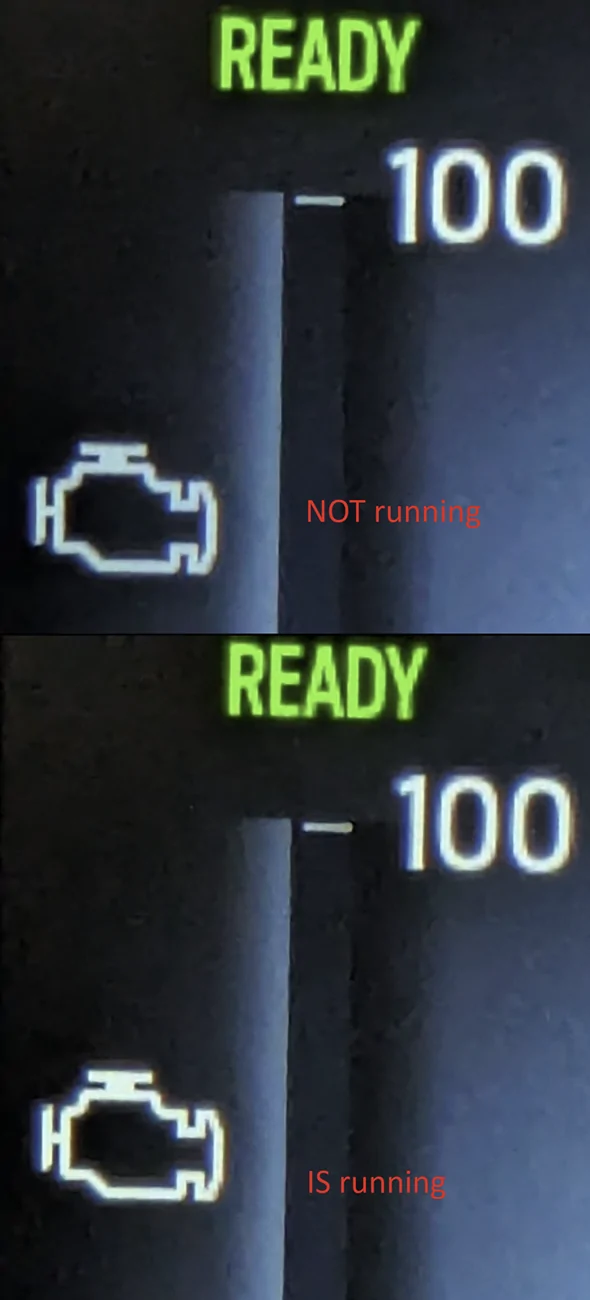

Is it the yellow engine light, or is it white?
Yellow (first pic, it's on the right side of the instrument cluster) is the "real" check engine light, grey/white is the indicator that the ICE is running (is grey when it's not, second pic).

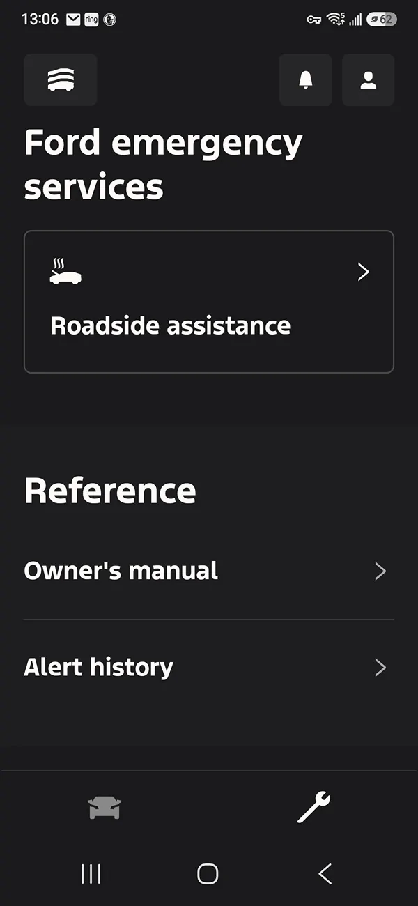

Check/refresh your Ford app...does it give you more info regarding you check engine light?
Just a thought...check below pics of Ford App and where info is found.

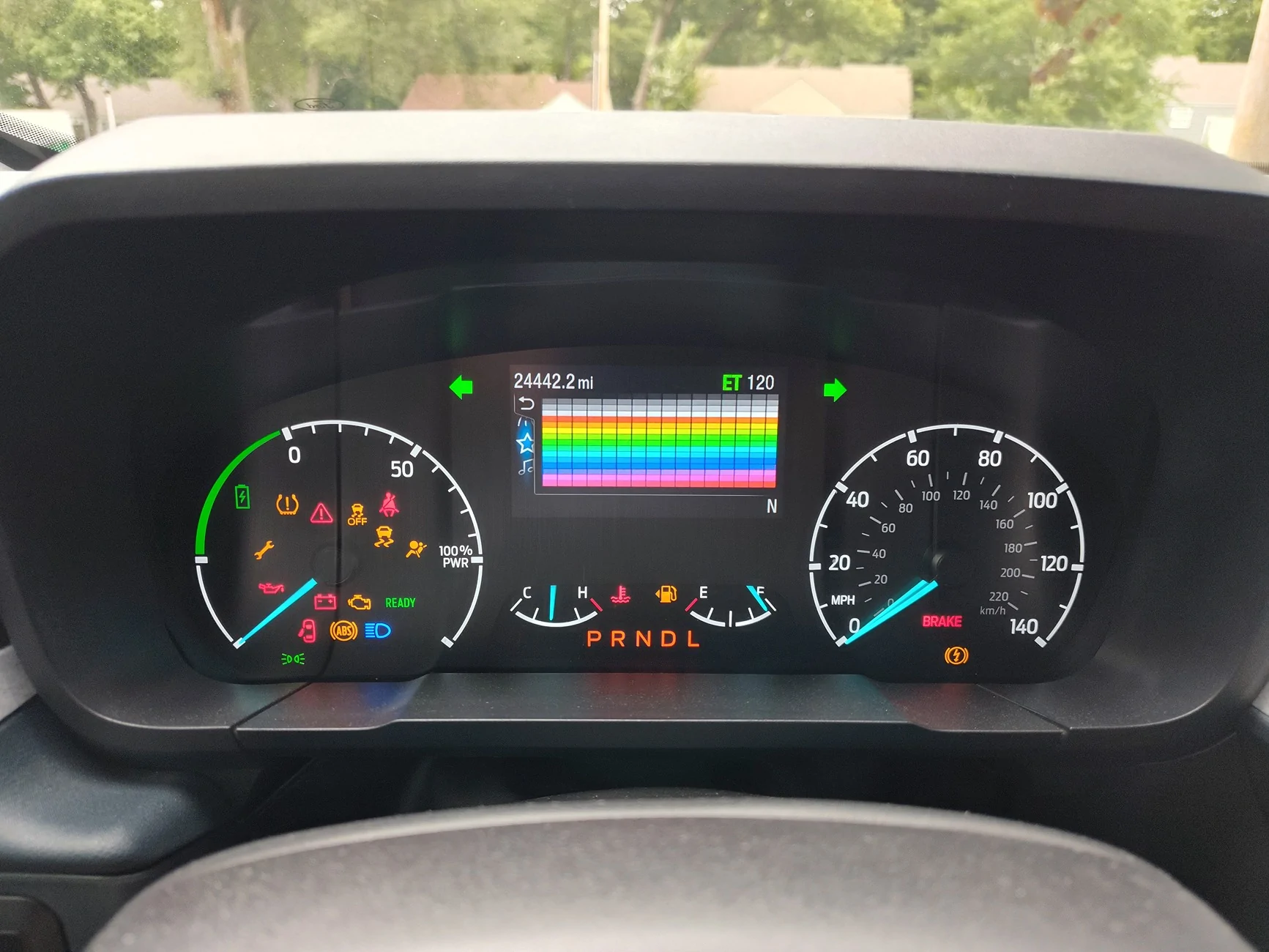

Wow - no wonder there are complaints on that subtle difference not being useful.
Oh well, pre-25MY show- that by way of the EV coach and EV gray bar, which causes confusion too.
I think your 1st pic is why it's useful for a driver with new vehicle to get a picture/video of the dashboard right as Acc mode is used to know what lights are possible, since it's on the multi-point inspection to confirm all the icons light.
Or use Engineering Mode to confirm them. But ya gotta know what's possible to figure out what's missing.
I'm kinda wondering about that extra space under speedo now - seems like more should be there. hmmm
