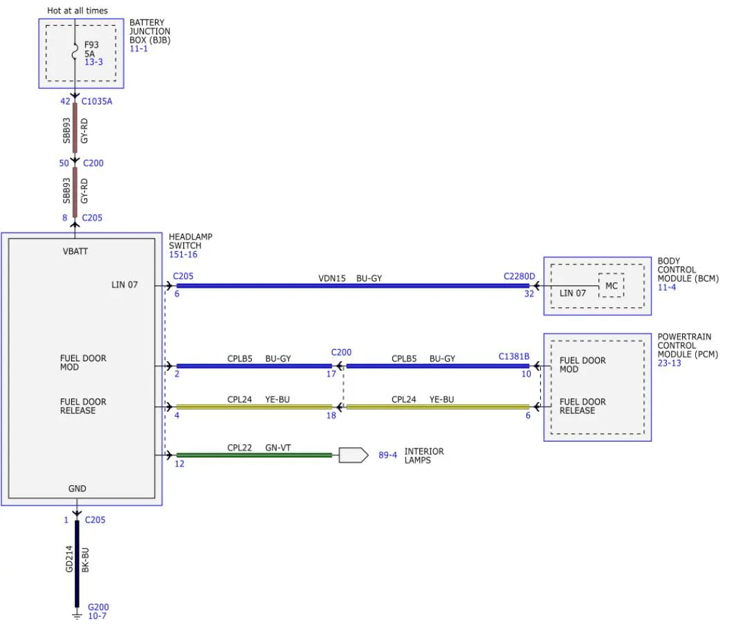

did you disconnect the battery first?

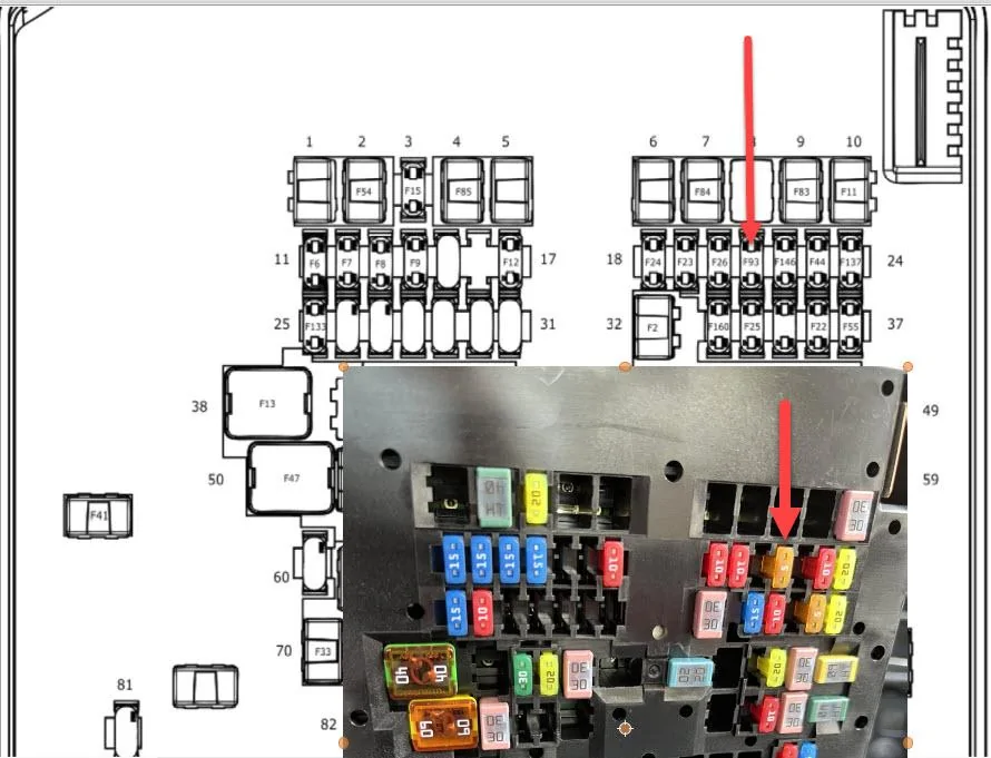

F93 5A, wonder if it somehow is blown?
Ford Maverick Unplugged engine bay fuse box now headlights wont turn off Headlamp Switch, Fuel Door
Edit: 2nd Look at pict of my BJB F93 looks like the Yellow 5A Micro2 in my BJB.
Ford Maverick Unplugged engine bay fuse box now headlights wont turn off F93 F93, Item 21 in BJB for Headlamp Switch
Ford Maverick Unplugged engine bay fuse box now headlights wont turn off F93, Item 21 Headlamp 5A Fuse in BJB
