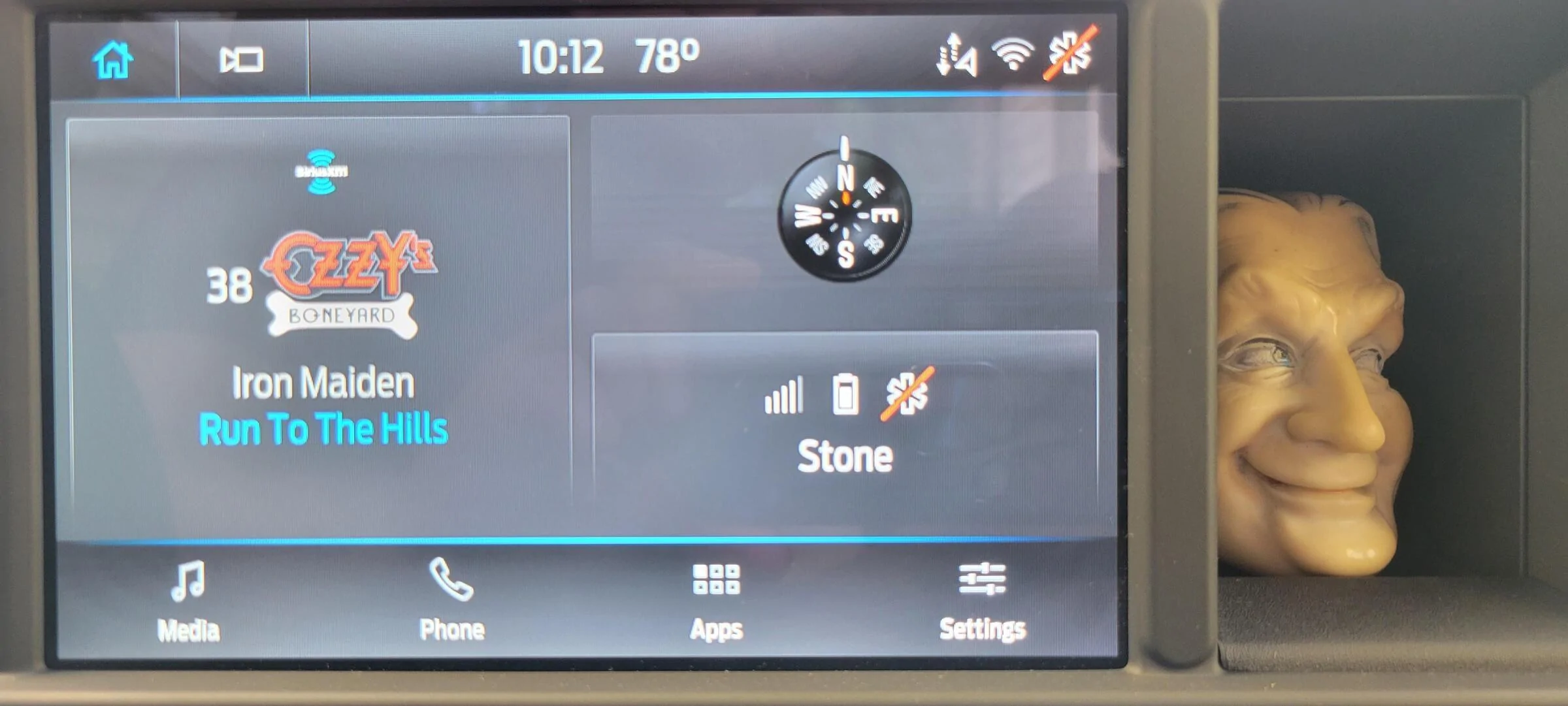

Not true [anymore]. FORscan was only needed for the FMods Jailbreak procedure to time the SYNC3 reboot just right -- pressing and holding VOL/PWR+SeekForward will initiate a reboot as well.
a few days ago I jailbroke SYNC3 on on my new LariatLux following the FMods written instructions without resorting to FORScan for timing the reboot -- I had my left hand on the reboot buttons as I inserted the 1st USB stick with my right hand and hit the buttons maybe a heartbeat after the USB stick was mounted by the SYNC3 system. if you get that 1st step wrong, the 2nd USB stick will not work, so rinse and repeat the 1st USB stick procedure, no harm done. the Jailbreak procedure is super simple so long as you read and re-read the instructions and prep your USB drive just right for the two steps that follow. it's perfectly OK to reuse a single USB stick for each step so long as you wipe or reformat the USB drive clean between every step.
Ford Maverick Enable Rear View Camera when moving forward? uhrbkuS
see the VidCam button right next to the Home button in the upper left of the screen? that enables the RearView Camera on Demand function.. 🤓
I also installed FMods to change the color scheme to Dark Grey, a Fancy Rotary mod and a Video Player mod.. the Video Player mod allows playing video files from a USB thumb drive on the SYNC3 screen..
and before anyone asks, that Grandpa Al Lewis cubby mod is one of a kind -- good luck finding one of those.. :p

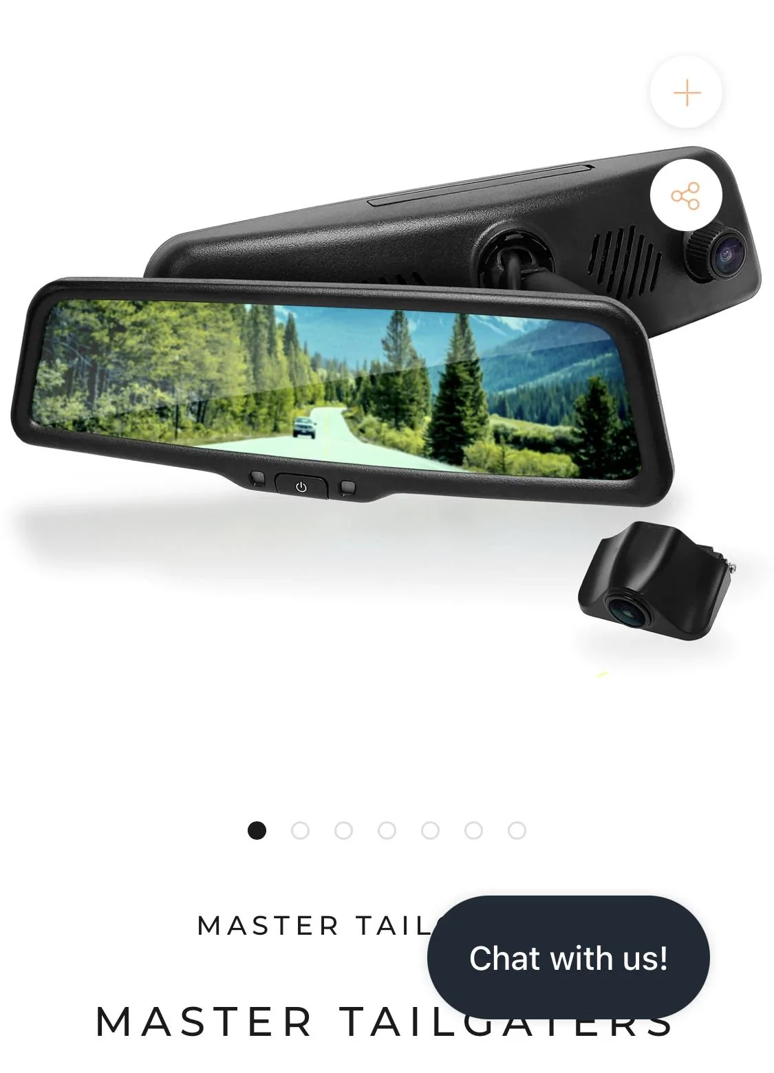

Your better off getting a smart mirror or video mirror. Autovox Tailgate Masters sell them where your mirror is a video screen fed by a camera outside your vehicle. So you have no restriction of view. Also if turned off they work just like a normal mirror.
