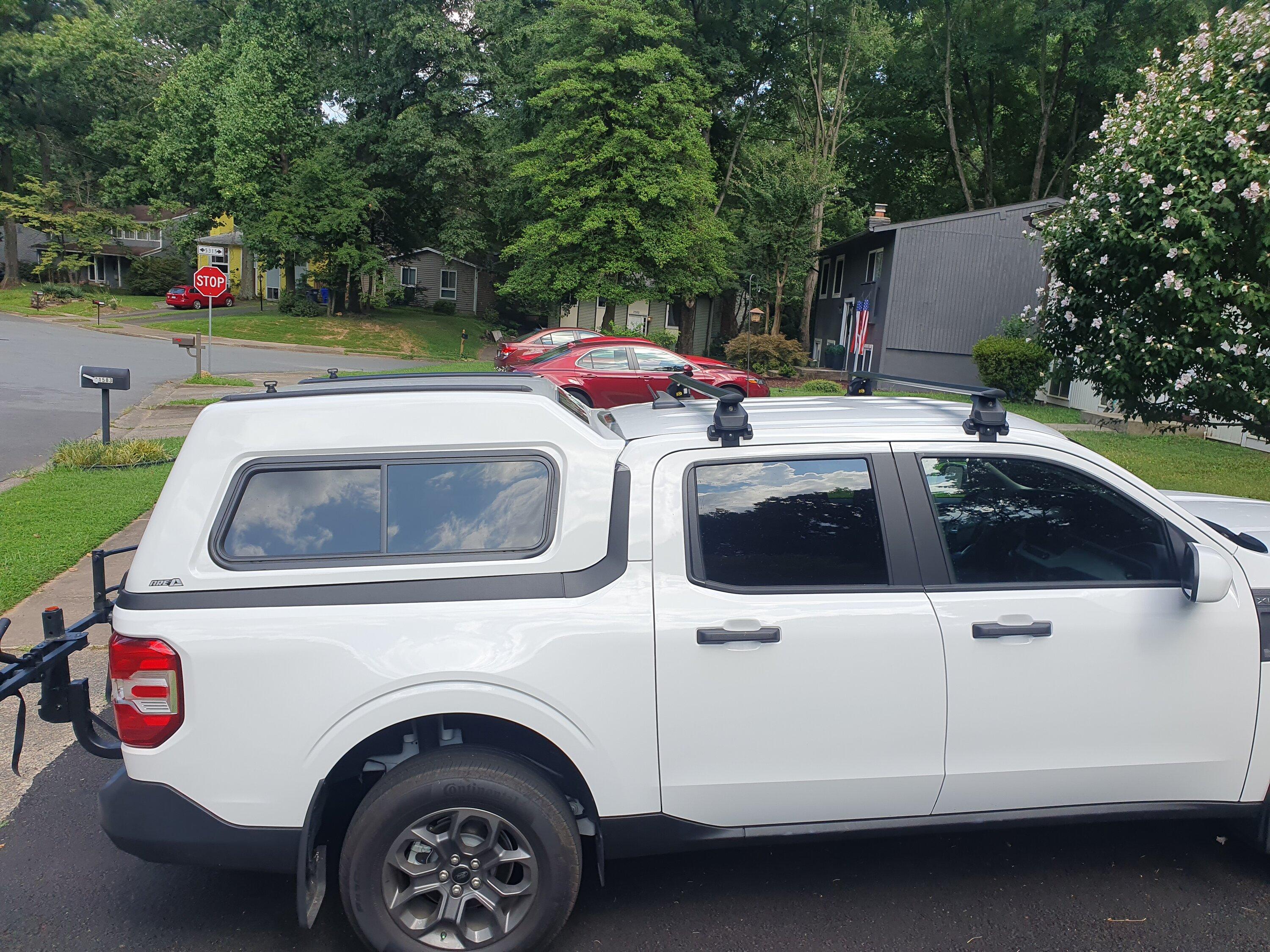

Hope you get a real answer. I looked at all those racks. Looked too complicated to me with the tonneau. Finally I went with an expensive cap and cheap cab roof rack instead. Plus the hitch mounted rack.
Share a photo if you can, I'd like to see it. I'm sure it's an awesome setup, just more for ladders and construction rather than sports accessories? Again, hope you get a real answer.

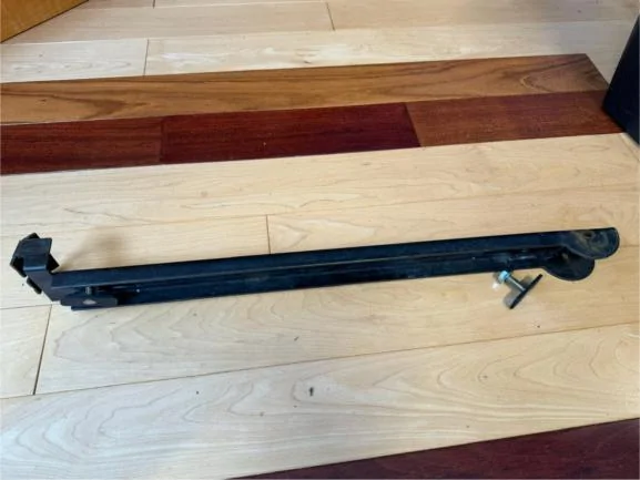

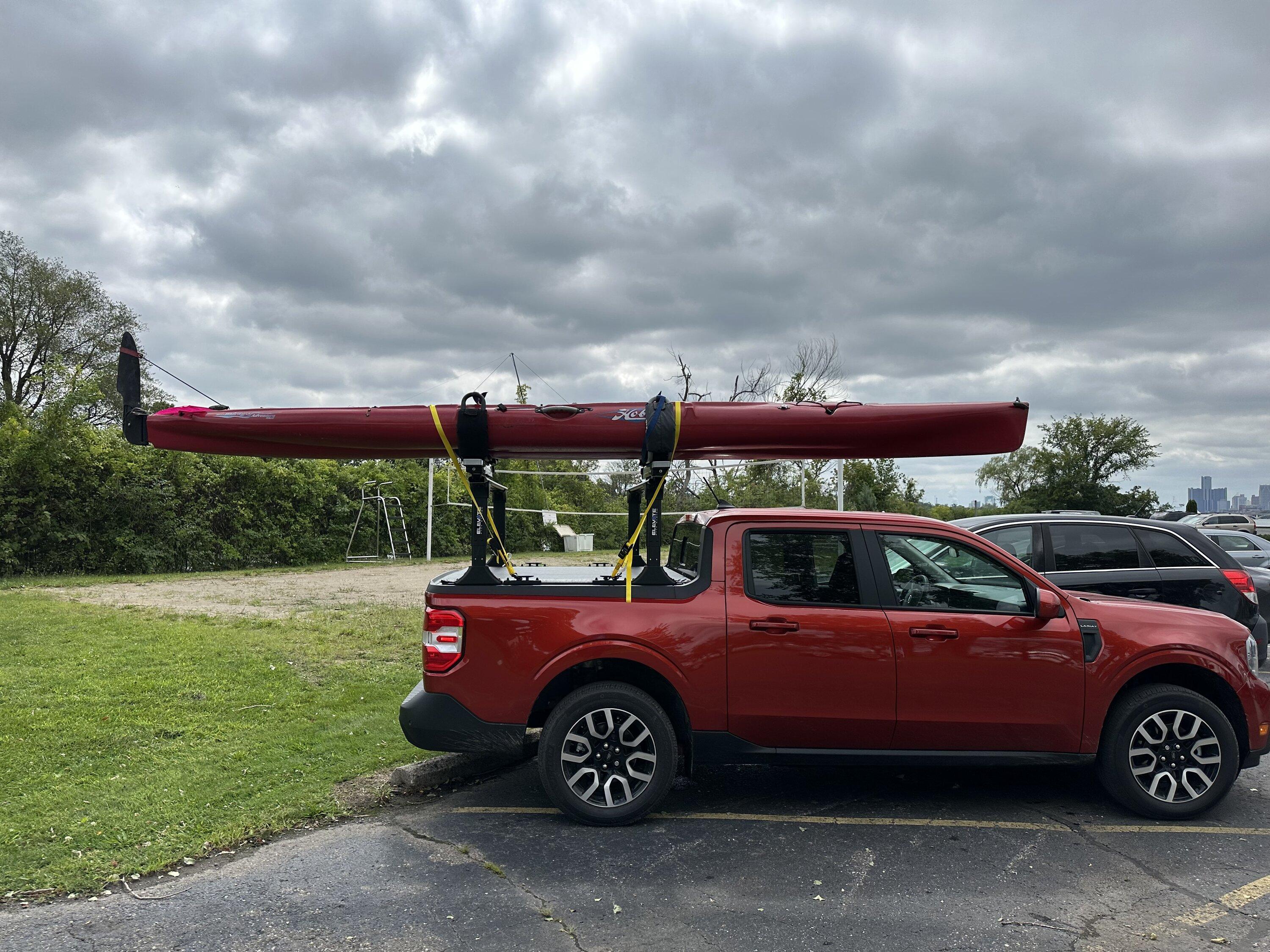

I suggest using T-Bolts or Sliding T-Nuts in the center slot of the horizontal bar.
First pic is of a piece for a Thule kayak rack modified slightly to use the extra t-bolts that came with my Elevate Rack. Second pic is with the kayak in place.

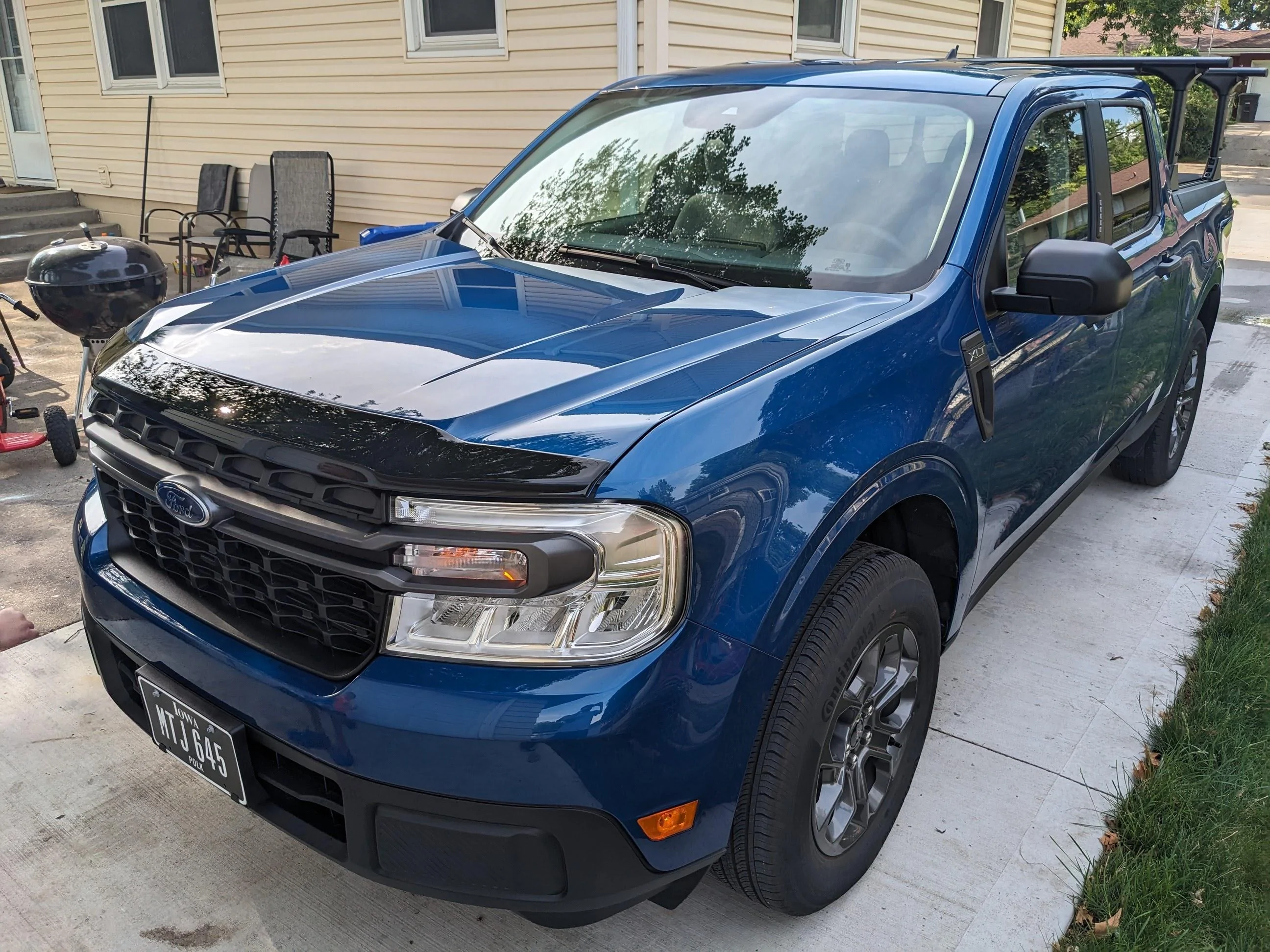

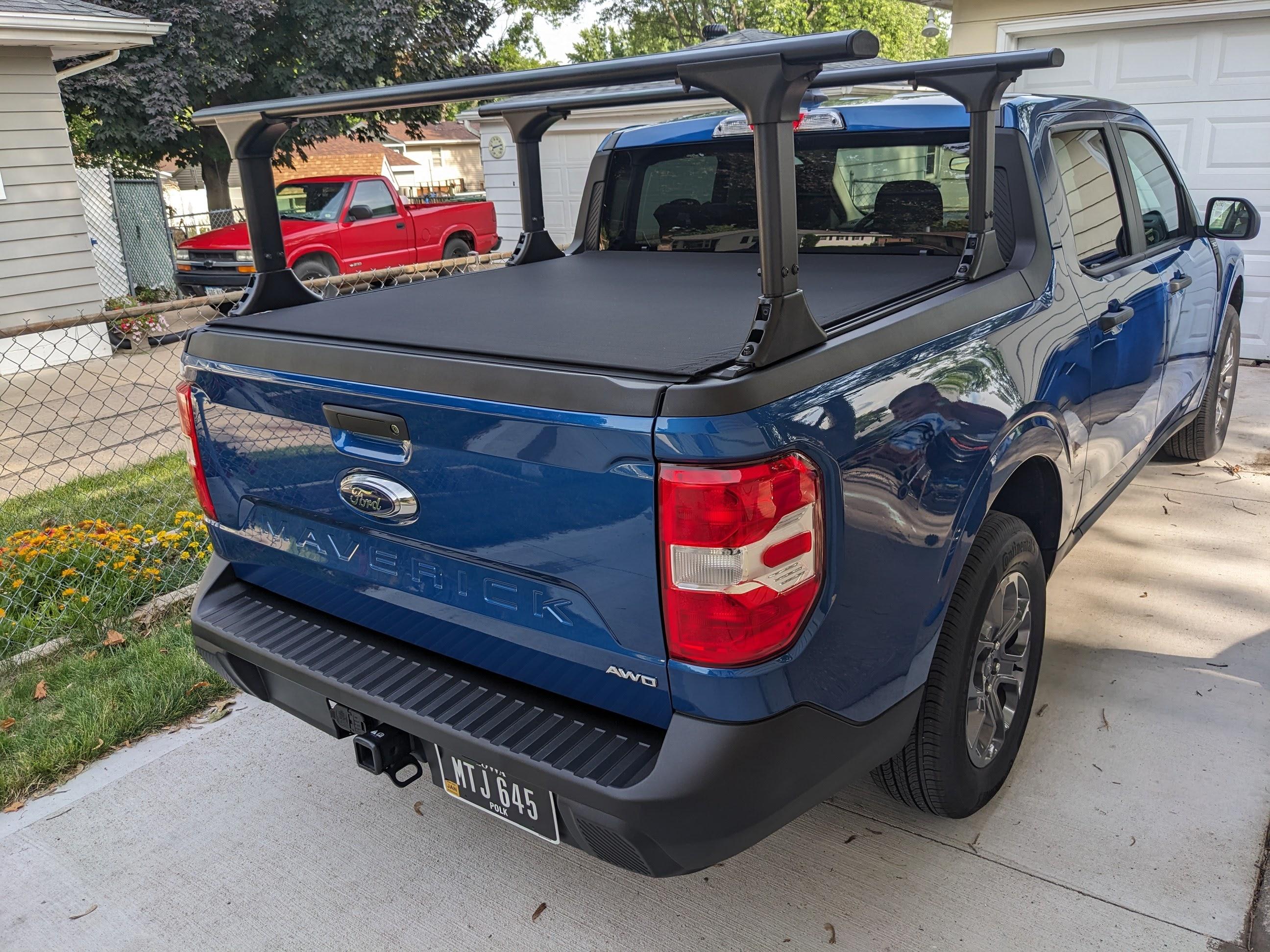

Tom, my apologies. Been crazy busy with work do to the massive snow storms in Iowa. Here are some pictures of my truck. I haven't bought any of the accessories yet. I've been checking ones I'm interested in and found the ubolts are smaller then the crossbars so haven't bought any.
