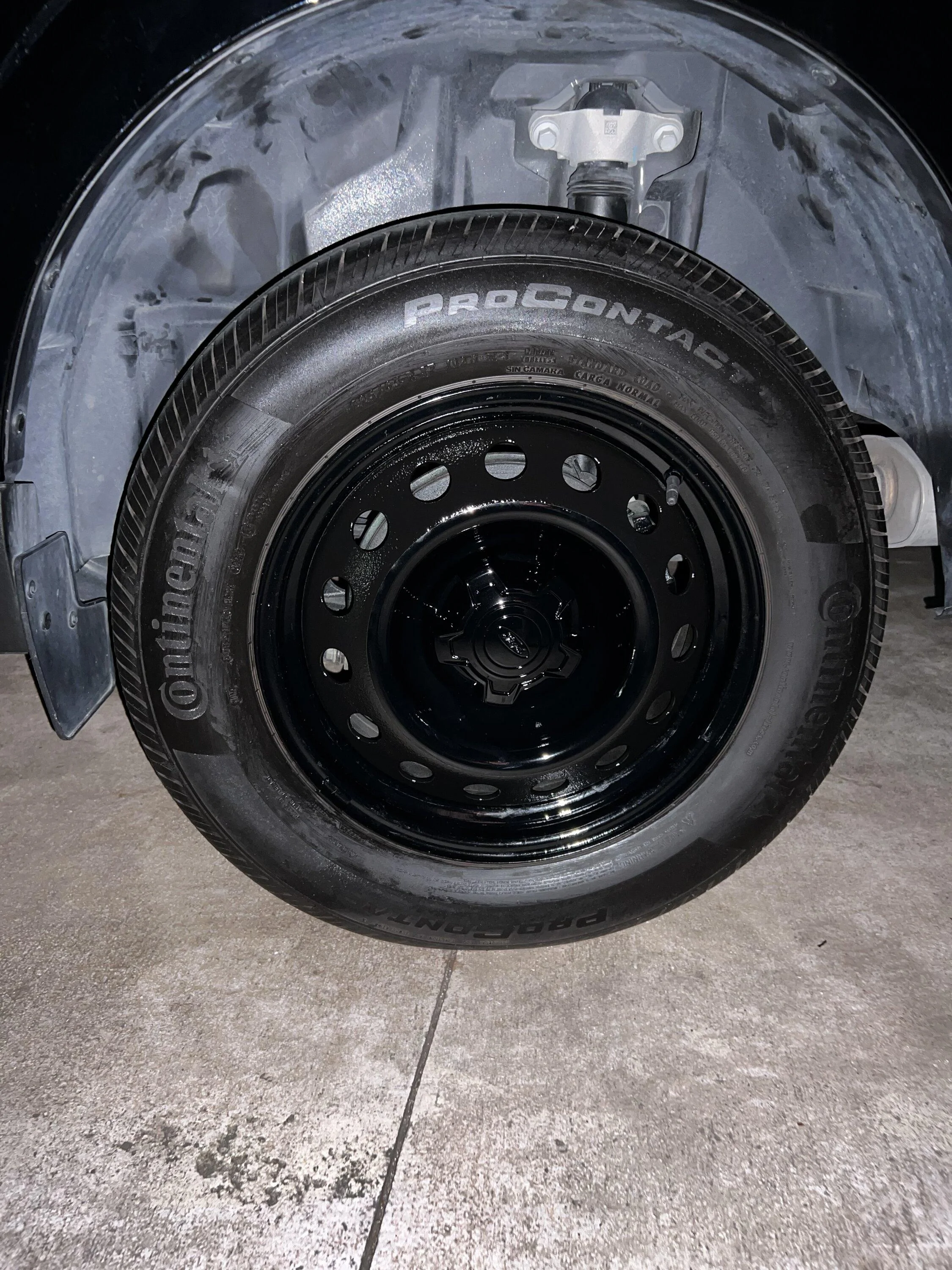

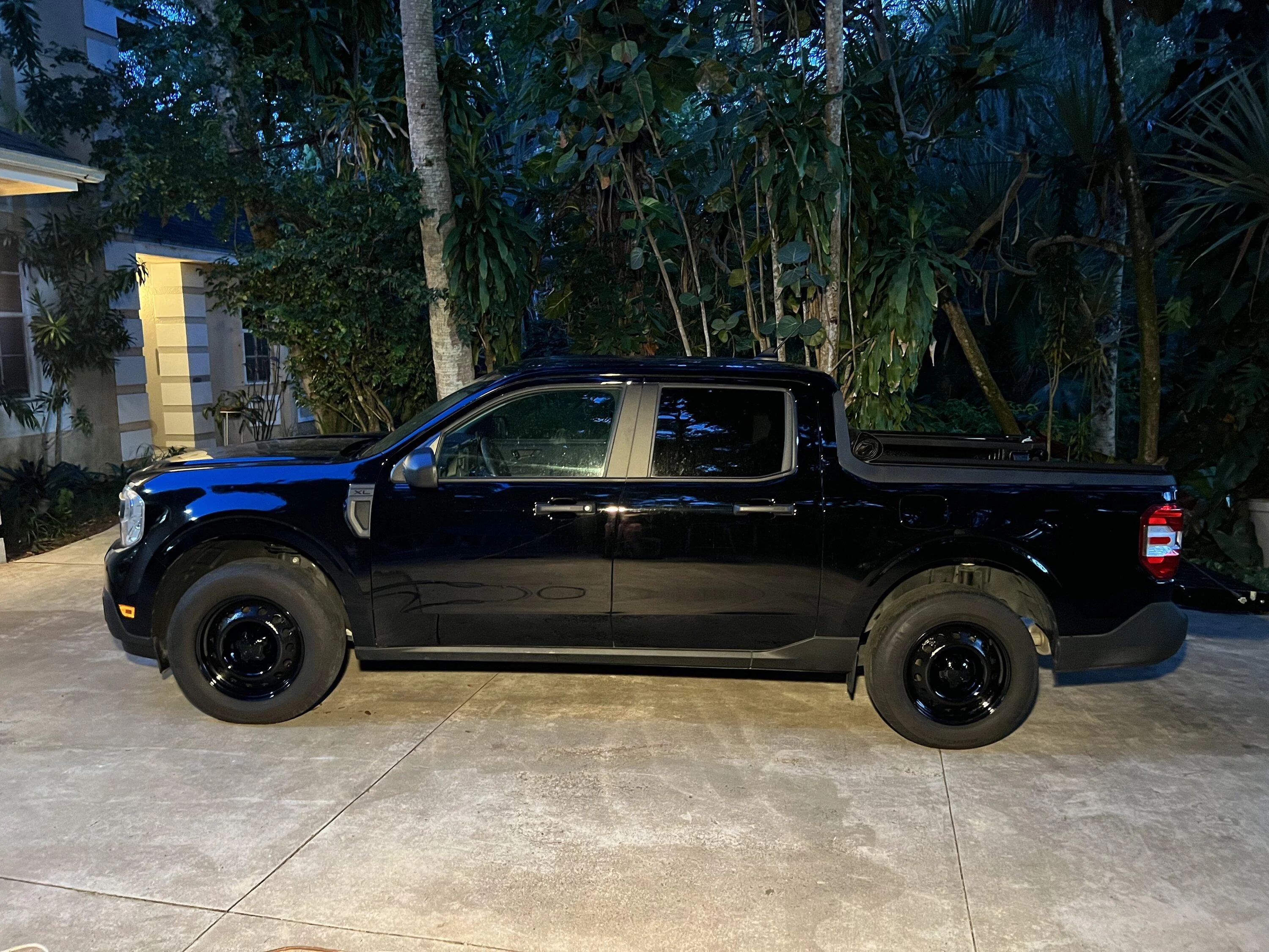

I would paint them completely black, or not at all.
Those early ones were experiments. The final product is all black with a texture ring around the vent holes in an attempt to make them look more rugged:

Yup, I did forget to do it for the 1st coat, but then used plastic shopping bags after that. I read somewhere in this forum about the shopping bags. Just push them through the holes, then spread them out by reaching around the tire &/or by tugging them around with your fingers through the holes. That being said I don’t know if getting some paint on them would do any serious harm to the disk or pads. Probably just scrape off when you hit the brakes for the 1st time. The brake caliper might look odd with overspray on it though.
Some people wedge playing cards between the tire & rim instead of masking tape too. I just masked it with tape. Next time I’ll give that a try, seems like it might be easier.
Thanks Drew.
What paint did you use? I might just use plastidip so if I screw up I can just peel it off.

Thanks Drew.
I used Sherwin Williams ATX refinish paint for the gloss & Dominator (Raptor equivalent) bedliner for the texture ring since I sprayed my truck bed with it at the same time.
https://industrial.sherwin-williams.../vehicle-refinish/color-systems.10656481.html
U. S. Chemical & Plastics Dominator Black Urethane Truck Bed Liner Kit (USC-2000-2)
https://a.co/d/8LIAnRG

Edit… thanks for all the comments! This is the final product. Sherwin Williams Automotive ATX paint color matched to Ford Shadow Black, with texture ring around wheel vent holes of Dominator/Raptor Black Urethane 2-part Bedliner:
I’m looking to improve the look of my steelies… if at all possible! Here’s what I’ve tried so far. More to come…
No doubt that steelies can look good with the proper tire on it. Throw some KO2s and those steelies will look solid!
