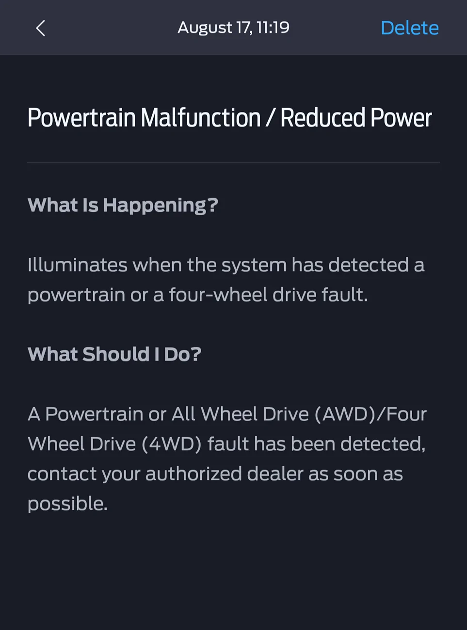

No fault code, just the error message. It was so random. Didn't reduce power to the car or anything. Ford website says my car is in excellent health, so I'm getting mixed signals lol
Ford Maverick Ecoboost- Powertrain Malfunction/Reduced Power - Four-Wheel fault Screenshot_20250818-153518.FordPass
