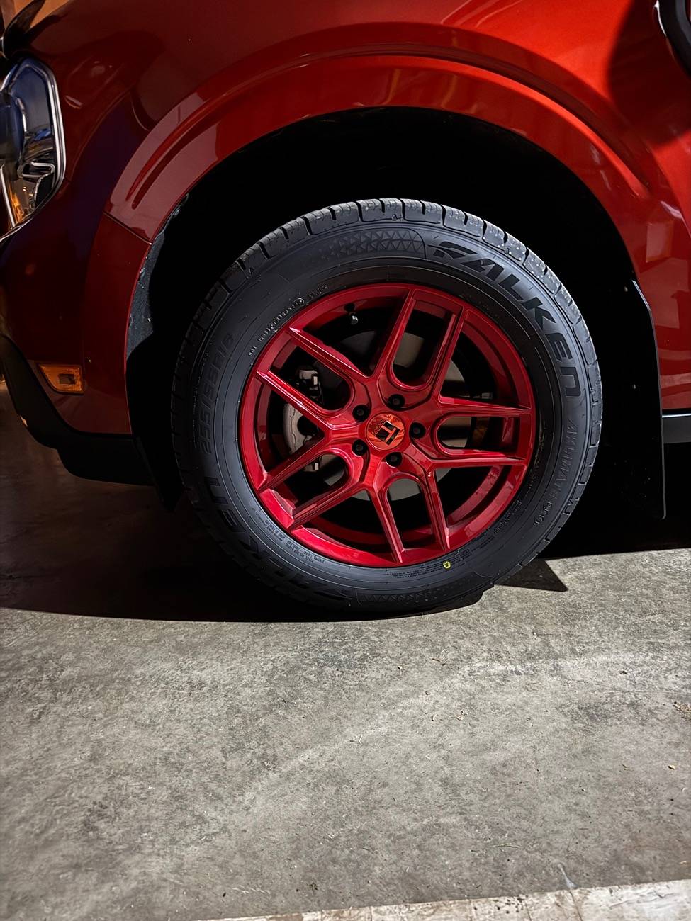

255/55R18 are a “definite fit, never rubs”. It’s nearly identical diameter as the stock tires. Mounted on 18x8 rims with 35mm offset.
Uh, yeah, you can lower it with those. How do I know? I did.
