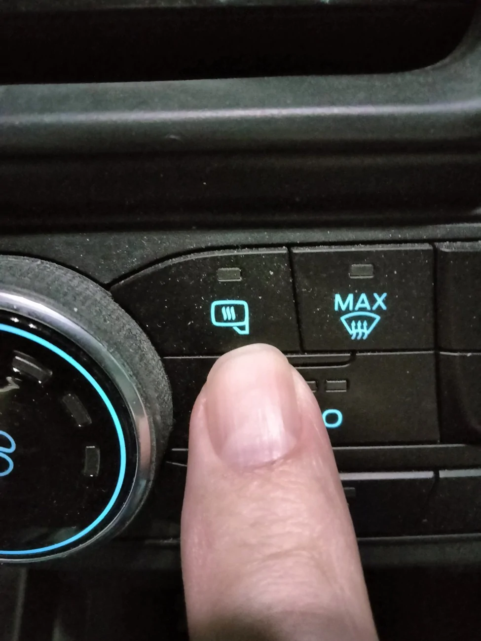

I have a 23 XLT and my heated mirror control is right here 👇🏻 on the heating and air conditioning control panel.

Does your existing switch panel have a heated mirror and/or BLIS buttons?
Isn't your heated mirror button if you have it located on your climate control panel?
