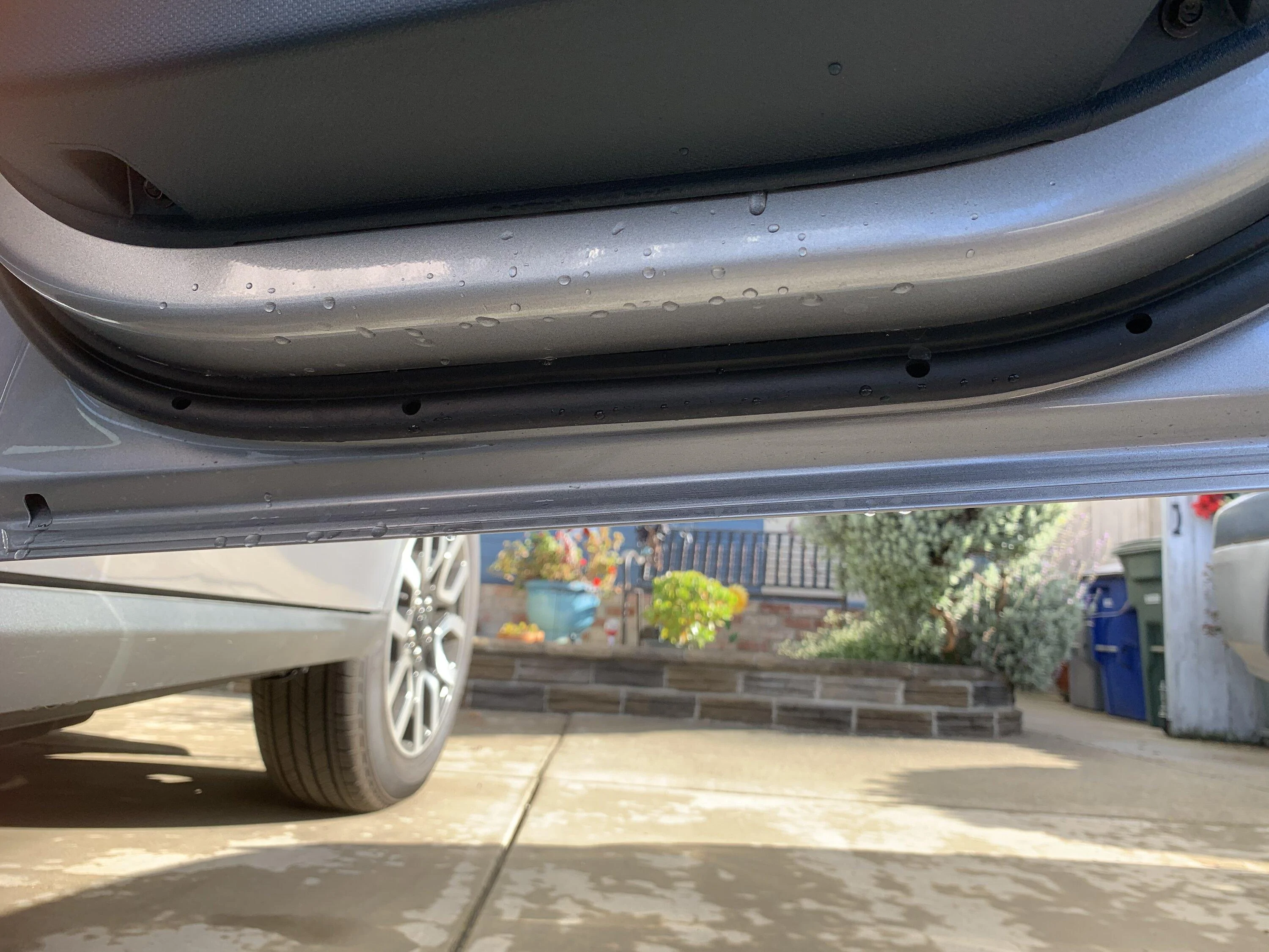

Haven’t noticed this before. Anyone else have this issue? It has rained plenty since I have had it, but yesterday we had rain all day from the hurricane. Not a high water situation.

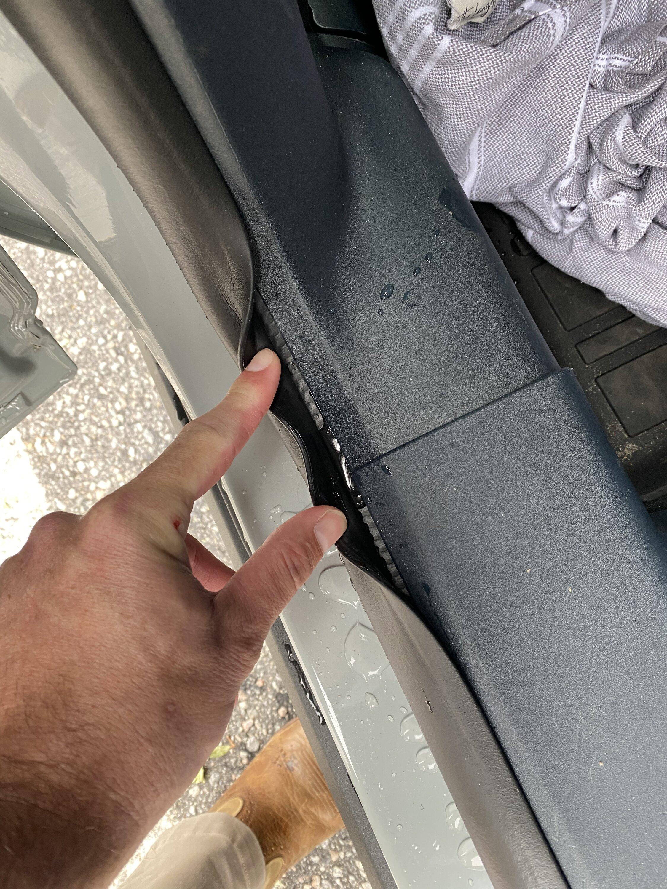

was this ever resolved for you? I just saw this in my 2022, both times after rain storms. The water on mine pools up just forward of the box, between the seal and trim. Mine is on the passenger side rear door.. Any info would be great, thank you.

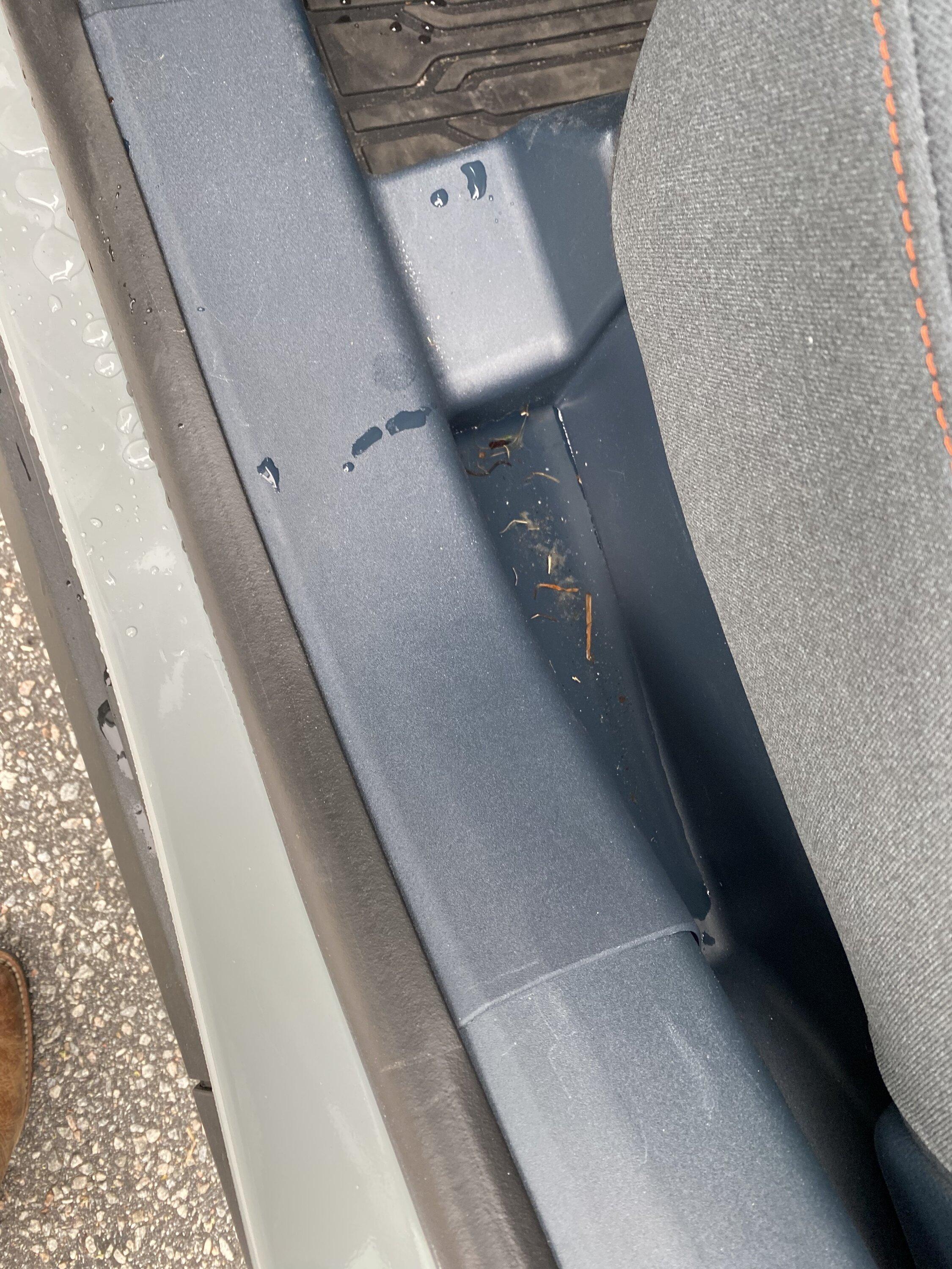

I haven’t been able to make it do it again. I know the door wasn’t open, only thing I can think is one of the door drains was clogged. I have noticed a few times I hear water in the door or see is come out when I open a door after a heavy rain. It’s there until I drive it and it works it way out. This was the only time it made it into the cab.

weird. I'm going into the dealer this week. I will post if they can give me any clue. Lucky we have floor liners as the water in the carpet will develop into a major hassle ..been there.

Went to the dealership today. The shield inside the R/R door was improperly installed, and sealant voided.
Parts in 5 days..
