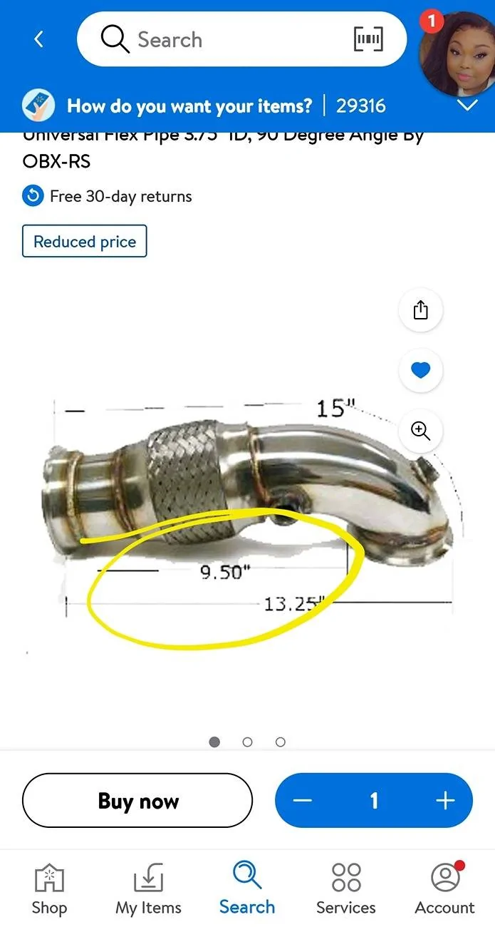

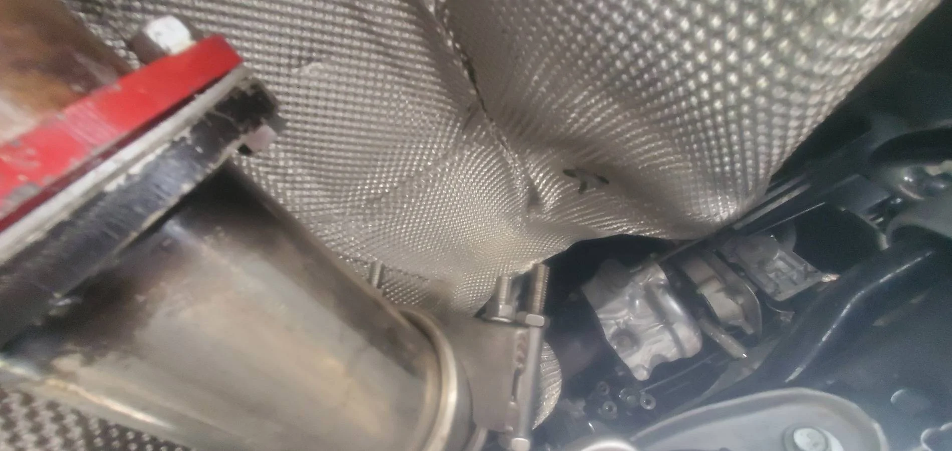

Your measurements have honestly been invaluable. Any chance I could ask you to take the measurement from the bottom edge of the outlet flange to the catback flange (see image). I think I might be on to something but need to confirm a few things.

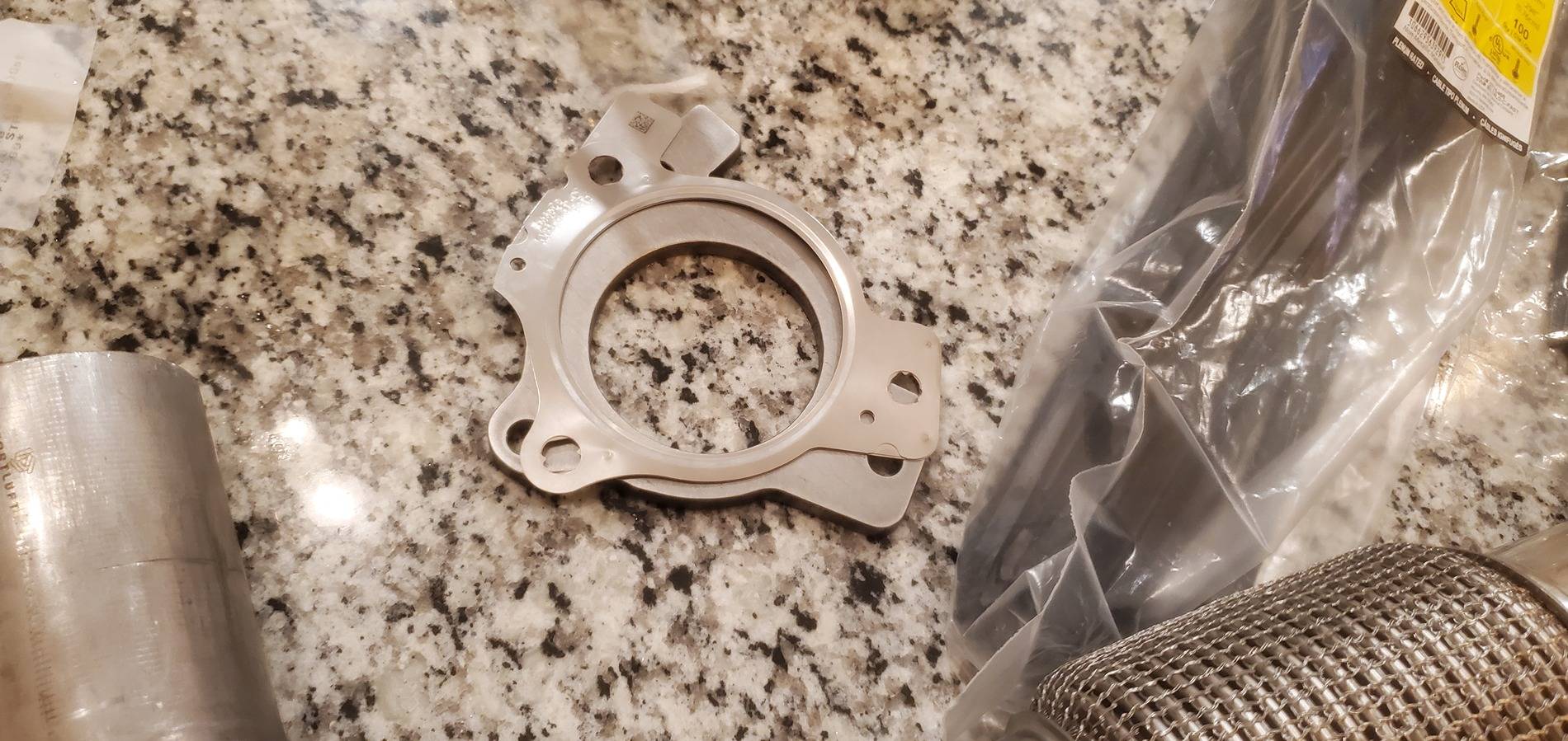

So...been a while since I've posted here so here's an update.

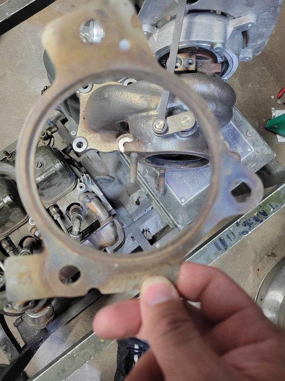

Reverse engineered K03 flange using the gasket. Between material and machine shop labor I'm in that about $150 (there was a k03 flange based off the 20v vw 1.8T for like $50 iirc but it was shipping from Germany and I didn't want to deal with an international return if it wasn't what I needed).

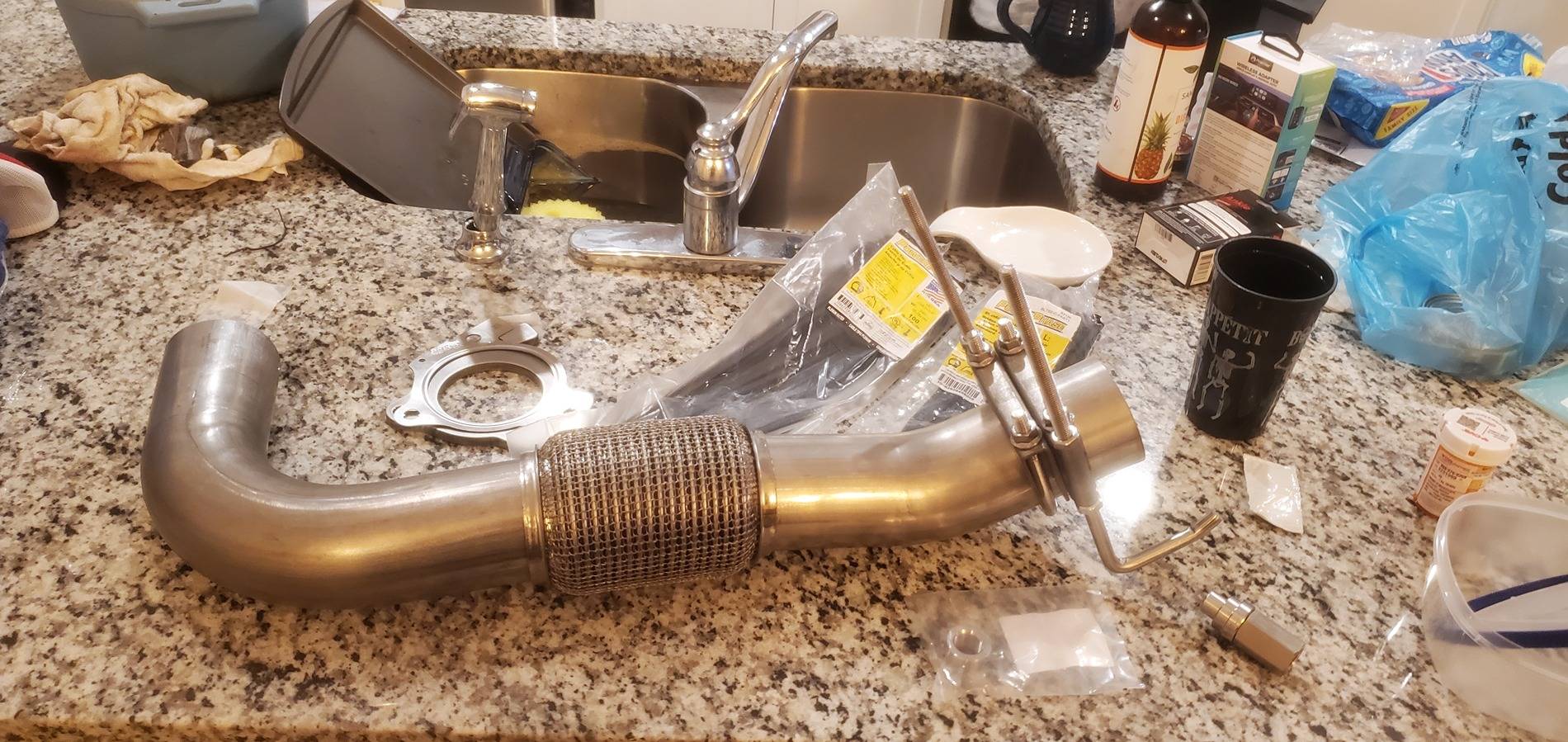

Got everything else besides hangers, 3 bolt flange (not pictured, that's in a Summit order that should arrive tomorrow.) for downpipe via Fortluft to the tune of about $100. No this isn't a final fit. This is just a mock up to get an idea of what we're looking at. I'm also aware that the clamp on hangers might not be the cleanest presentation but I figures being able to fine tune how it hangs without cutting and starting over may be to my benefit. Also splurged for the Super Flex connector so that the build may offer me a bit more forgiveness as far as alignment if need be.
The catback on the other hand is in one piece (it's got a midpipe [in theory], a muffler, and a tip. I'm sticking with calling it a catback). Also I plan on recycling the factory hanger by bolting it to the crossmember in the transmission tunnel.
All said I'm about $500 into my exhaust. I'm pretty happy with how it's turning out.

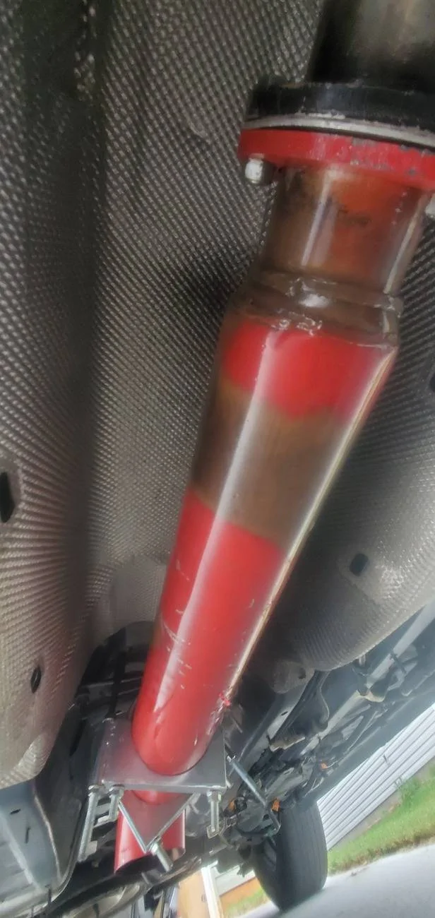

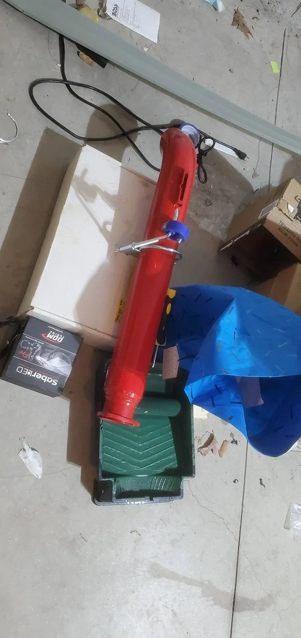

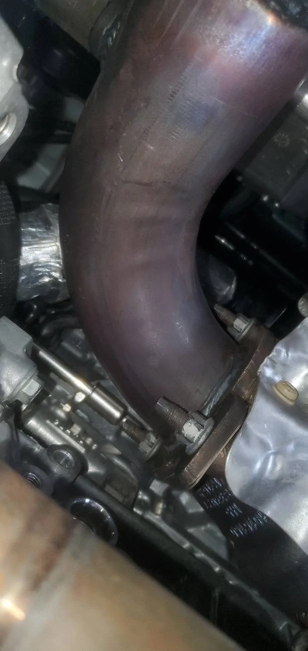

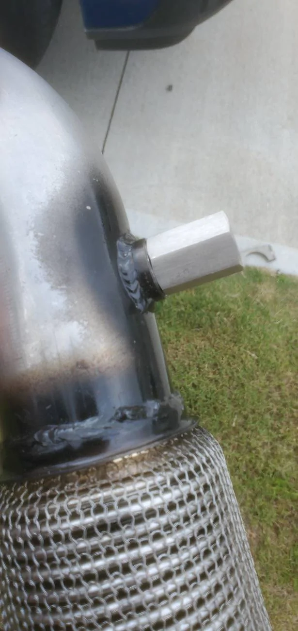

After a few minor headaches and delays, everything is installed. Think there's still some vibration related to how I mounted the glasspack (hangers are perched on the little exhaust tunnel cross member with 3/8" heater hose as isolators) and I'm pretty sure those hot spots are from sitting in traffic (being a single exhaust I don't think there's any effective way to keep the exhaust from slowing down besides maybe wrapping the muffler, and that seems like a big maybe) but otherwise I love it. Will download cold start video soon!
