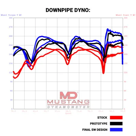

Has anyone actually done a before and after dyno run with a downpipe?
Is anyone seeing any actual gains or just wasting money on these? I know a lot of the other ecoboost see gains but the more recent ones are seeing very little on other vehicles.
Would love to see actual gains from the downpipe. I’m holding off getting one until someone does it.

For what it’s worth, here the stainless works dyno on the Maverick page for their DP.
That is probably stock downpipe and stock tune versus downpipe with tune. Even tuned stock versus tuned aftermarket that seems like a stretch. But given what a tune gains you normally one could get an idea of what it would add.
