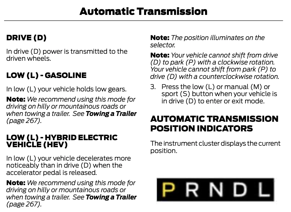

2025 manual matches the above.
So even if they changed the freewheeling or cruise control method - still recommended.
LOW (L)
In low (L) your vehicle holds low gears.
Note: We recommend using this mode for driving on hilly or mountainous roads or when towing a trailer. See Towing a Trailer.
