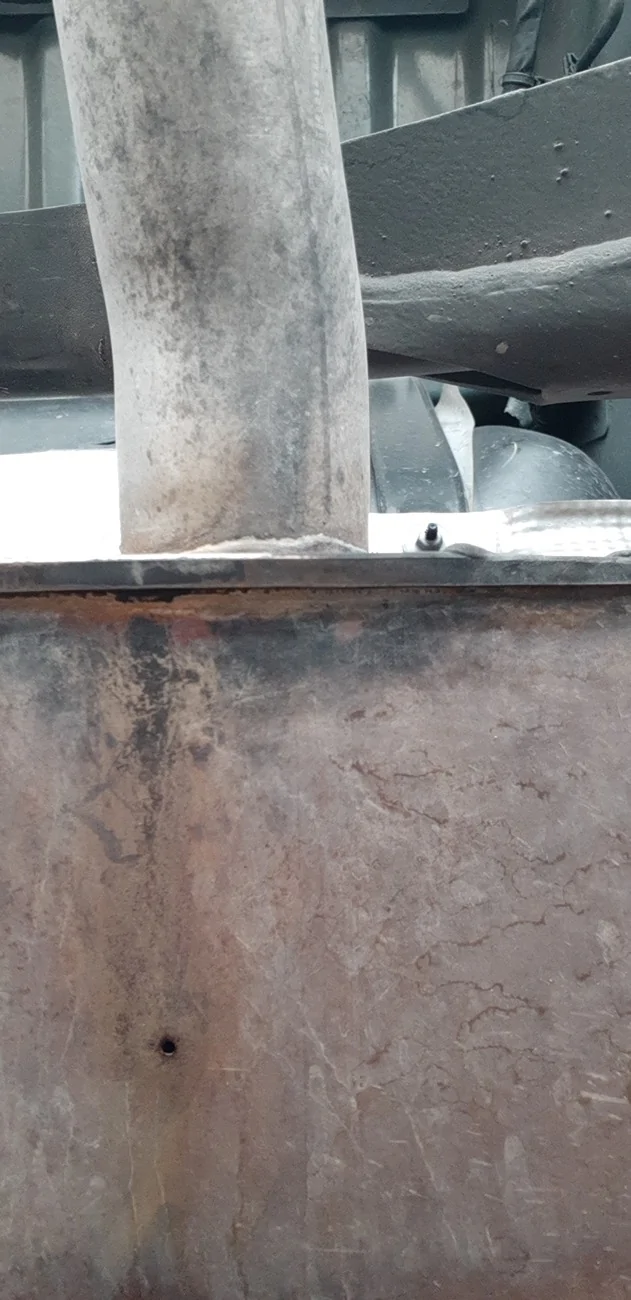

Does anyone know what this liquid is?

Do you have a drop in bed liner, and if so, have you washed your truck lately?
No bed liner. No cats or dogs. Liquid had evaporated couple of hours after I saw it. Best guess is condensation from exhaust system after fairly short trip, even though it was second time I used it today. Thanks

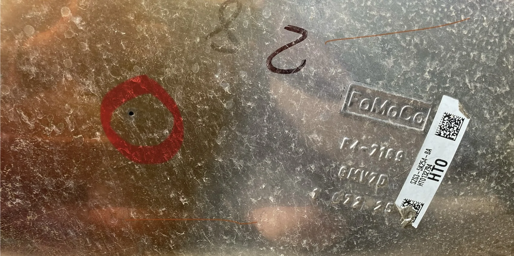

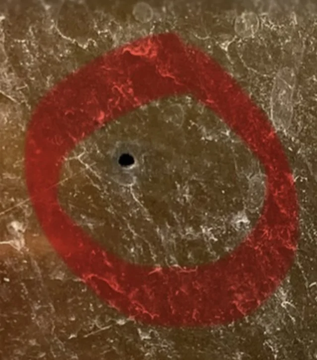

Condensation from the weep hole in the muffler my guess

Will,

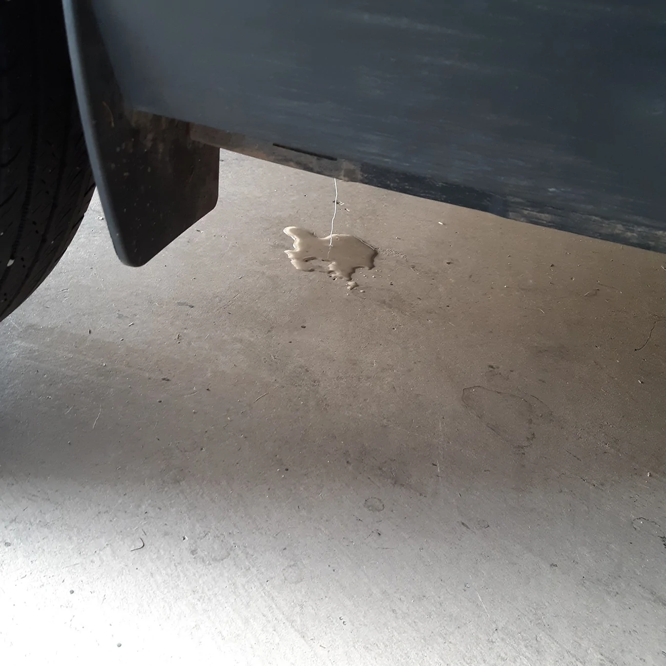

I tried replicating your picture with a piece of wire hanging down from the mufflers weep hole. I also added water.
Bear in mind, water splashes when it hits and also will run depending upon the slope of the surface and texture.

Wow Glen amazing.
Doesn't say a lot for the long life of the muffler if you use the truck on short trips alot where the moisture is not burned off, huh?

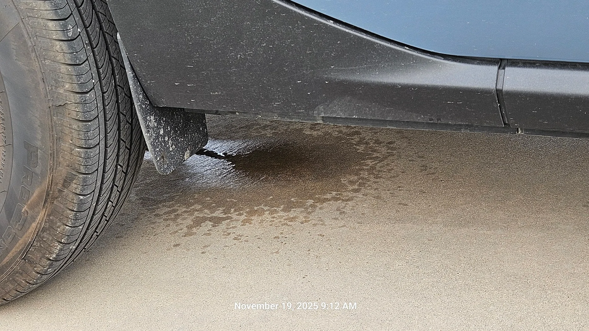

Saw this under the truck (2025 XLT AWD HYBRID 1200 miles). Picture taken in front of right rear tire. I touched, smelled, and tasted the liquid and thought it was water, but it is a dry day here, and truck is garage kept. Does the AC water vent hose run all the way back to under the bed area? Plus lot of water for AC on 50deg morning. Appreciate any insights.

You tasted an unknown liquid by the tire? Do you have a dog? 😆 Hilarious!

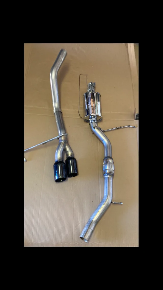

Being that it is a Hybrid, the engine cycles on and off. That produces condensation in the exhaust system more than an ecoboost would. Be glad there is a weep hole to let it out.
