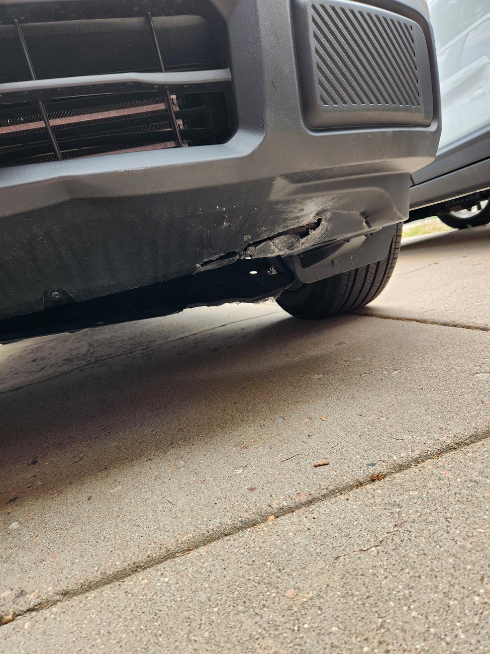

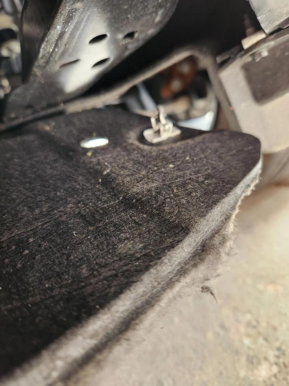

Well, I feel like a boob. Yesterday I climbed under the front of the truck and the lower bumper cover and skid plate are torn up. It's missing several fasteners and was rattling. Looks like someone hit something big.
I didn't notice it when doing a walk around because you really only see it if stand back about 10/15 feet.
Contacted the dealership about it but, of course, they said the vehicle had been inspected prior to me purchasing it and won't do anything.
oh well, lesson learned.
Anyone know a good place to buy a lower bumper cover?
