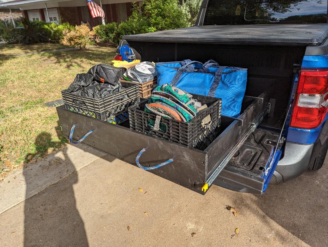

I just finished building my full extension bed drawer for my Maverick Lariat, I will post build instructions and links to supplies below but first a pic of the finished product….
Ford Maverick DIY full extension bed drawer for under $200 IMG_2932
Ford Maverick DIY full extension bed drawer for under $200 IMG_2943
Ford Maverick DIY full extension bed drawer for under $200 IMG_2942
total build time about 8hrs

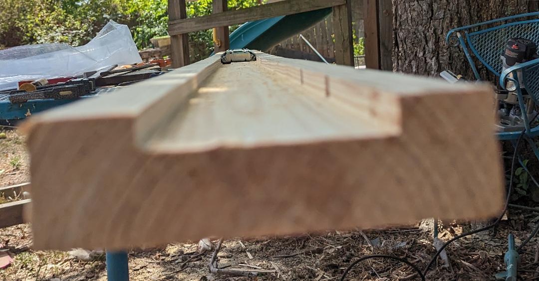

Slide runners
Router or dado out the full length of the 2x6 to inset the runners. Mine were 3in wide and 1/4in deep, 1.5in up from the bottom of the 2x6.
Ford Maverick DIY full extension bed drawer for under $200 IMG_2937
Cut the 2x6 to the length of your drawer slides, I did 48in, keep track of which side is “up”

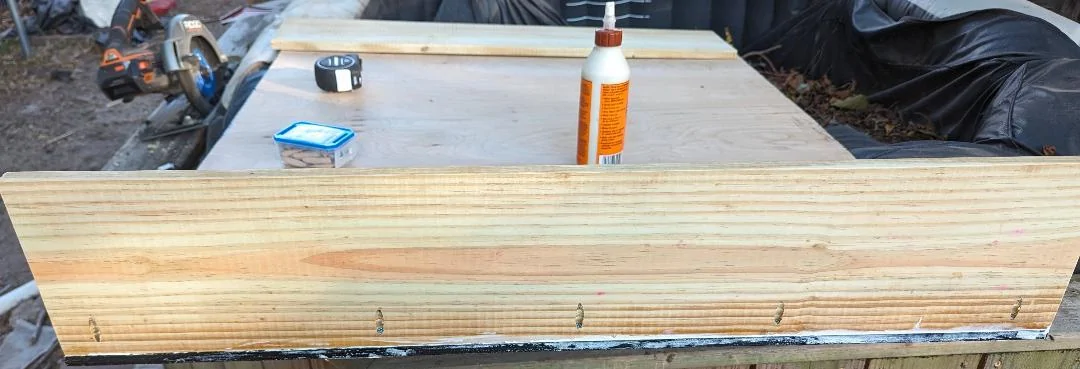

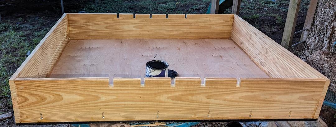

Base
Cut the ply wood to 38.5in x 48in
Cut one 1x6 into 2- 38.5in lengths (for front and back sides)
Cut one 1x6 into 2- approx 46.5in lengths (for the sides of the drawer, length may vary based on the thickness of the front/back wood
Attach sides to the base with wood glue and screws, I used pocket screws with screws from the bottom to strengthen the joints
Ford Maverick DIY full extension bed drawer for under $200 IMG_2935
I added notches on the sides of my drawer to drop in divides cut from the same plywood as the base. I spaced the notches at the front and back to hold my standard milk crates then every 4in between.
Ford Maverick DIY full extension bed drawer for under $200 IMG_2934

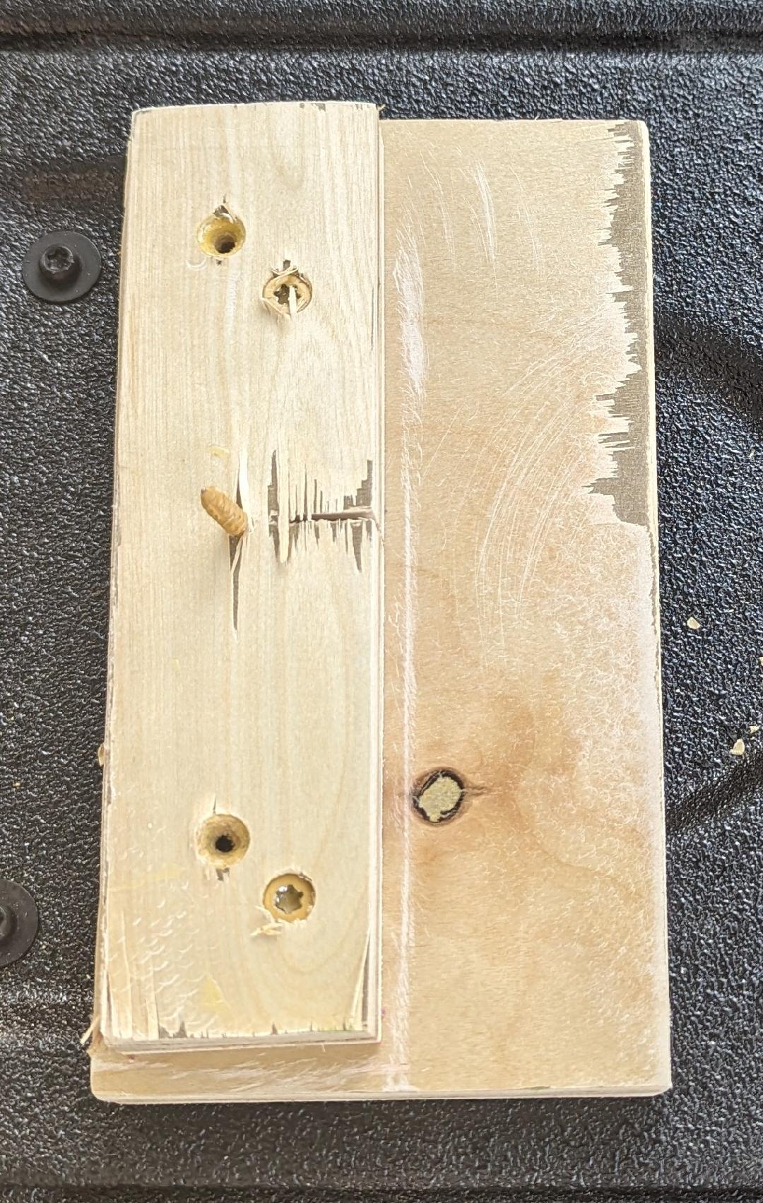

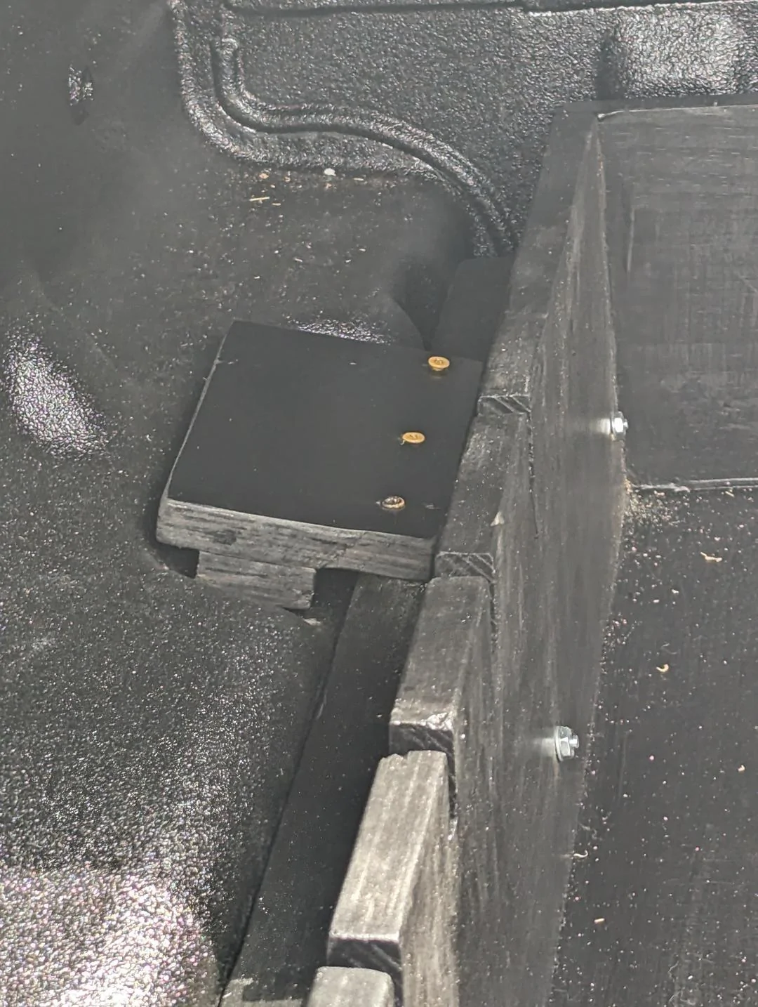

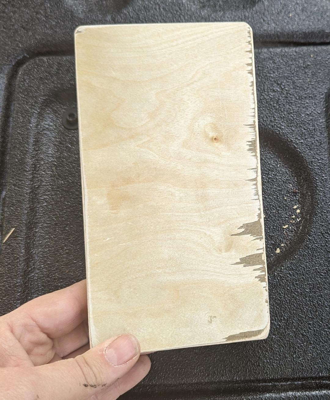

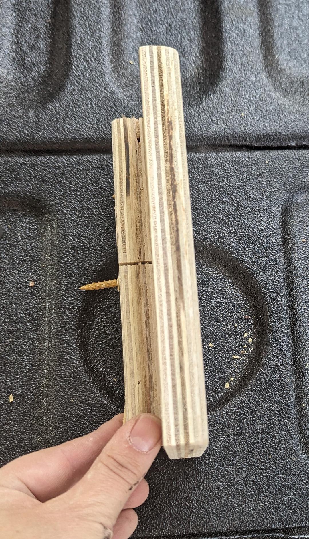

Drawer slide mount brackets
Cut the plywood so it will fit in the 2x8 insets on the wheel wells. You will need two of these, approx 5x7 and 2.5x7.
On the smaller piece, mark where the hole in the wheel well is located, drill a hole and put the t-nut on the bottom, screw 1/4in 2.5in long screw in the from the top.
Attach the small piece to the larger piece from the bottom
Ford Maverick DIY full extension bed drawer for under $200 IMG_2939
Ford Maverick DIY full extension bed drawer for under $200 IMG_2940
Ford Maverick DIY full extension bed drawer for under $200 IMG_2941
(I swapped the random screw for the t-nut and 1/4in bolt but for to get a pic)

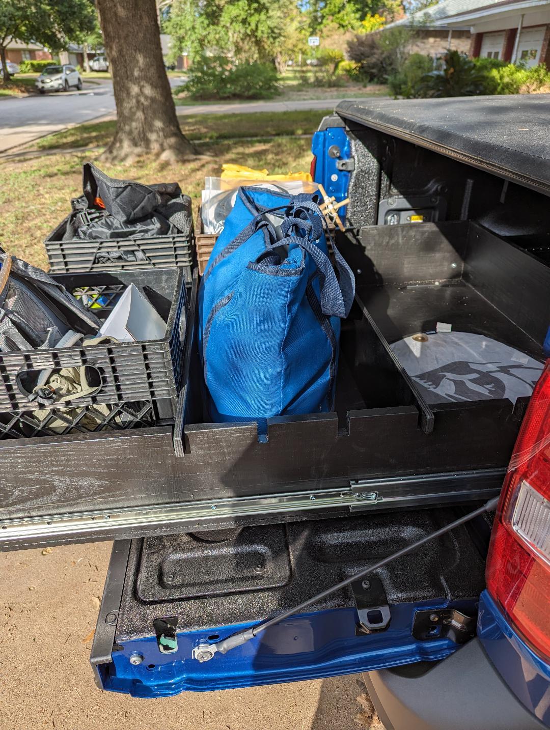

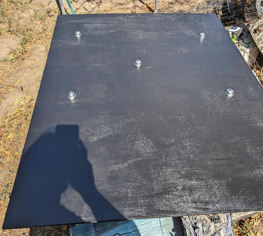

Screw the ball bearing rollers to the bottom of the base towards the back to help support the drawer. Make sure they will hit on the raised parts of the truck bed.
Ford Maverick DIY full extension bed drawer for under $200 IMG_2936

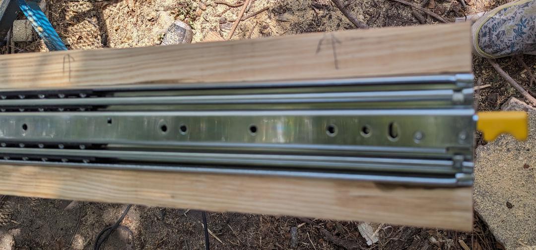

Mount the drawer slides in the 2x6 slots.
I attached the slides to the drawer in the truck bed but if you have a large level area you could probably mount them off the truck

Slide the drawer into the truck bed, once it is where you want it, place the mount brackets on each side with the bolt going into the hole over the wheel. Screw the mounting plate to the 2x6 runner on each side to secure the drawer. You can further secure it with a nut from the wheel well.
Ford Maverick DIY full extension bed drawer for under $200 IMG_2933
For the dividers, I cut 2 pieces of plywood from my original sheet into 40in x 7.25in strips then cut off a 1.5in wide by 6in tall piece on each end so they could drop into the slots.

Nice! Does it drag on the tailgate?

No the ball bearing rollers and the slide mounts through the wheel well keep it from dragging. Mind you I haven't done a heavy load all at the end of the drawer to test that either.

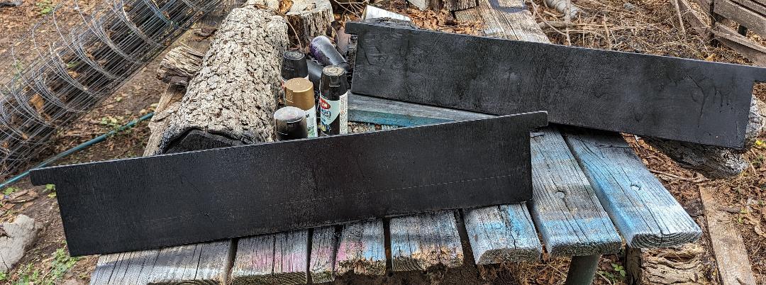

Yes, this is plywood I had laying around in the shed. The sides were 2X4x8 I cut to size.
I scored a RUST-OLEUM Bed Liner Kit at WM clearance isle a while back. It came with everything including rollers to apply it with.
Ford Maverick DIY full extension bed drawer for under $200 20220625_125211
Here is the before picture of the base.
Ford Maverick DIY full extension bed drawer for under $200 20220625_124314
As you can see, it is water stained so I'm really glad I scored that bed liner.

Slide runners

Base
Paint all the wood to help with weather proofing
