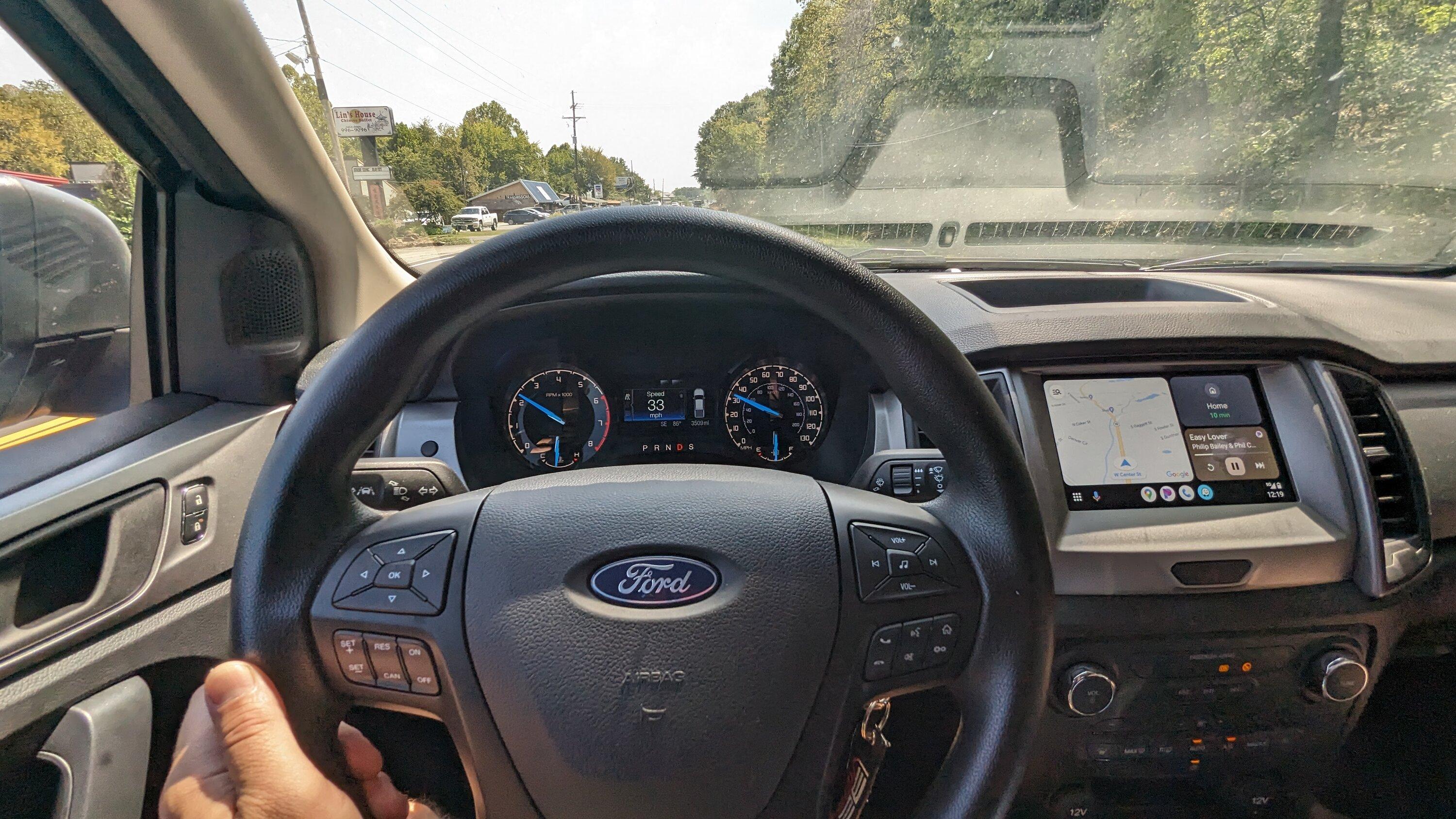

Those cluster lights are not at full brightness. If the adjustment is full, then there is something wrong. Headlights in Auto mode? Not "On"? Take it to the dealer to sort out if nothing else suggested above helps. The instruments and the screen should be much brighter.
Everything is full bright... No dealer is touching it considering dealerships ask for my help to solve bigger problems.
My concern is what's already widely known... Not sure why you're doubting me. The lighting differences on the steering wheel between both pictures should give a better reference. The headlights nor auto lights not being displayed on the dash should be an indication to the lights not being on.

You are asking for advice. We are giving it. I'm not doubting anything you are saying. It is not a widely known issue. My screen is more than bright enough, even when wearing sunglasses. The photo you put up makes it look like the instrument panel is not at full bright. Mine are much brighter. Have you tried the soft reset on the infotainment? Like I said, if nothing else, there is a problem and the dealer should fix it.
