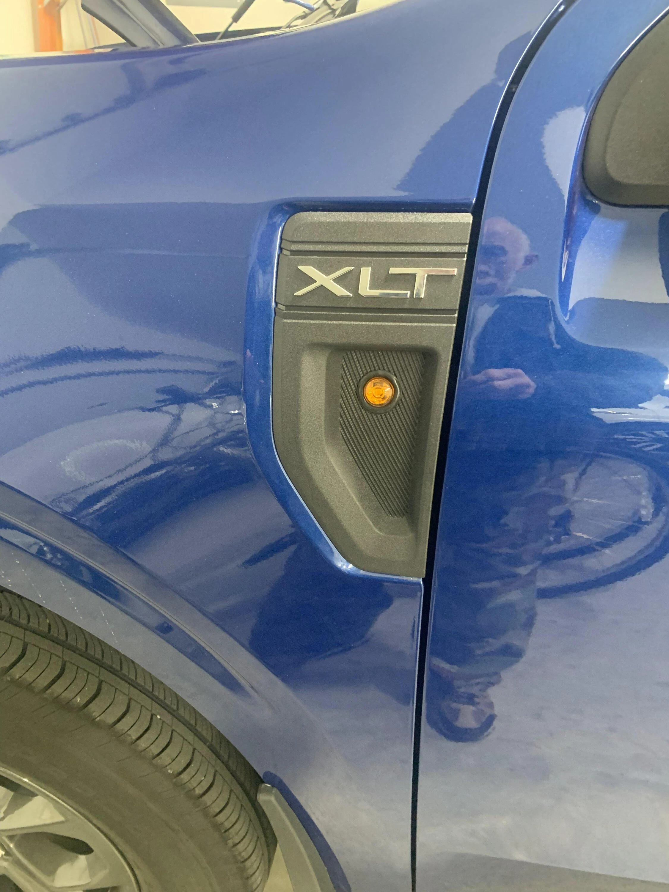

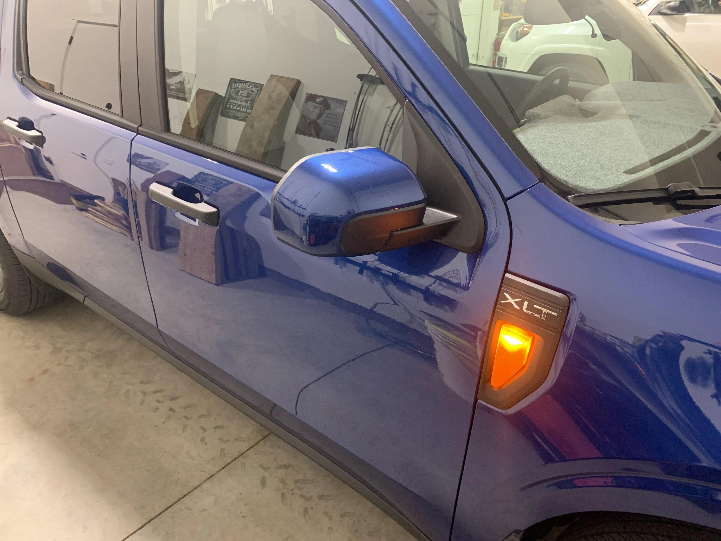

1. Side marker and turn signals. One of my favorite and look nice!

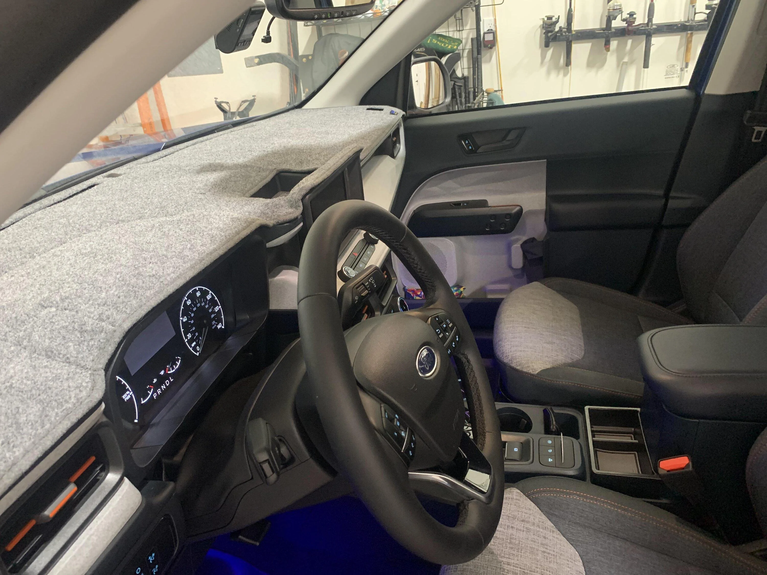

6. Dash mat. Keeps it much cooler in hot summer heat and fits very well. Bought this from local FORD dealer.

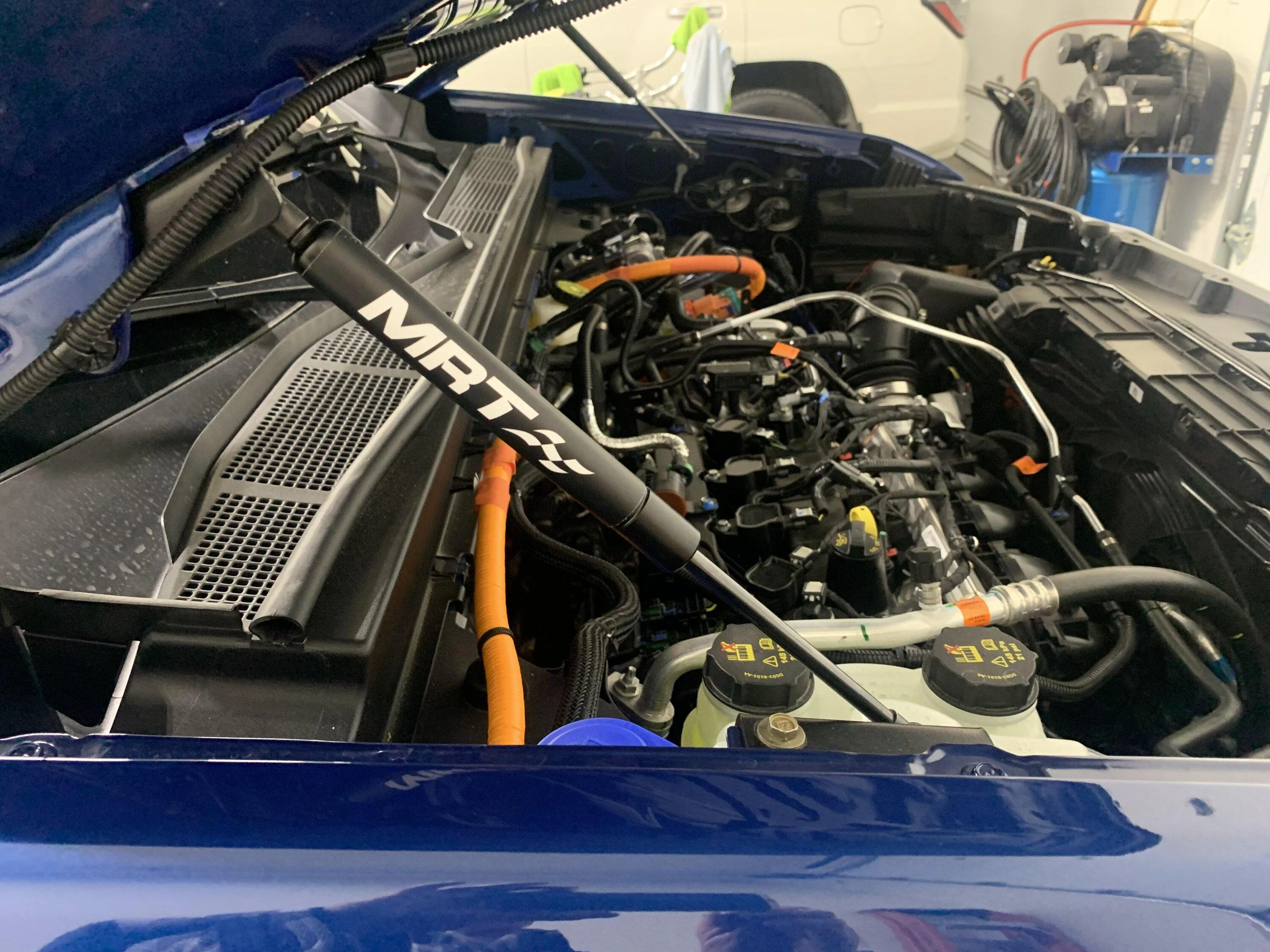

7. MRT Hood struts. Like them, they work just fine... but, the hood is about 5 inches lower and can be a head knocker. Not sur I will keep them, the rod was ok.

9. Husky floor mats! Love them, have had them in all my vehicles since around 1994. Pretty blue sill plates for all doors. Put in my own accent lights, fron and back footwell area's so wife and I can see when we drop crap on the floor. These, or something similar should be stock from the factory.

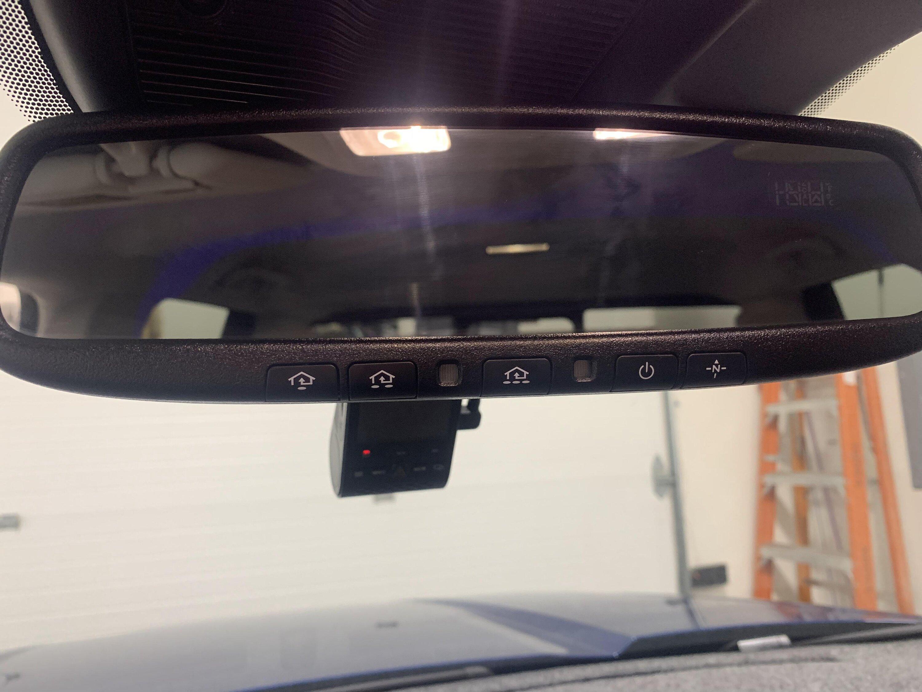

10. Kia mirror install! Another one of my favorites as I hate those garage door remotes that end up under the seat after falling off the visor!
VIOFO dash cam install. Took it out of my Tundra.

Hi, Do you have a link or can tell us where you bought the side marker turn signal lights?
First Sergeant
First Sergeant
Jan 2, 2024
836
1,056
Fruitland Idaho
Started with pulling the XLT piece off the truck. Use something, tape is hat I used or a piece of foam so you don't scratch the paint. Pops off pretty easy, just go slow and careful. In then drilled a small hole to accommodate these small LED bulbs. I ran with these on truck for a few days waiting for the lenses. I used heavy duty 3M double sided tape and put as much on each lens as the space would allow. Speed limit here is 80 and no problems. Here are the links:
https://www.amazon.com/dp/B096J2T74...7&peakEvent=4&dealEvent=1&language=en-US&th=1
https://www.etsy.com/listing/1375201097/diy-fender-light-lenses-covers-for-the
The "kid" making these is "Tad". Uses a 3d printer and they are pretty nice. Took a few extra days to get them as I ordered during the holidays and he was enjoying some off time then, but not a huge delay, maybe 2-3 weeks. I'll bet faster delivery now maybe. He was quick about returning emails. Good luck.

Hi Jason! I got my mirror about a month ago from Brogdens Ford in Olathe Kansas. Parts department, talked to a guy called "FISH". (913) 390-6800. It was about $23 bucks but the shipping was extra, I think $24. All total under $50 Nice guy there said he had about 8 of them just sitting on a shelf. Hope this helps you out!
Thanks, Sarge! Called and talked to 'Mike Hess' who says "We're gettin' calls from all over about this mirror and they're goin' fast!"
Hey Dean, I need to watch my spelling as this site changes things for you whether you like it or not. The guy who has those lens side markers name is TY, not Tad. Let me know if you need any other info.

Thanks for the info. Btw I called FISH on Monday and ordered the mirror. Thanks again.

Hey Top!
Did you make your own wiring harnesses for those LEDs in the side markers?
I think I know how you pieced them together. Could you post a picture of the backside of the side markers?
thank you
First Sergeant
First Sergeant
Jan 2, 2024
836
1,056
Fruitland Idaho
Hey Top!
thank you
Yes, just had a roll of triple wire with a black and a red and a yellow. Butt splice onto the three wires off the led side markers. Made sure to use waterproof connectors, the kind you melt with my bbq lighter. I put it all together on my work bench, then installed back into the cavity on the truck. Make sure you have enough length to get to where you are hooking up to. I attached wires to ground on frame area, you can see a couple blue ring connector ends in the photo. Ford has a bundle of grounds on these two spots, so good enough for us also! I ran the red hot wire down to the drivers side marker so the side markers are working whenever park or headlights are on. The yellow, I ran to the blinker. Double check this wiring document I sent. I got it off this site and I can't remember if it is the correct one, but I think it is. Maybe someone else can chime in. I went out and looked at my wiring, but it is all covered up and sealed, so can't see which wire on turn signal light I hooked to. If you do like I did and use the side marker light it is easy. Pop that side marker off with plastic tool (put tape or sponge or something against paint so you don't scratch it. That marker should be pried from the drivers (the back rear side) side of it, not the curved portion. The curved portion sets in a groove. Comes out pretty easy. Also, when you drill hole for the LED, don't get too close to the top edge because if you do you will have to enlarge the hole on the back of the new lens cover so it will fit over it. I had to do that with my dremel. Not hard to do but would have been easier to just have drilled the hole a tad lower so lens just fit over it. When you get the lens you will see what I mean. I had the hole drilled before I got the lens is where I made that mistake, but no big deal to correct by widening out the back of the new lens.

Please be aware that wiring for these lights is different for the Lariat.
