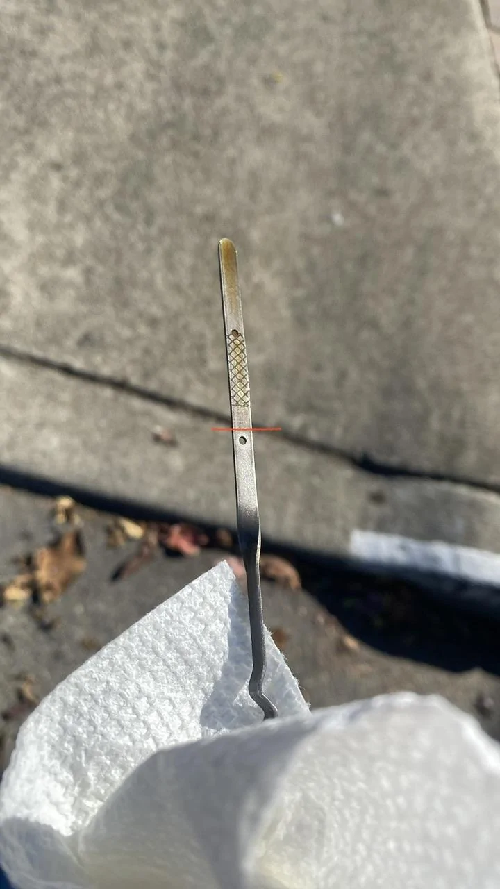

My dealer added too much oil.
I thought it would be easy to suck some out via the dipstick tube but the process wouldn't work. At all. Any ideas other than remove the drain plug a few revolutions and let it drip out the bottom?
I had 0.25" O.D. 0.17" I.D. Tube and syringe. Tight seal on syringe. Nothing would come up but dipstick is high. Dipstick is up to my fingernail. I used a hose a little longer than the dipstick
Yes I planned to suck out 16 to 24 syringe fulls whatever it took since I already had the materials, If it avoided me having to get under the truck.
Any ideas why this isn't working?

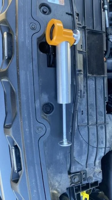

I ordered the Blackstone Hand powered Vacuum pump. It worked well first try.
I removed 28 ounces of oil by filling the 3 oz little sample tube not quite full 10 times and poured it into a larger container. Got the oil to just barely below the second hole. I ran 1 quart over filled from the dealer for about 500 miles. Stop n Go. So the engine was off for half of that, and any foam or bubbles probably had time to settle.
