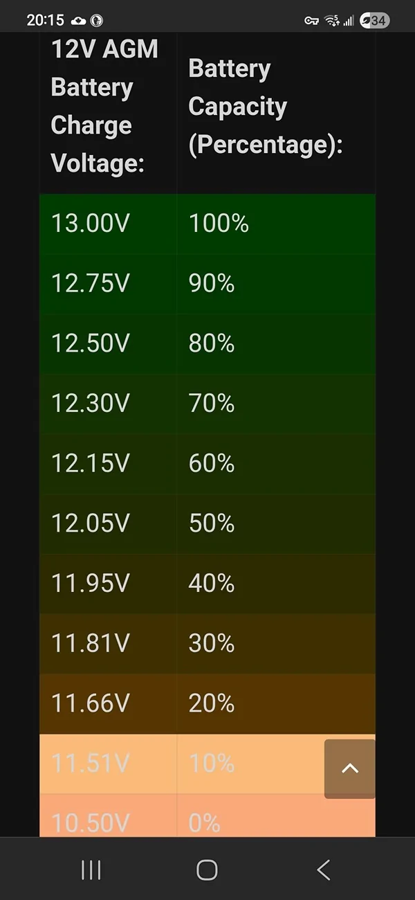

Here is a handy 12 volt AGM battery charge sheet for reference.
Ford Maverick Dead battery, can't unlock Screenshot_20260514_201517_DuckDuckGo
