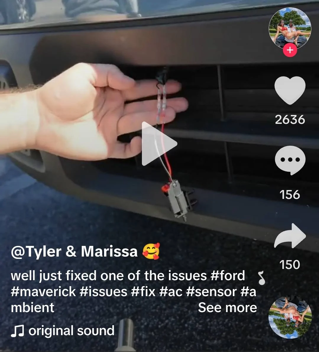

The temperature sensor is on the black box at the top of the windshield. So it is reading the temperature of the glass not air temperature. As you drive it will come down due to thermal cooling. Is it a major concern? Or just an annoyance?
Thats odd.
Are you sure?
Mine is behind the lower grille.
Always in the shade.
Will pick up some blacktop heat standing still but is nuts on accurate when the vehicle is in motion.
