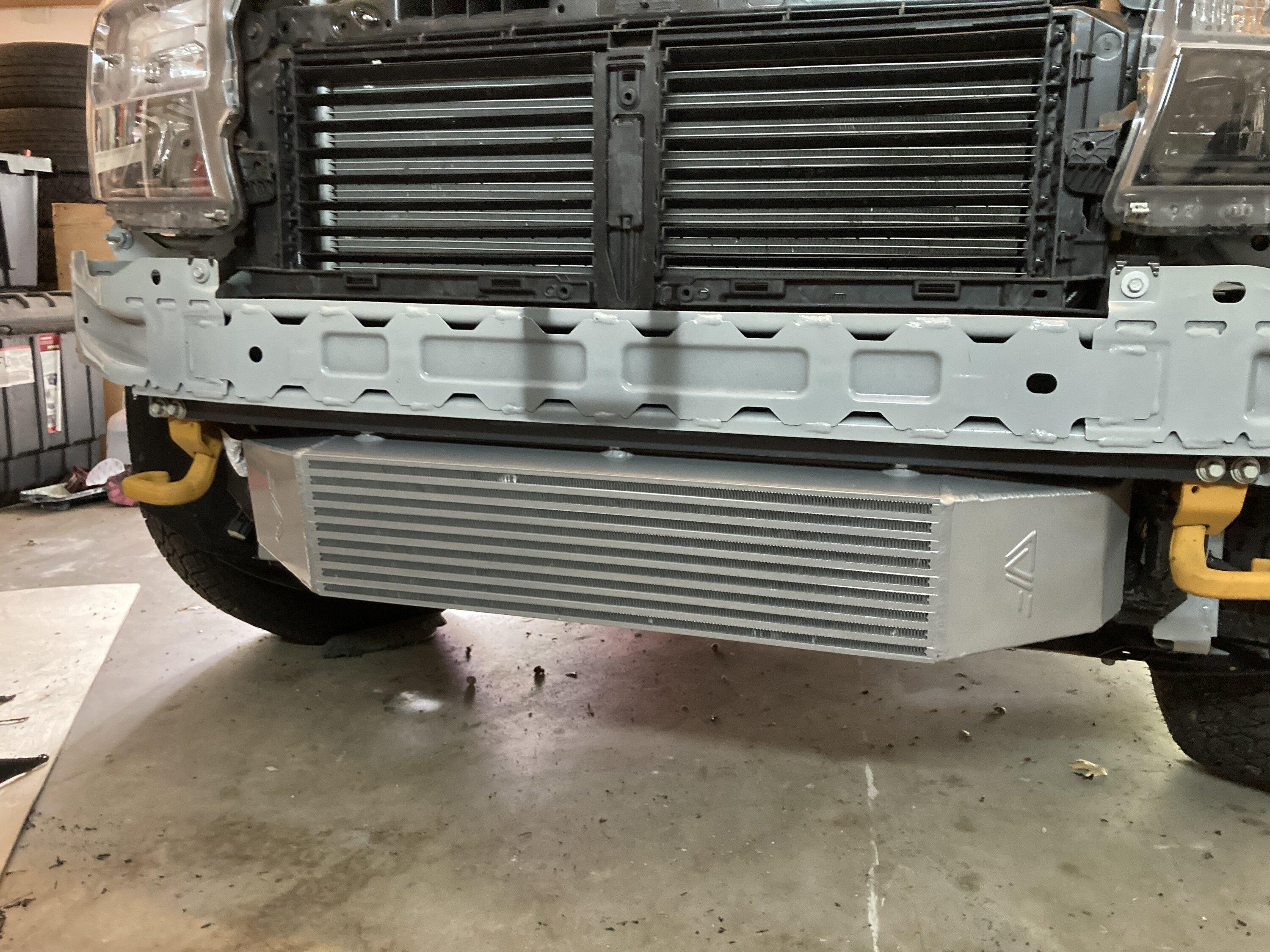

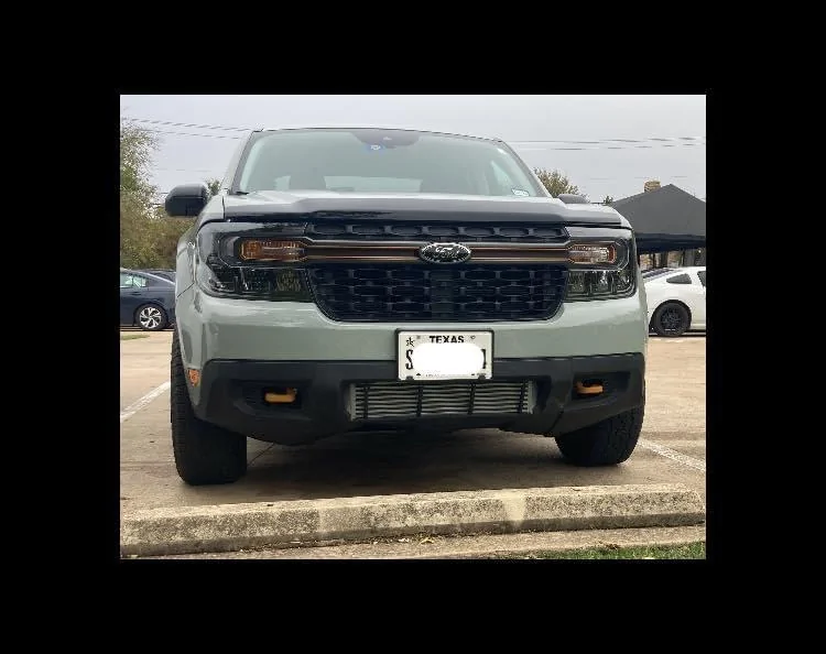

Hi all!
I made a YouTube video because there were too many tips to cover just in a simple thread I did this install without removing the crash bar under the bumper (Buschur removed that in his thread). I would budget about six hours (maybe less) to complete this. Because I did it on the tremor there were some extra cutting / fitting of the bumper cover. Still to-do not included on this is:
I’m going to add about 2 inches to the front of the steel skid plate and some captive bolts because the factory bolts arent Great.
Disclaimer My editing on youtube wasnt great(shot on my iphone) and might void warranty? Check with your dealership.
Note:I said torx t27 but the correct one is a t30.
Let me know what you think.
Thanks!

Is it just me or does this last picture look like a MAC Truck? :cool:

maybe a tip, cut the plastic before permanently mounting the intercooler.
