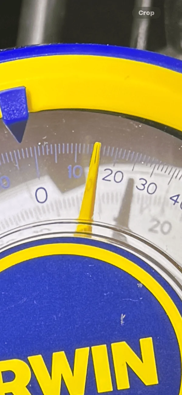

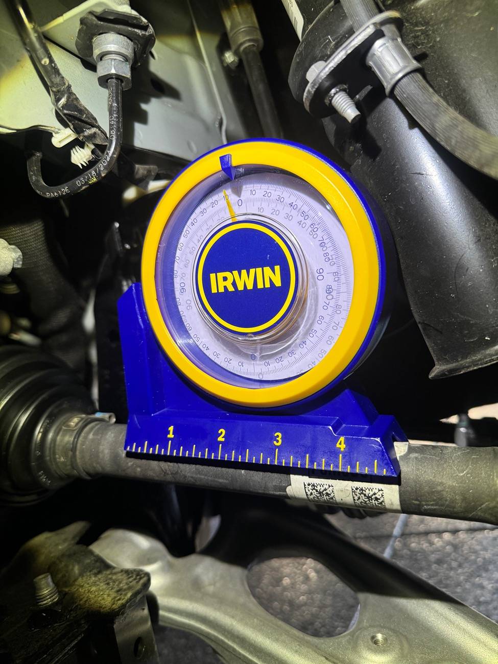

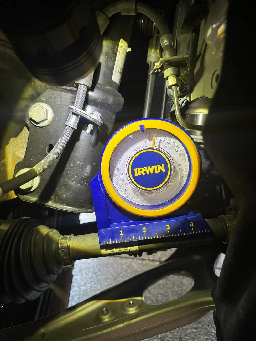

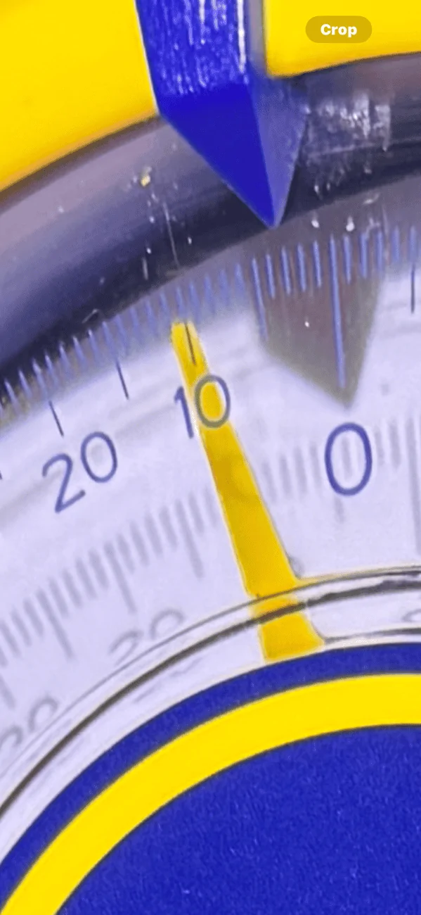

Interestingly enough, like so many others have said, it was much more pronounced on the passenger side.
Right axle half shaft is shorter and angle is steeper.
with Rough Country 2” spacer lift, my left axle is 10.5 degrees.
Ford Maverick CV Axle Issue / Failure Question IMG_1019
the right axle angle is 15 degrees.
