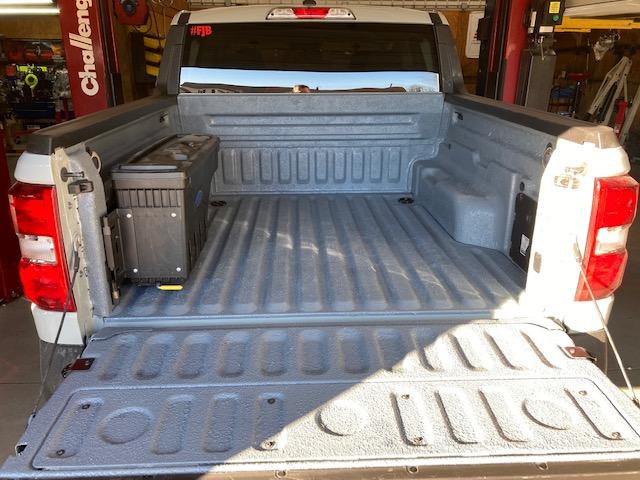

The last bedliner I had done was from Line X and I'd never use that product again, no anti-slide properties and I'd say thin material. I built an overlanding trailer and gave it two coats of bed liner (I hate rust), I used Herculiner on it. Super impressed with the product. I ordered a can of their Grey and it matches the cactus grey on the truck well enough that I'm really super happy. Prep is the key, took an hour or so sand the entire bed of the truck, I used an electric sander and 120 grit paper. Two thick coats were applied and I'd say total time invested is under 4 hours. Very thick, really grippy product. While I was in there I installed the drivers side tool box, it's from Ford but I've bought the identical product from Amazon.

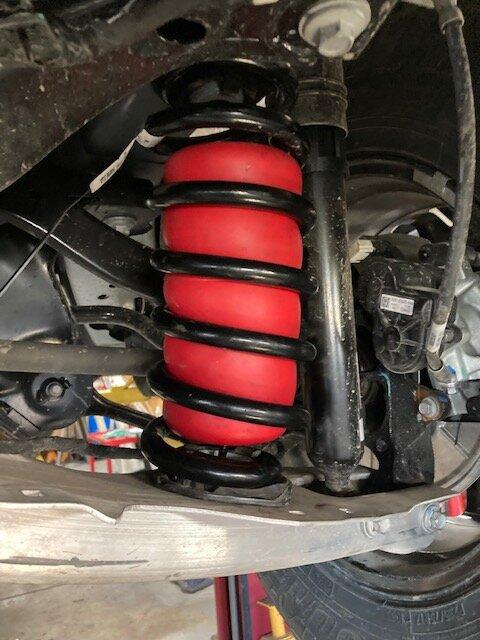

Putting my overlanding trailer on the truck had it squating quite a bit, makes driving it not enjoyable. The trailer only weighs about 3,000 pounds but as anyone knows you want the weight on the nose to make them pull nice and straight. I can't stand a vehicle that squats when loaded, handling and braking are highly effected.

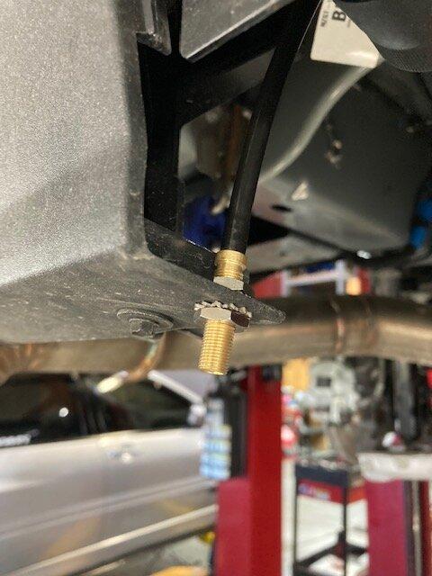

This is the second set of air bags I've ordered, these actually kit nice. I ran a single line to the rear, left them with about 10 psi in them. I'll have to get the trailer hooked back up and give it a proper test.
