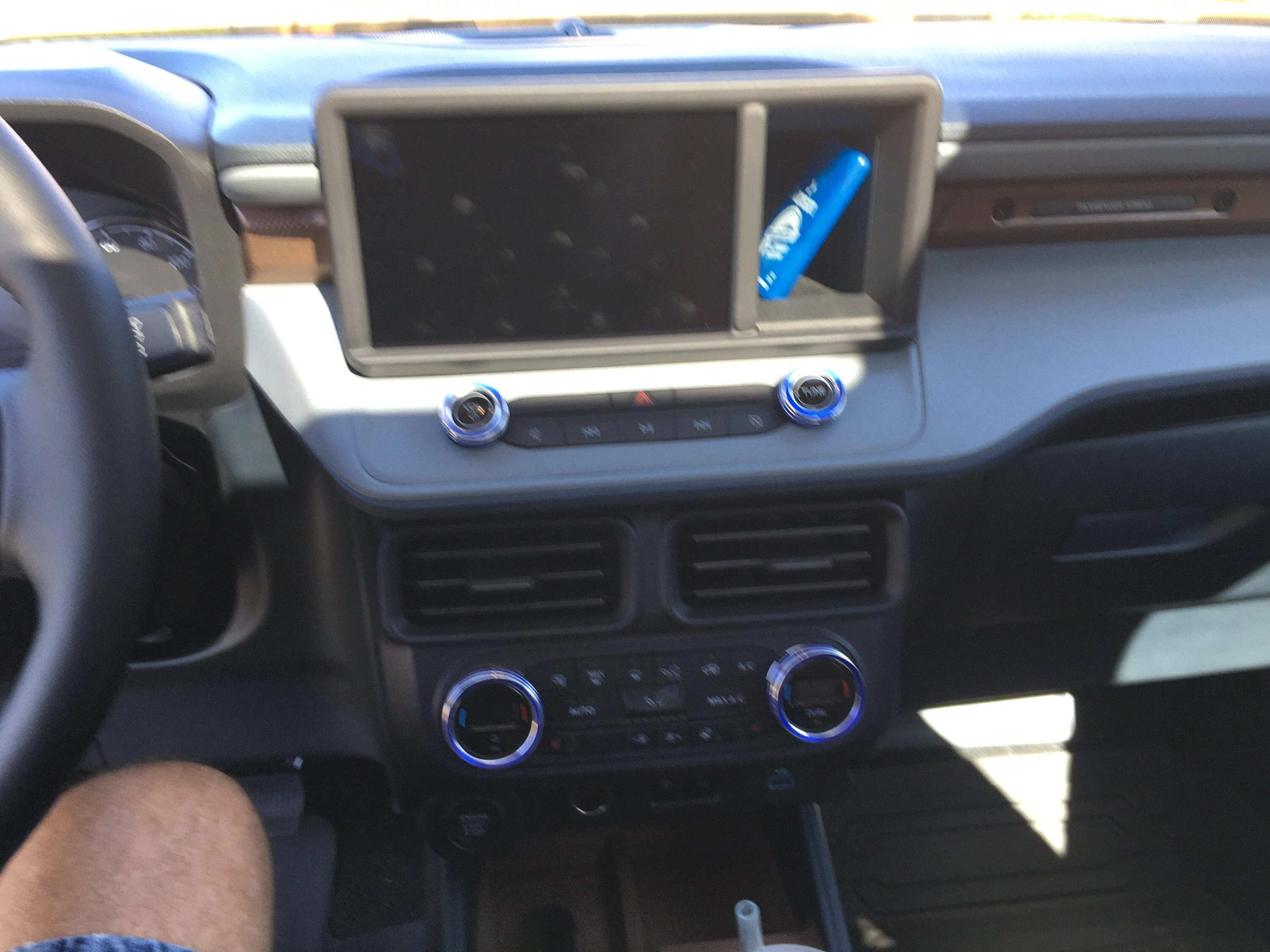

5 minute swap time…. Way easier than changing it in a Bronco Sport
The tough part will be finding a Maverick specific controller (this one has a picture of a Bronco Sport on the recirc button AND this has a general defrost button instead of purely mirrors since Mavericks didn’t get rear defroster)
I got this controller from a junkyard via eBay…. Make sure the auction has clear pictures so you don’t get a junky panel for your new truck (First one I got in had a scratched screen)
Our controller is in a piece only held on with 4 clips, just grab and pull
It is seriously the easiest swap ever

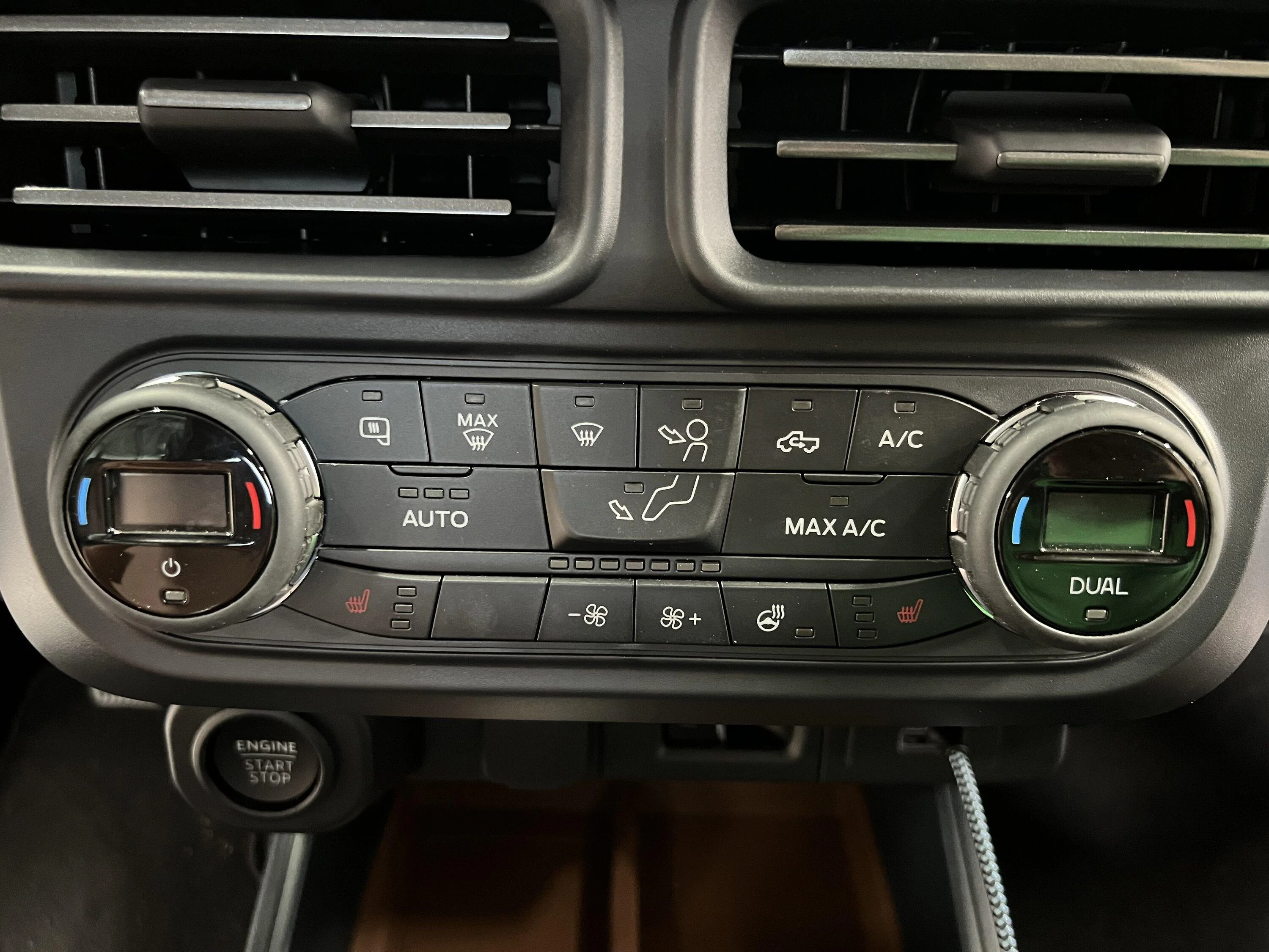

Nice job. I actually did the swap on my wifes Bronco Sport, way way harder, you have to pull half the dash off. I've pulled the HVAC controller off on my Maverick when I added Nav, I can see how it would be a very simple swap but I was lucky enough to be one of the last Maverick's to get the temp knobs.

I can confirm that it is a simple swap over of the buttons from a Bronco Sport/Escape. I swapped in the buttons to my Mav from an Escape yesterday. I also bought a unit from a Bronco Sport too but liked the Escape controls better. I have the assembly for the Bronco Sport listed for sale in the classifieds section here if anyone is interested...

It was like pulling teeth but I was able to get the dealer to pay for the Bronco HVAC unit that I swapped in. I decided to leave the Bronco button on it, doubt if anyone outside of this forum would ever notice it! Also added a set of knob rings so that they match up with the Audio knobs.
