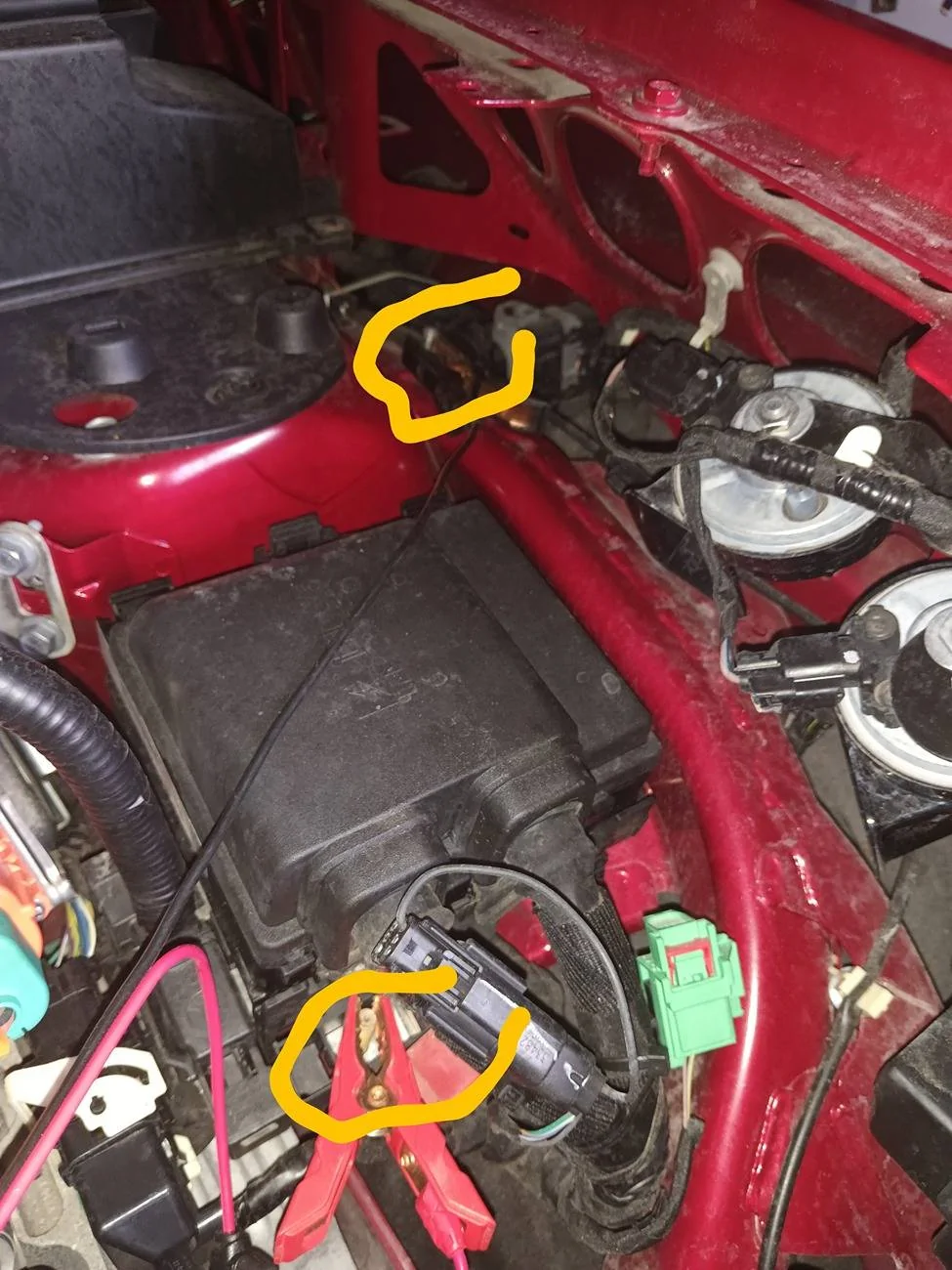

Question, I recently stored my 23 hybrid Maverick, I connected a battery tender to the red post under the hood and connected the black post to the body frame, after a month of Storage I recently opened the door to obtain some keys that I had left in the vehicle and noticed when the door opened no interior lights came on , I am aware via the app that the remote functions shut down when the vehicle isn’t driven for a while however I was unaware that everything shut off , is this normal? Does the vehicle completely shut down while in storage connected to a battery tender thanks in advance. Much appreciated.
The posts under the hood are the ones to use. Did you connect the black tender wire to the jump post or somewhere else that may not have gotten a good enough ground?
I put my noco g5 on yesterday about 10 am. Just got truck back from body shop after 5 weeks it has 3 months old BXT99RT4A MAX series battery. When started battery was at 12.0 volts so pretty low. At 24 hours the maintainer has battery at 100% and is still running optimization/sulfate routines. May take quite a while as this is first time the battery has seen the noco.
