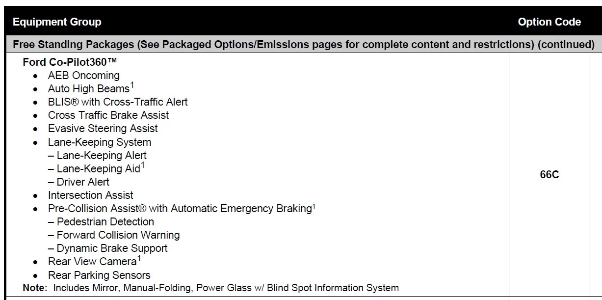

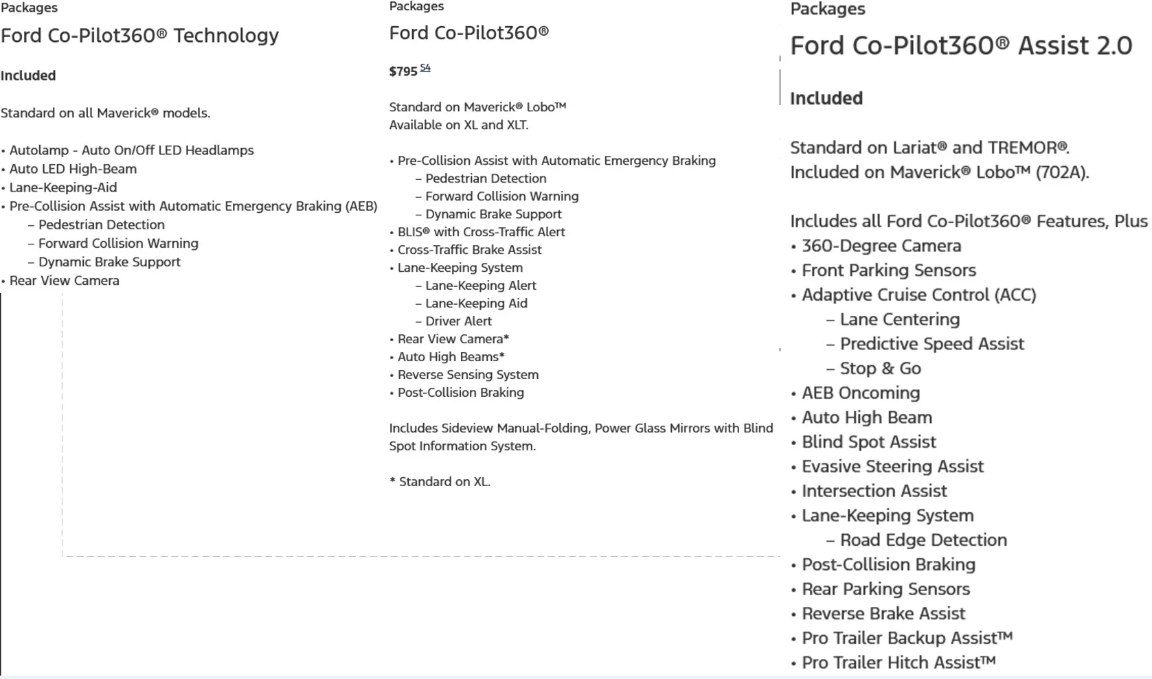

Co-Pilot 360 is hard to keep straight and has changed what's included over time.
Co-Pilot360 for 2025 Lariat/Tremor/Lobo High now has Co-Pilot 360 Assist 2.0

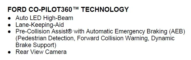

So for 2025 Maverick with just "CoPilot360 Tech" the XL has the Lane-Keeping-Aid.
Tim Bartz' video explains it is Lane Keeping without Driver Alerts or Intensity Settings.
It just does the torque steering to keep you from leaving your lane.

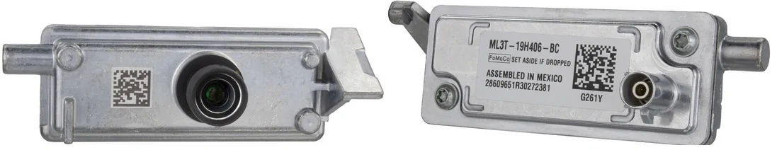

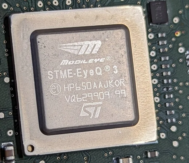

2025 Mavericks have the IPMA Lane Departure Camera still on the Front Windshield and the EyeQ3 image processing chip now within the IPMA Module located behind the rear seat.
2025 Forward Lane Departure Camera on Front Windshield
Ford Maverick Co-Pilot360 is confusing. 1755620558993-j8
Mobileye EyeQ3 Image Processing chip.

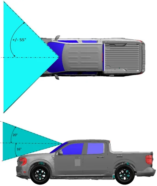

2025 Maverick Forward Lane Departure Camera Field of View
Lord have mercy
Co-Pilot 360 assist = technology
Co-Pilot 360 1.0 = Co-Pilot 360
Yeah this is nuts.
