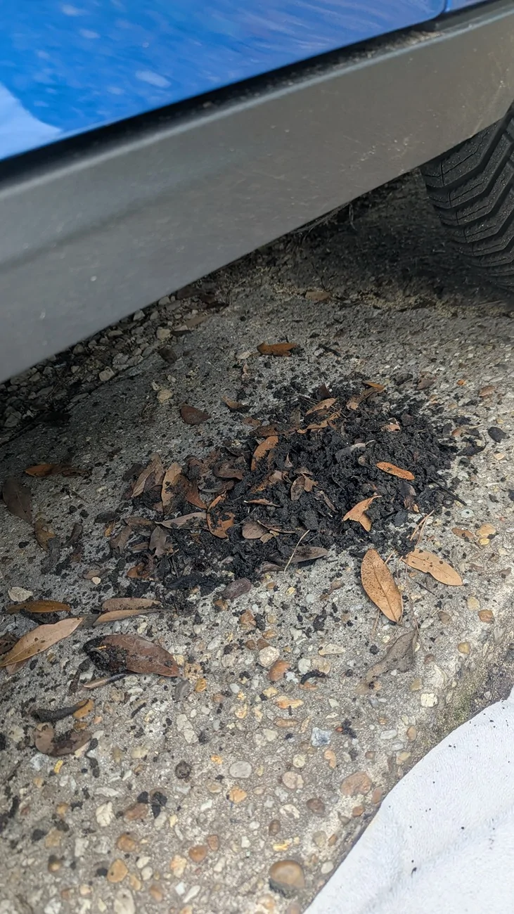

I have a 22 XL hybrid. I park it outdoors. Periodically I vacuum out leaves that fall from the windshield down the side channels and accumulate in front of the door hinges. But I noticed today that there is a small gap that extends under the plastic rocker panel.
I pulled the first three clips on the rocker panel and twisted the panel out just enough to reach into the gap. I had some pretty good compost percolating up in there. Years of leaves and sand. Mostly the forward two feet of the panel. Blew everything out with compressed air. I will be doing this occasionally from now on.
I found a guide to pulling the clips here...
Ford Maverick Cleaning under the rocker panels - how-to and results PXL_20260525_184802193
...and I will say that if you're doing it correctly it's more twisting and almost no pulling.

Front mud flaps should be effective at keeping that accumulation at a minimum.
[/QUOTE
There is a debris path from the base of the windshield all the way to the inside of the rocker panel.
If you regularly park under trees you will get leaves behind the door hinges. And some of those will migrate to the inside of the rocker panel.
I can't think of a fix because anything that would let the leaves fall out might let road salt and mud spray in.
For now I'm just treating rocker panel cleanout as an annual maintenance issue. And trying to vacuum behind the door hinges more often.

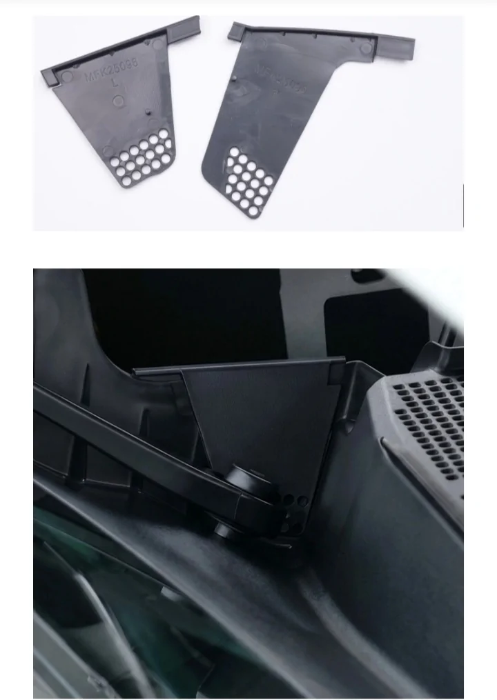

If you use mud flaps in combination with Maxzina's cowl drain barriers, you'll find very little debris finding its way into the front of the rocker.
Avoiding parking under trees and blowing out the cowl area frequently in the fall also helps.

Just that i notice more junk making its way from the "A" pillar side/ windshield due to poor design, than anything flung from the wheel wells. (it's a funnel shape with the tapered part seald off lol) The reason i noticed the amount of debris that made it that way in the first place, was when i installed the aftermarket mudflaps!
That made me realize more junk made its way from the cowl area than that from the wheel wells!

Yeah, I recommend those Maxzina (or Mabett) inserts for the cowl. They're not perfect, but they do stop most of the leaves from getting in there. Anyone that doesn't have the ability to park indoors and can't avoid parking under trees should definitely consider cleaning out that area on a regular basis, and hopefully that will reduce the need to pull the rockers apart.:
https://www.amazon.com/dp/B0FDF61NS6
