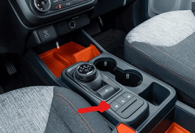

drive mode is a button in the lower center console, rearward of the gear shift knob.
push it repeatedly. fx4 and tremor models do not have sport or eco modes, they have mud/ruts and sand modes instead. you can turn on all modes regardless of trim/option level with Forscan.
the next time you start the truck it'll go back to normal drive mode.

the drive mode button is between the center armrest and the shift dial. here's a pic I quickly found, this is a hybrid because you can see the funky slot for parking lot tickets, or whatever. an ecoboost maverick has a different button layout, however, the pic is useful because drive mode is still this upper left button that I marked with a red arrow.
push it and look at the driver's instrument cluster to change the drive modes.
