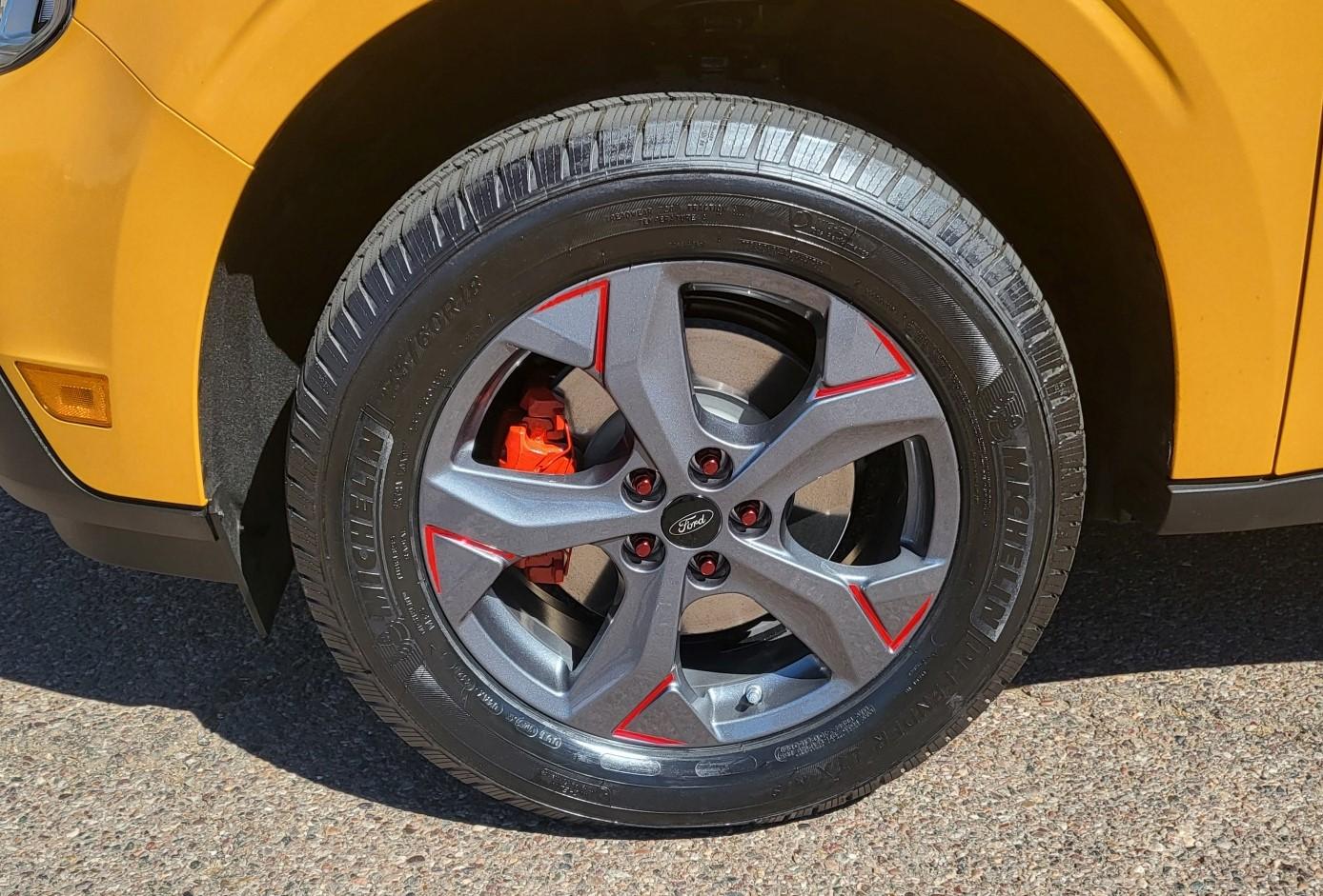

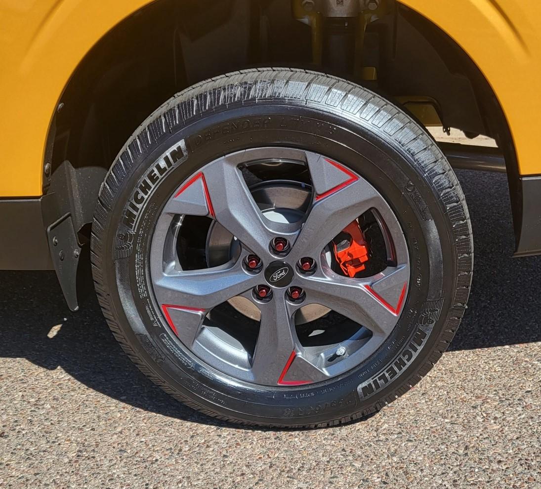

I just put 10H Ceramic/Graphene coating on my Mach-E wheels to protect the finish and give it a super glossy shine. Very Happy with the results and the added protection. The red pin striping went on after the Coating.
Ford Maverick Ceramic Coating for the FX/4 wheels. 20230915_142350_resized
Ford Maverick Ceramic Coating for the FX/4 wheels. 20230915_142342_resized_1

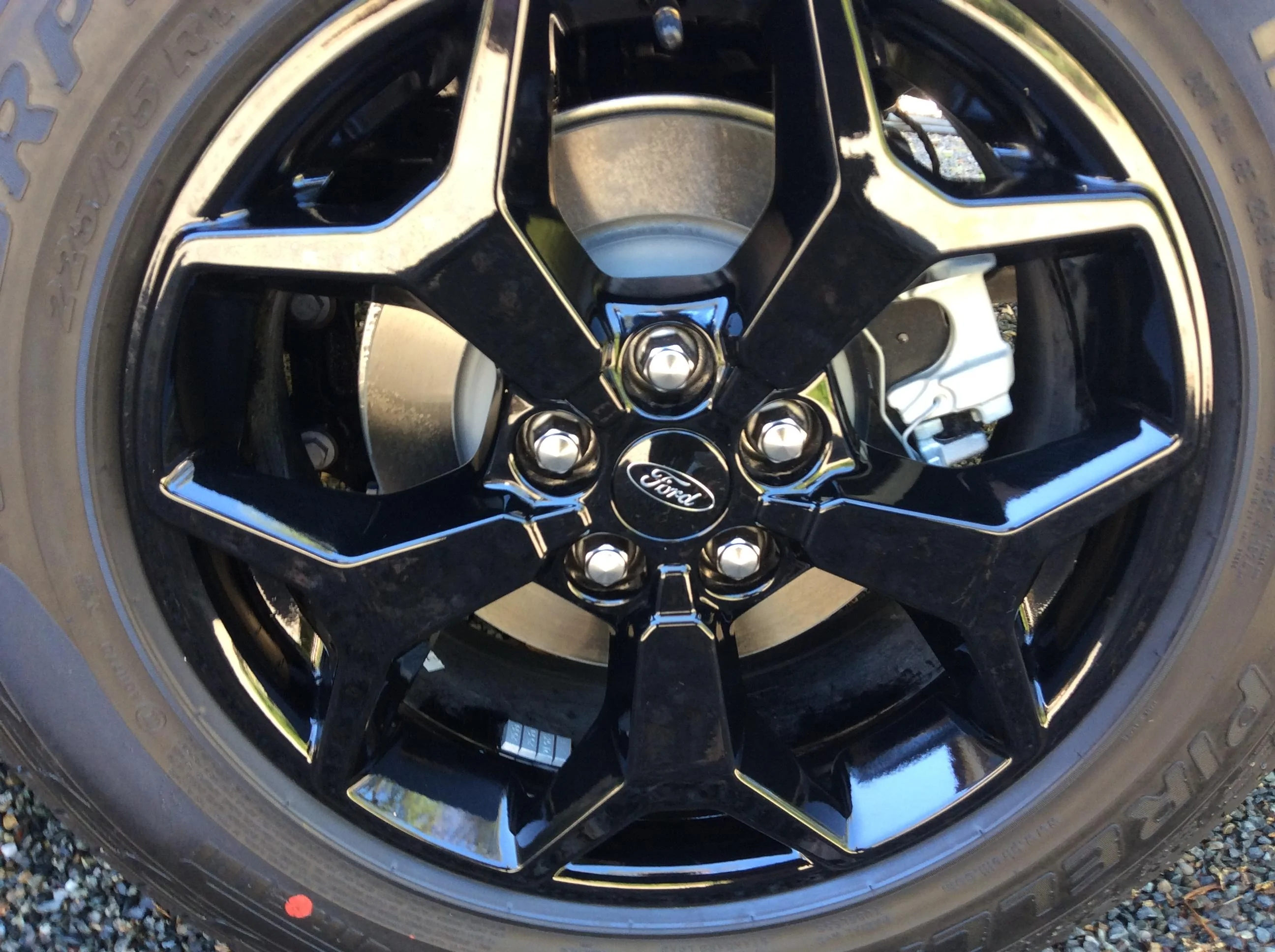

I clean them with a small piece of clay bar (then throw it away), and use the turtle wax siO2 w/graphene. Buff with a cheap microfiber and toss it too. Very happy with the results. This is my first set of black wheels. Yes I agree they are soft and scratch easily.
Ford Maverick Ceramic Coating for the FX/4 wheels. FFDF82B4-EA88-43A7-82CA-0DE2E5626722
Looks good. Couple suggestions: I like to do the barrels on wheels like those that you can see them. Makes a nice difference that sets them apart and makes them look super clean. I also like to paint my stick on weights on black wheels. Mask with blue tape and a quick brush with some black Rust-Oleum and they disappear. A few minutes of work when you have the wheels off that also makes a nice difference.
