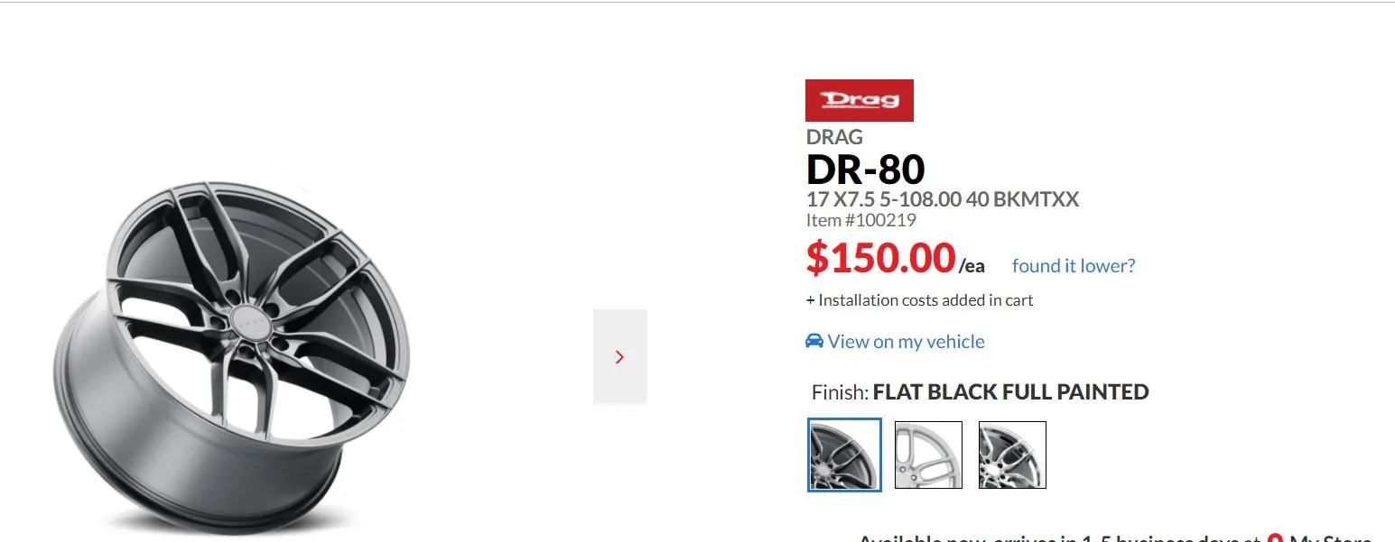

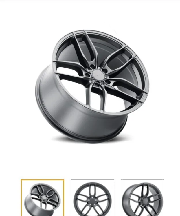

Had saved a little for some replacement wheels for the Maverick, and found one I liked. I checked out the specs and have them on order. Should be in next week. The only thing, the wheels weight rating is 1725. A little low maybe? It is a Bronco Sport wheel from Discount Tire.
The rear GAWR is 2770 so each wheel is taking 1385 lbs max, which is 340 lbs below the wheels max rating. Chances are I'm not going to load up the bed, I have a utility trailer, and won't be going off roading.
I'm thinking as long as I don't get aggressive on speed bumps, or go road racing, I will be just fine. Anyone have any thoughts?
