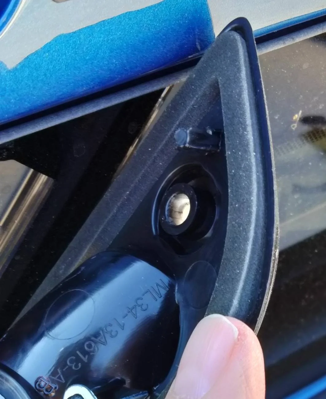

I just replaced the bulb in my Mav's center brake light and found that when the light unit was securely attached to the cab there was still a gap between the plastic seal and the cab body.
The gap along the top part of the light fixture is somewhere between 1/16" to 1/8", depending on the location.
The problem, as I see it, is the gasket that seals the light housing against the cab's body is hard plastic, with zero flexibility. For a proper seal shouldn't it be a flexible rubber compound?
I plan on using a maritime silicone sealant to completely seal the light fixture.

There are plastic alignment pins that have to be seated properly, are yours seated? Initially I did seat only one side properly, started tightening and heard plastic cracking, that’s when I noticed and re-seated. It should seal pretty well from the factory.

Don't put any Marine sealer on it there is a seal that you can't see when the housing is in place.

My gap is comparable to Jim Baker's.
My pins are in place and I've tightened the screws as much as I dared, knowing how fragile those plastic parts that the screws attach to are.

There is supposed to be a soft rubber gasket behind that compresses as you tighten. Does yours not have that gasket? It's normal to see a little gap, you don't want the hard plastic against the paint, but there should be a gasket just inside.
You're right-I used a light to take a close look. Thanks.

My Sincere Apologies to all on my part for the major overreaction. 🫨🤯
Thank You to A.Bursell for steering me straight. 🤝
Thank you for the info.
Yep and here it is.

I checked my truck. Yes, see a gap at top. But as another said should have gap, top not touch the paint. Hence, I’m will let it slide… predict good gasket contact to keep water out.
Hope others agree?

Yes, the actual area underneath the third brake light housing was very clean. Meaning the seal is keeping dirt and water out. 👍
