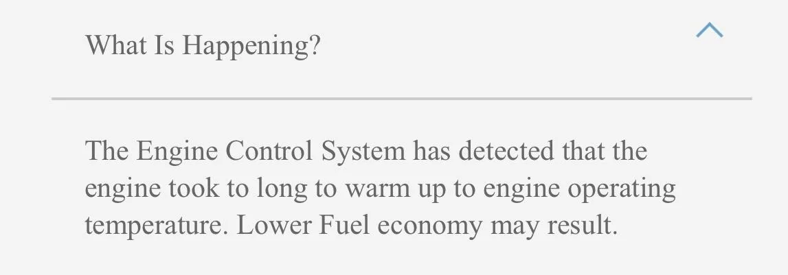

So after driving about two hours in 18° temperature the CEL (check engine light) come on driving over the Delaware Memorial Bridge. Pull over as soon it was safe, checked the ford app, it readed
Ford Maverick CEL after 1289 miles - The Engine Control System has detected that the engine took too long to warm up 1644846886151
Ford Maverick CEL after 1289 miles - The Engine Control System has detected that the engine took too long to warm up 1644847668773
Ford Maverick CEL after 1289 miles - The Engine Control System has detected that the engine took too long to warm up 1644847915373
lucky me, there was a Ford dealer 6 minutes away. been here for about an hour they diagnose it to be a bad thermostat, but unfortunately they don’t have any, They have to get them one from another dealer two hours away. Really screwing up my trip to Southern Shores , North Carolina.
