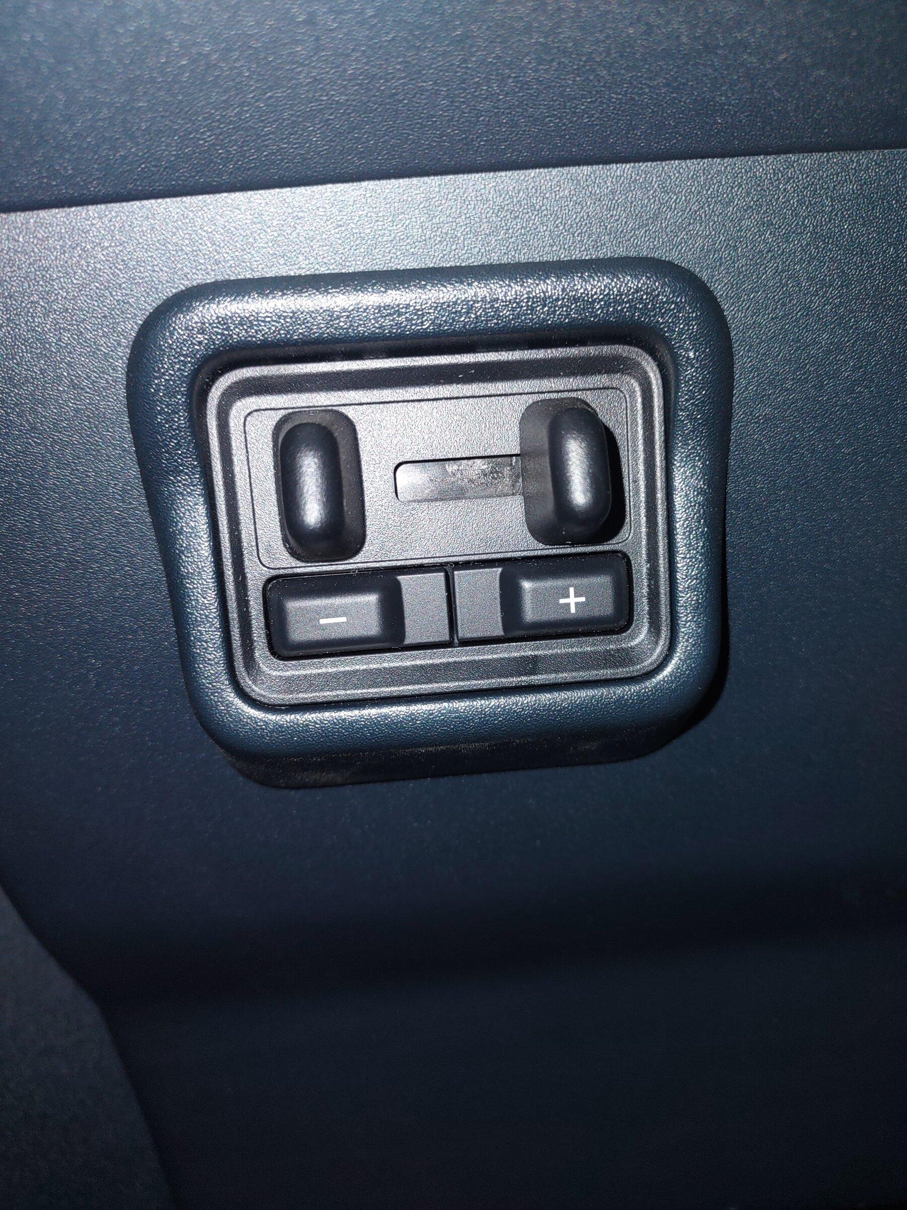

Can someone tell me what this is for?

That is your trailer brake controller. It's in the manual.

Right? How are you supposed to work those? Squeeze em when slowing down?
The slide bar is used to manually test the trailer brakes for adjusting, the -/+ adjust how much power the brakes are given. The trailer brakes, if installed on your trailer, should be automatically activated when you press on the Mavericks brake pedal.

Hopefully with some safe trafficked roads start far right and keep inching left til the tow no longer pushes the truck when you apply brakes. Then leave it there til you sale your truck..
