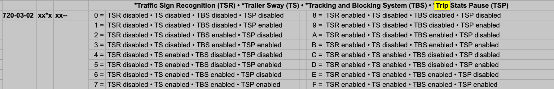

Hey I found the answer. Try
IPC AS BUILT
720-10-02
0800 407A
This is how your coding should look. Tell me if that works! It should bring up the hybrid trip summary you get after every drive.
